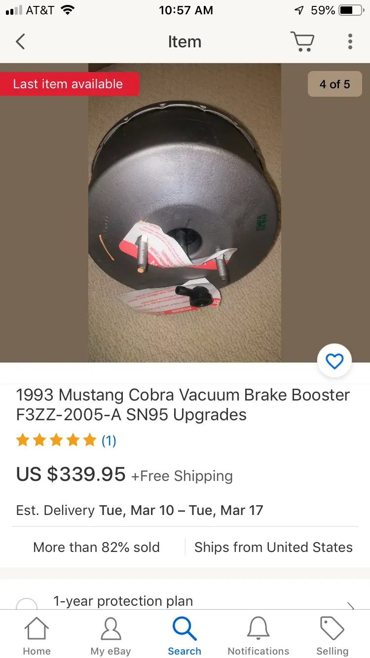

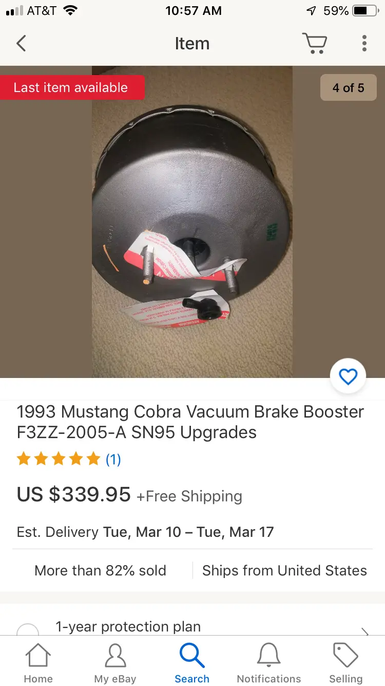

Yea that is why I was looking into them because I am planning on upgrading but if you find a 93 cobra brake booster on ebay or lmr they are double that price. There is one on ebay right now as we speak for 339.95$. Is the one at the parts house the correct booster that I will need to do the upgrade or are they just selling the booster I have now as a cobra booster as well?

$330 for that booster is a joke. I have one on my shelf. It’s a reman. Pretty sure Cardone did it

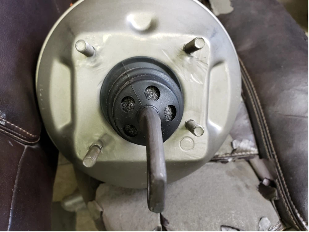

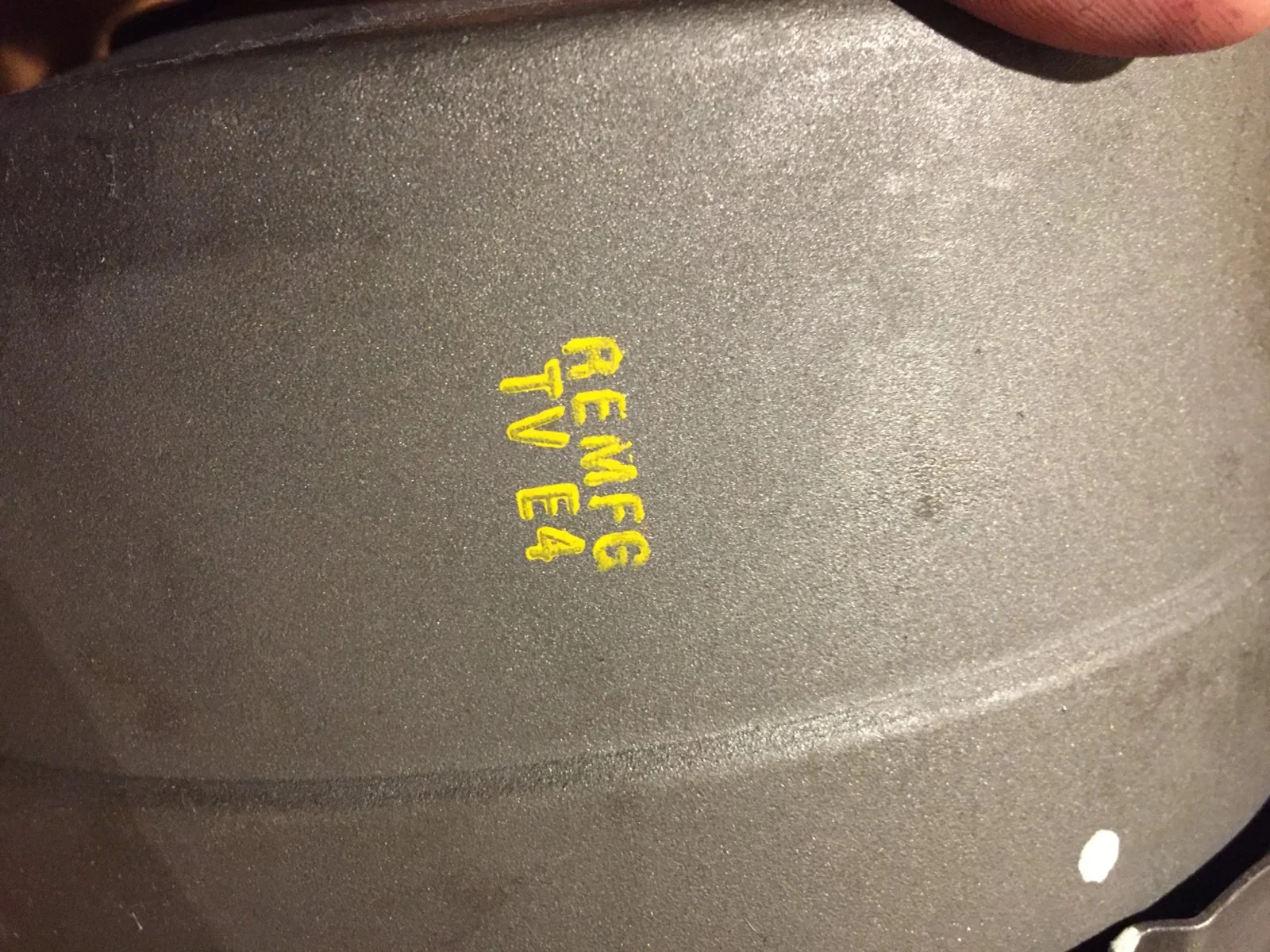

The $340 on on eBay is a reman. Look for the small green label on the side of it. I have the same booster, here’s what it says
Here’s mine

Looks like the LMR unit has the same stamp, so more evidence these are all made by one supplier.

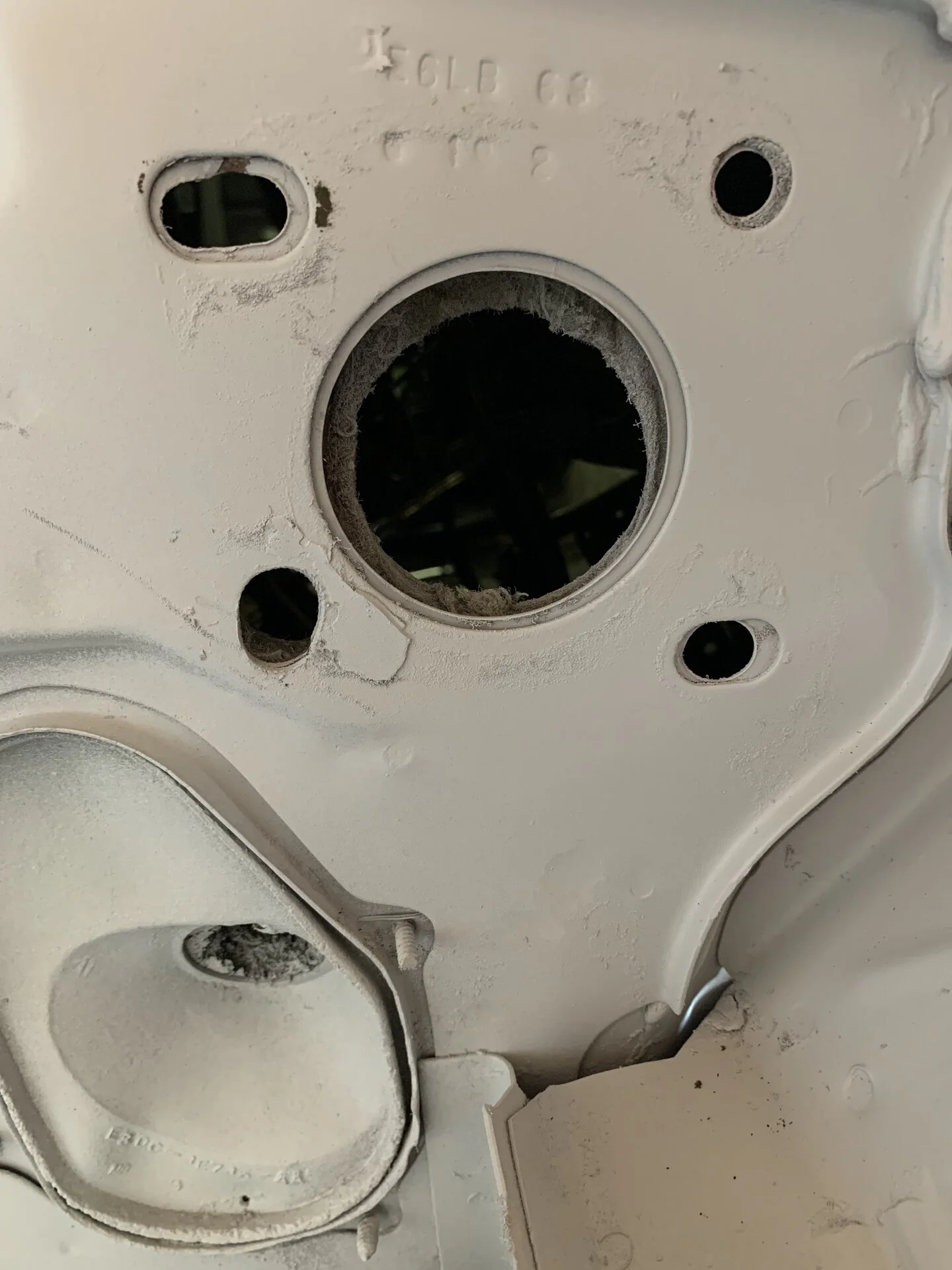

Next option is a 94-95 booster. Same thing, but the difference is the studs are metric (so you need new nuts) and one stud is slightly offset, so you will need to slot the hole int he firewall for it.

The Cobra one is nice because you don't need to redill for that one offset lug. Make a template with cardboard and trace it on the firewall and you'll see the difference.

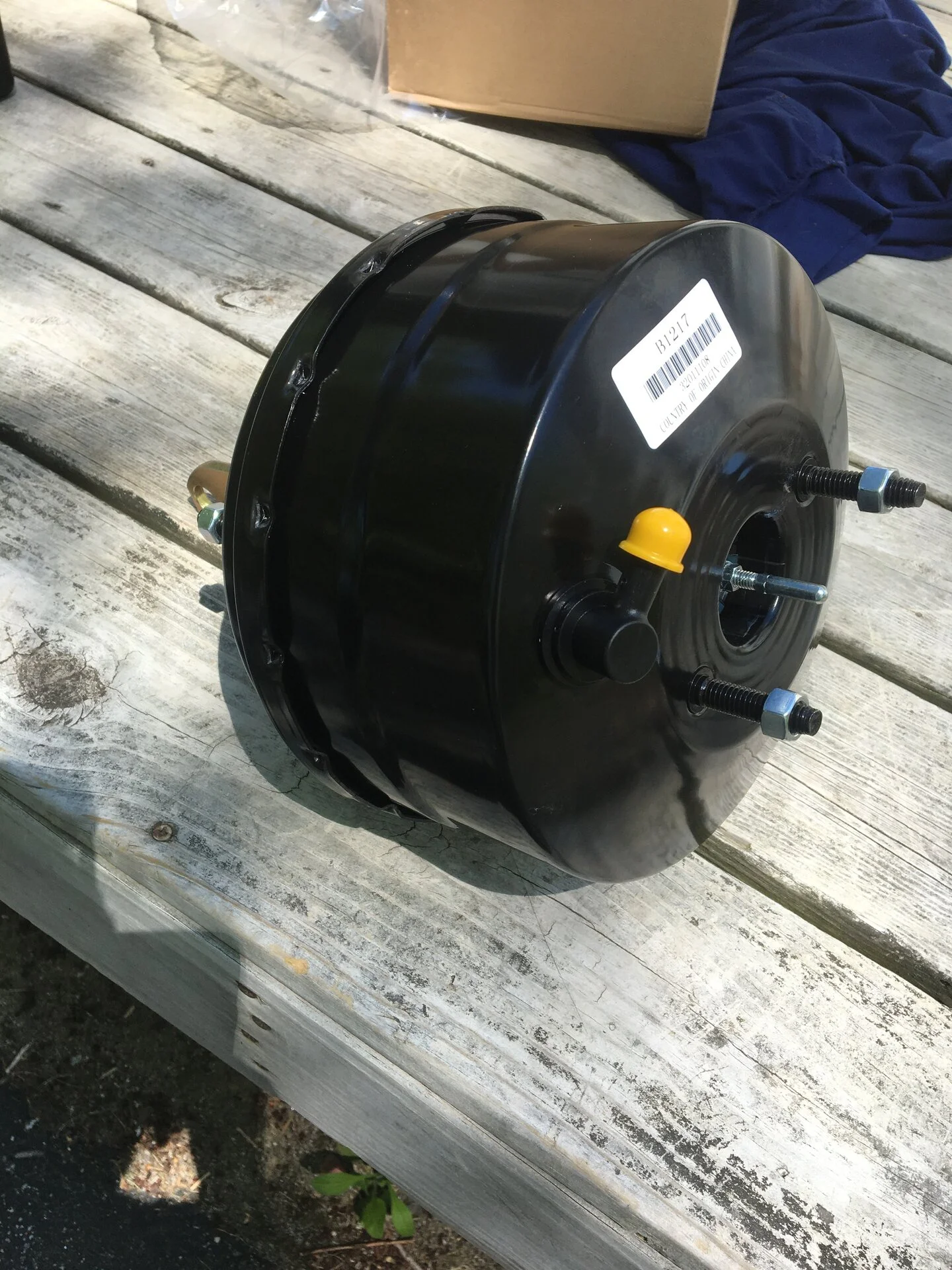

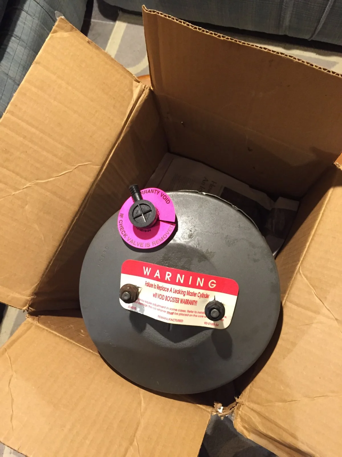

Just went through the brake upgrade with rear disc and had to find a booster. Advanced auto could not get one, had to send one in for rebuild. Oreilly could get one and when it showed up:
The rebuilders are taking '94-'95 boosters and changing the pattern to work with the Fox. Didn't matter to me as long as it worked. They do seem to fit fine.

here is a picture of the amount you will need to in large the hole for the sn booster. I wanna say its about the same amount of hole diameter down to make it fit. I have also seen guy's just cut this stud off and only run 3 studs...:shrug:
