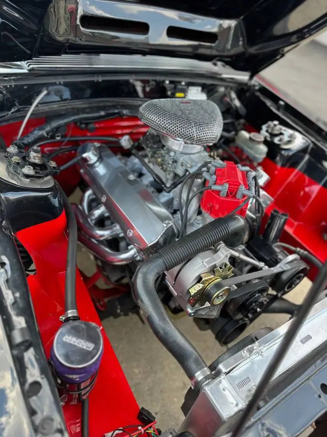

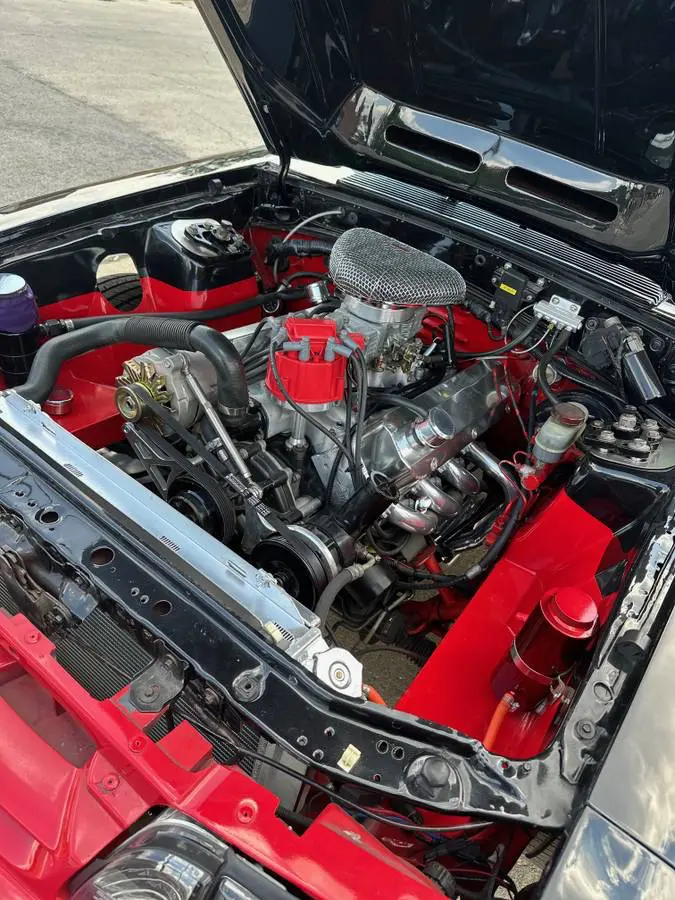

Just acquired a 1991 foxbody Mustang, built 302 motor carbureted, battery in the trunk. Car died, battery in the trunk swelling and smoking, large white cloud of smoke came through cd player console as car died. What could be the issue. Car will not start and no power now. Fried harness?
Don’t know much about this car, any insight on the build is appreciated as well

) but like you, I'm definitely no electric guru. I'll go ahead and throw a guess in, though - maybe the PO didn't wire the regulator correctly, or maybe it's just bad? It sounds like it was overcharging by quite a bit to cause all of your issues, so it makes the most logical sense in my mind. I'd also suggest chasing wires to see if there's not a blown fuse or fusible link that's causing you to have no power now, given the assumption you've tried a different battery, or otherwise tried to run a different power source. But I'd say what I tend to say when something like this happens to me - prepare for the worst and hope for the best! Meaning, you may get away with just a regulator, but prepare yourself to replace the whole electrical system (alternator, regulator, fuses, etc) as well as a new head unit at least. I'd suspect that it had a fuse linked to it, so it should be ok, but prepare yourself to have to replace it anyway. That's just my 2 cents, if it's even worth that....

Thanks for the info. I will be a frequent poster here as I learn through the process taking care of this hot rod… to your knowledge. Do you think I fried the dash harness? I’m not sure how to check the extent of the damage

Look at, even take off if you can, the positive cable back to the battery.. Give it a good inspection..... I would look for a dead short... :Possible rub through on the insulation..
