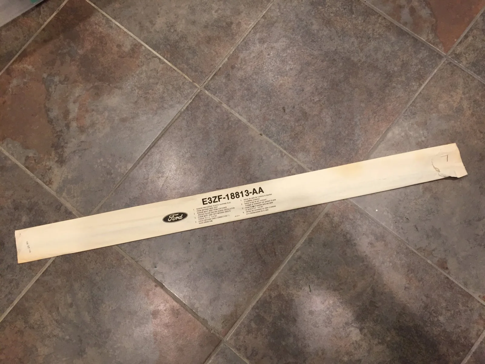

I have a photo of a '93 Cobra that was never dealer prepped and had the antenna in factory packaging in the trunk. The antenna's are still available NOS for fairly cheap. I bought one. Give me a min and i'll get you a PN

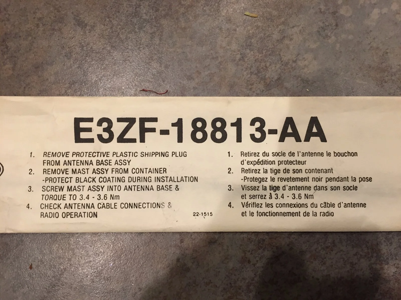

Here ya go E3ZF-18813-AA They pop up on ebay for reasonable prices.
But this was present in the hatch of an unprepped low mileage cobra.
