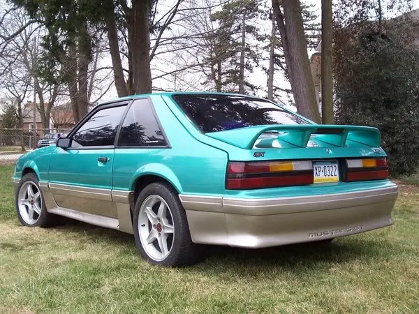

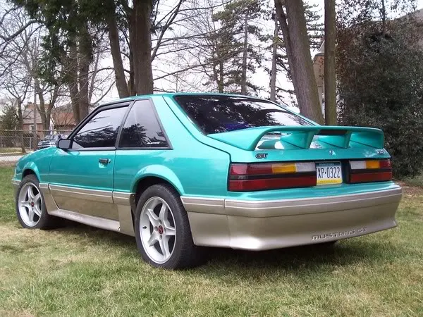

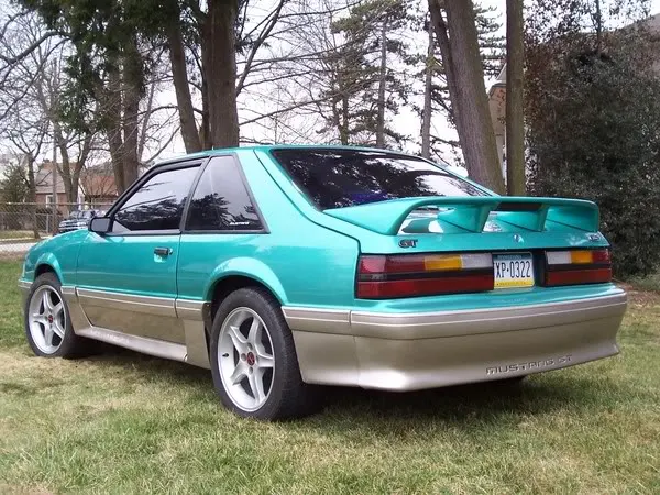

Or save yourself alot of money and go to a junkyard and pull some off of a 86 stang then put pinstriping on them like the cobra tails. Lots of people do this and it looks exactly the same but if you have extra cash its always easier to just buy them premade :)
I made mine. Got some 84-86 lights and painted the trim and painted some stripes. I didn't use the same dark color for the stripes as the 93 though. Also, on the original, the middle stripe on the lower section of the lights doesn't wrap all the way around. I haven't heard good things about the reproduction cobra lenses.

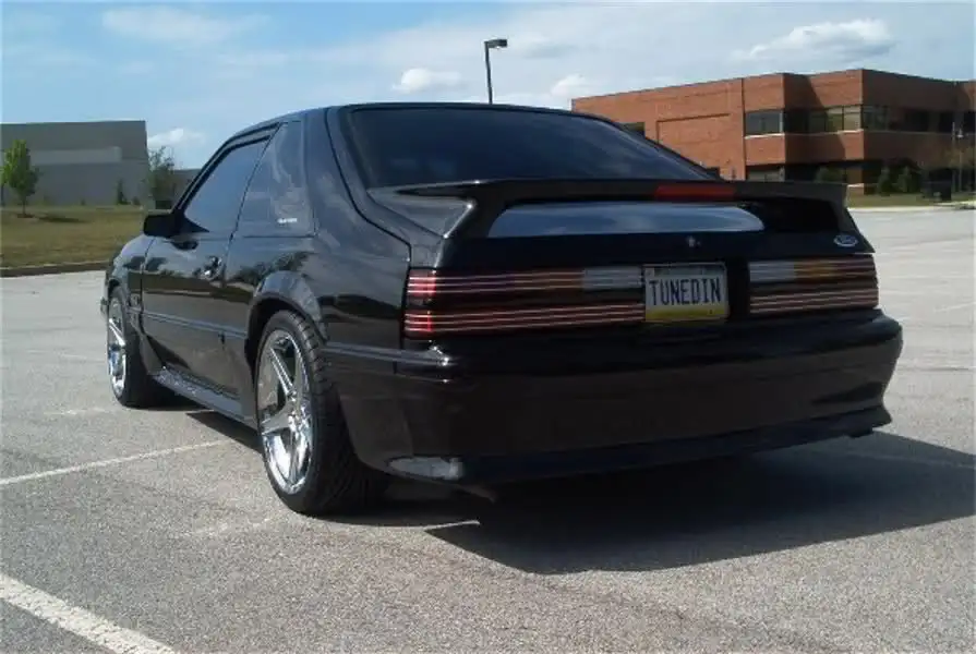

i got mine from blue oval industries off of ebay, and like said above the stripes are not painted, but my local junkyard had no good 86 lenses, and they wanted to charge a decent chunk for them also, so i just figured i'd spend the extra money and get a new set off of ebay. 160 shipped. not cheap but they look damn good.
I striped my own, too. I didn't like the striping on the originals, as they weren't a flat, solid color.
I got 85-86 GT lenses, shined them up, and put pinstriping on.

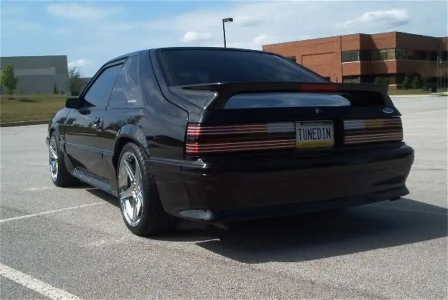

You can see the lower stripe and how it is shorter. Also you can see how the lines are looking silver. The originals tended to do that with light hitting them, but would otherwise look gray/dull black. That's what I didn't like about the originals personally, I wanted a solid black stripe color. And I found this pic of my own:
