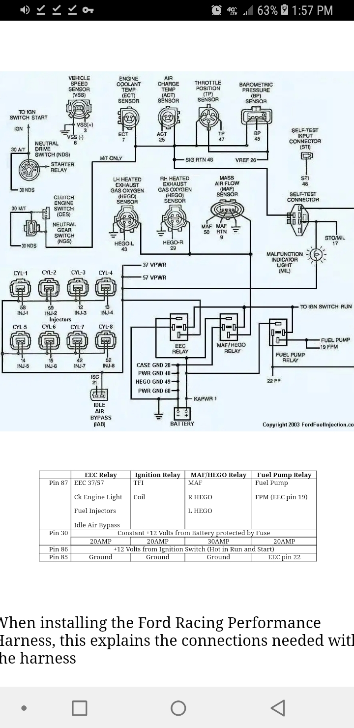

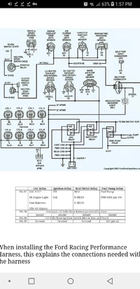

Yea ive run trough all of this already, needs a ecu im pretty sure. Just wondering if anyone has had similar symtoms with test light staying illuminated while in test mode but the cluster cel not. I know the bulb is good and it does light in start position. Or actuators and relays clicking like it is going into self test but not flashing just staying lit. Is it possible to have 4cyl auto dash harness incompatibility with the rest of the harness? Seems like eeciv dlc cel circuit isnt connected with the dash cel. Because they have diffrent behaviors. Shouldnt a test light and cel do the same thing while attempting self test.I need a diagram of the cluster and dash harness to chase down check engine light circuit, one i have seems lacking.

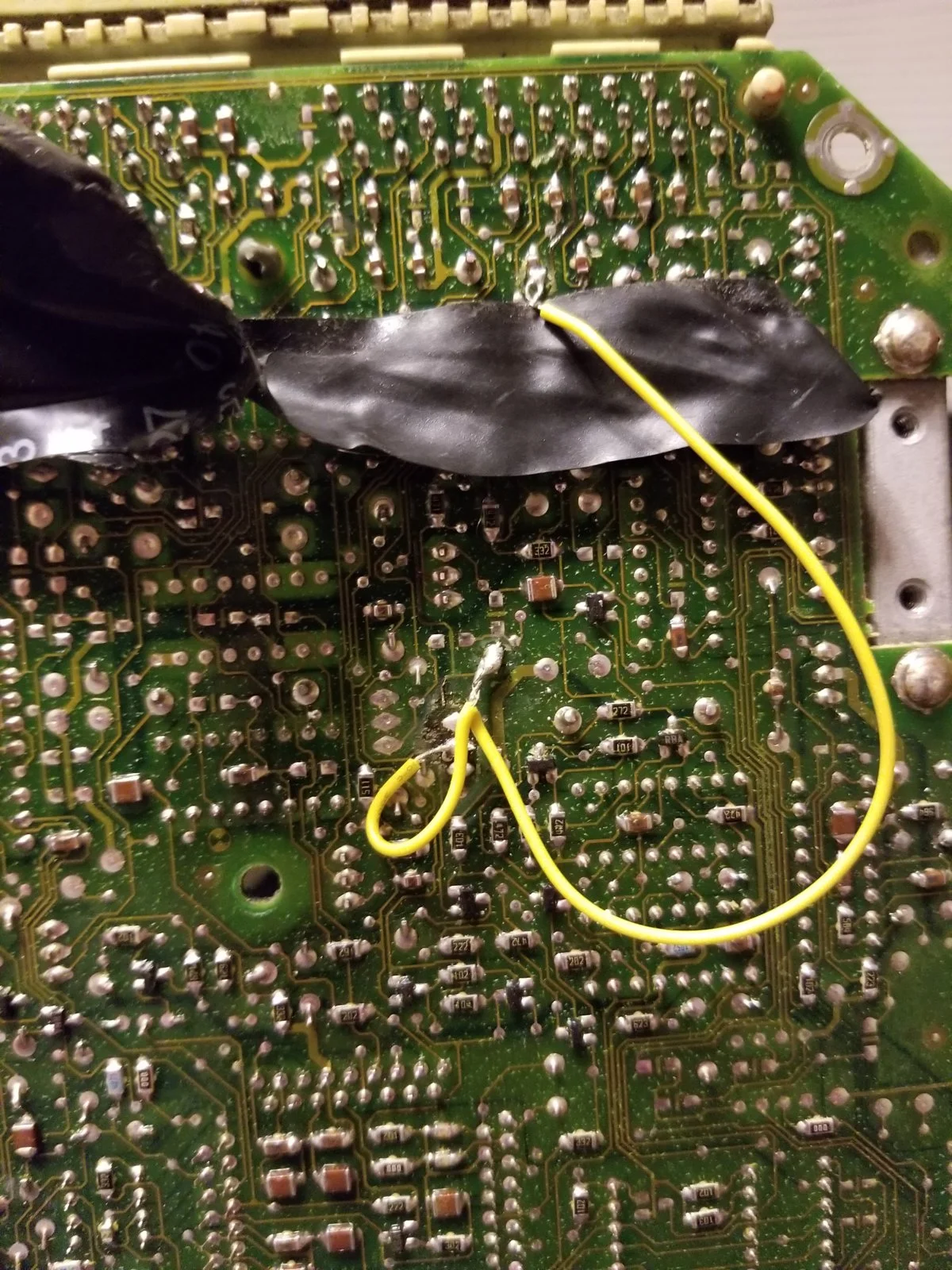

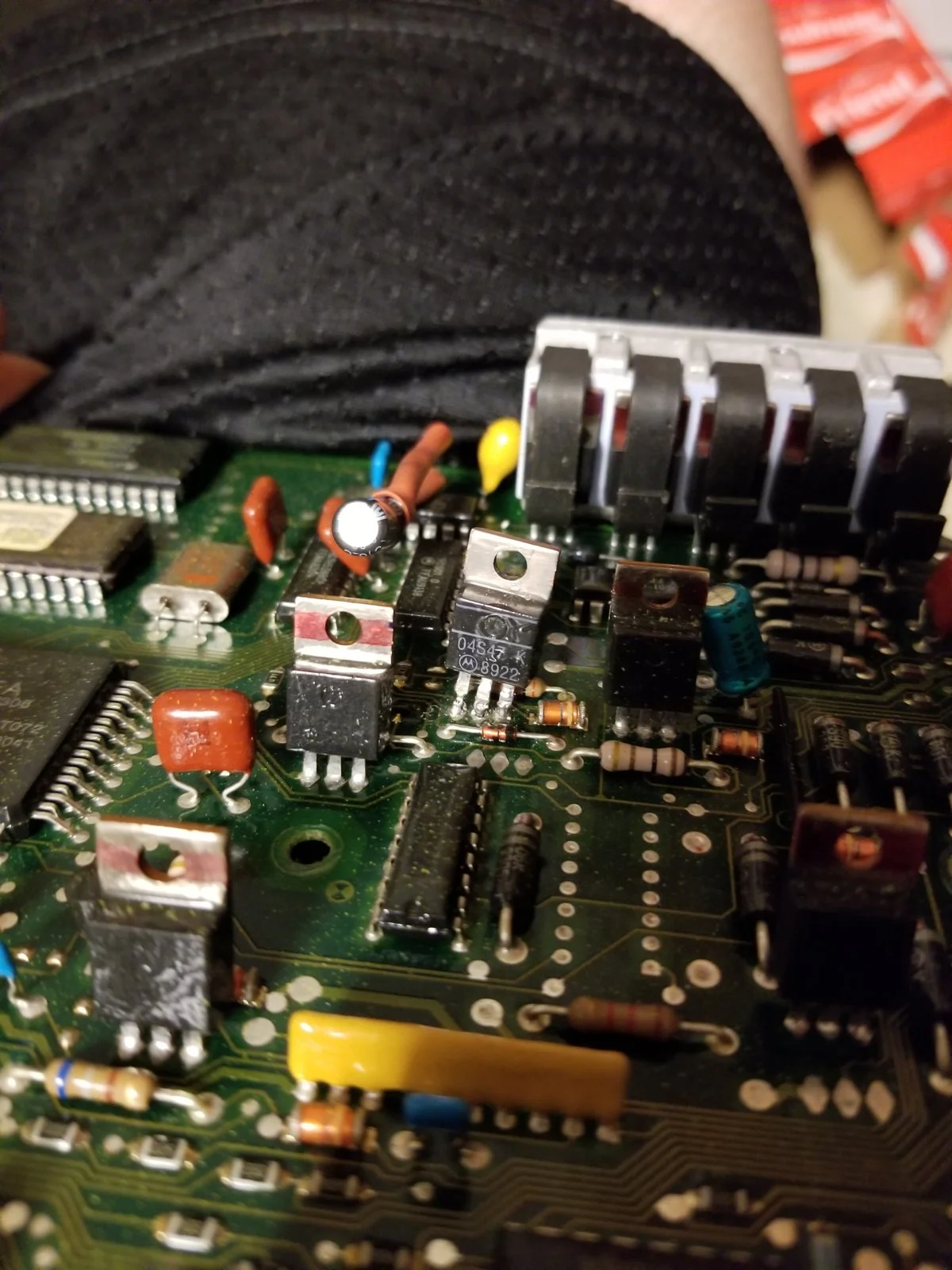

No the o2 harness is correct for 93 t5 trace was prob fried before i got it. they grounded sgn rtrn at the eec test connector and it ran ok i saw the jumper and started to investigate found correct o2 harness and no start voltage at 46 harness side so i repaired the trace and removed ground jumper and it ran better but no cel flash so thats when i found out about pin 17 transistor issue. I appreciate the help does anyone here have a lot of knowledge about pcb repair on the a9l/a3m?
Update:
Fixed it was a fried pin 17 trace and pin 17 transistor. Used jumpers to fix traces and harvested the transistor form a 302 1990 ford bronco ecu. Not the prettiest but it works im going to clean it up and install it. Check engine light now flashes codes. Transistor was a PNP
