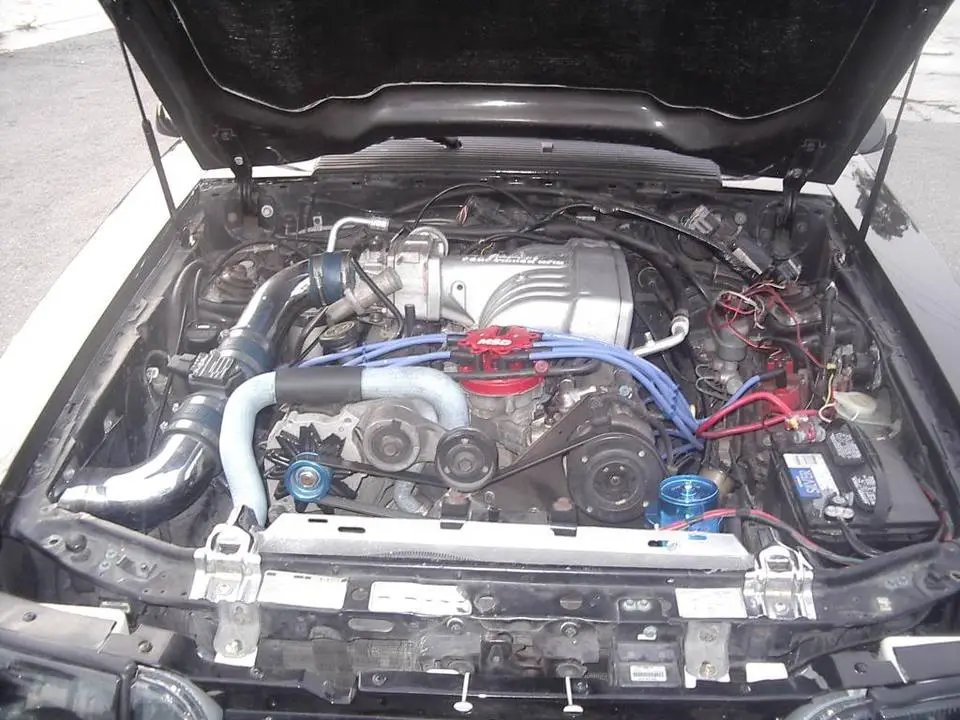

You say you assume it's a 3 row, just so you know, 3 rows is pretty thick so you should be able to see the difference, the original is only like an inch or so thick, so the 3 should look stuffed in there.
I'd rule out the water pump, most of the time they either work, or don't work and leak, not too much inbetween.
If the thermostat is stock original almost for sure it's time for a new one.
Riding around town and stuff it never gets over 195*. What things would you guys recommend to try? I would say the radiator is 2" thick. Here's a pic where you can kinda see it.
