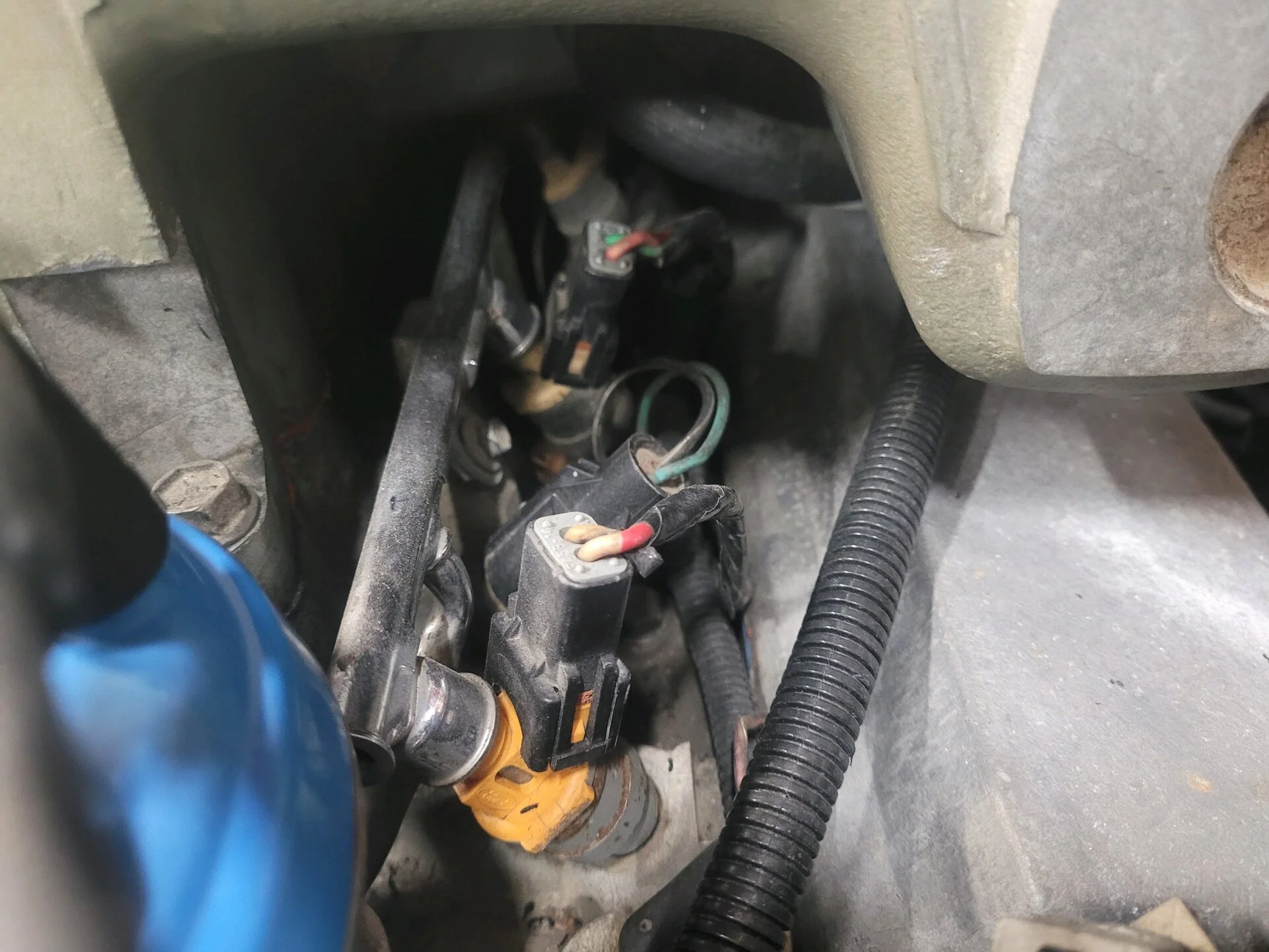

Back to working on the 93 LX 5.0. A9L ECU came back from ECU Exchange with a # of fixes. The car now starts - that's a plus.
However, now to figure out the seriously rough ide. Assume almost all sensors are original from 1993. At cold start it idles up to 2k to 2,500 RPM and then will drop down and want to die, but I can keep it running with a little throttle. When it warms up it runs a little better, but still very much way off. The ignition timing isn't too far off spec. EGR system is completely unhooked for now (it's missing most of the equipment to make it function). I installed a new IAC.
KOEO - codes 31, 81, 82 and 85 - I think most of these are smog related.
KOER - codes 13, 21, 31, 41 and 91.
I'm "planning" to get a new Motorcraft ECT sensor and O2 sensors.
I have a 70 MM MAF from a 94 Mustang (in what appears to be good condition) I was going to use when upgrading the intake. It's hard to keep the car running and unless I get a helper, I can't check the MAF with it running. Rather than buy a MAF for the stock 5.0, will it help or hurt to try the 70MM MAF? I wanted to get the car running decent before doing the intake related upgrades.
Also wonder if there is an injector issue - see the picture with the one different color injector - so someone has changed out at least one injector.
I know this is a mess -- where is the best place to trouble shoot first? Yes, I have reviewed a number of posts and am getting dizzy reading!! Thanks for suggestions.

I see 19 lb injectors, anything else is a mystery, have you gone through the 'surging idle checklist '?

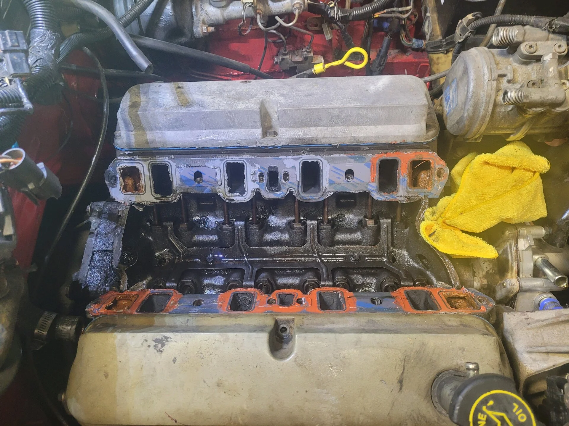

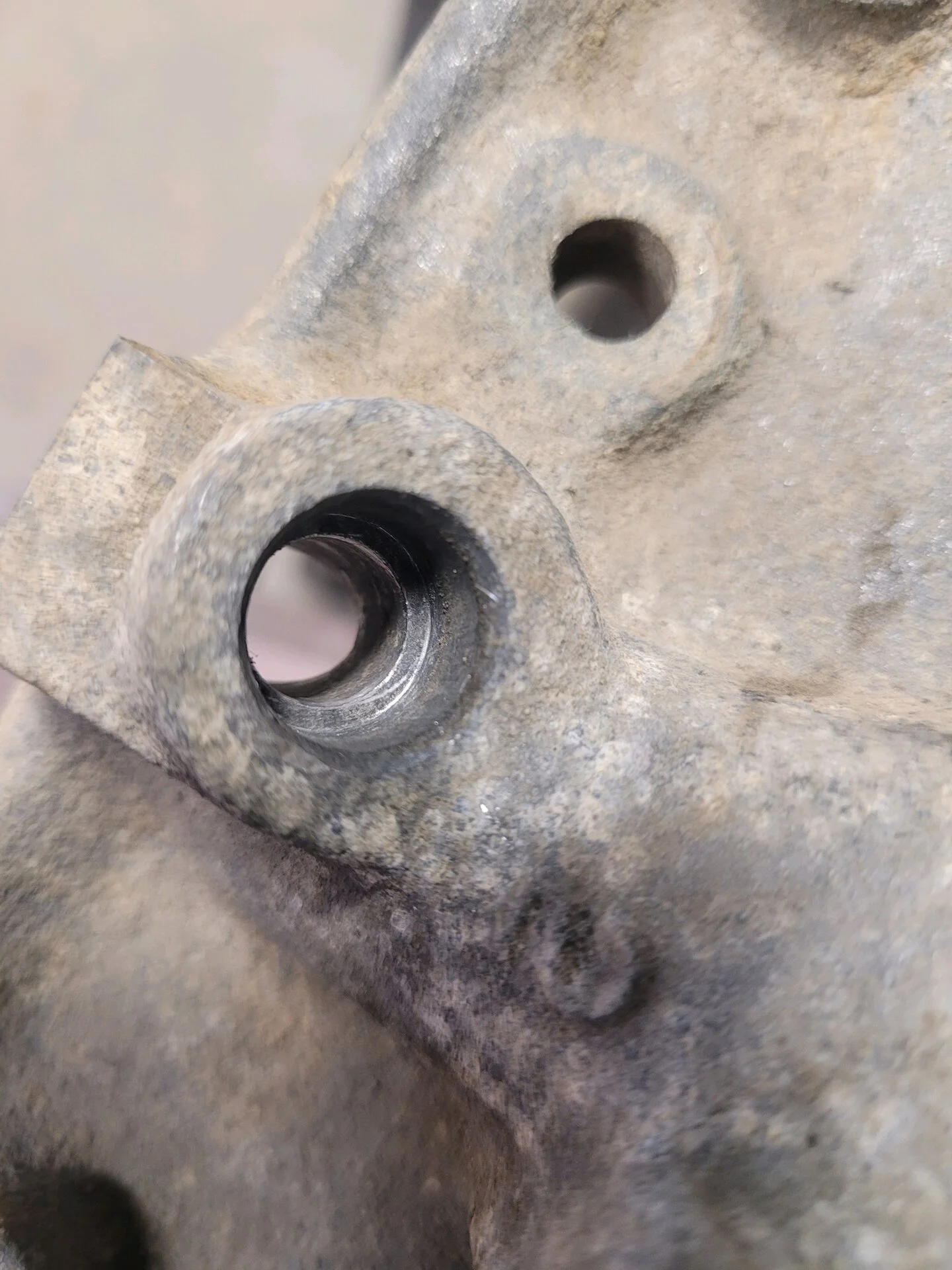

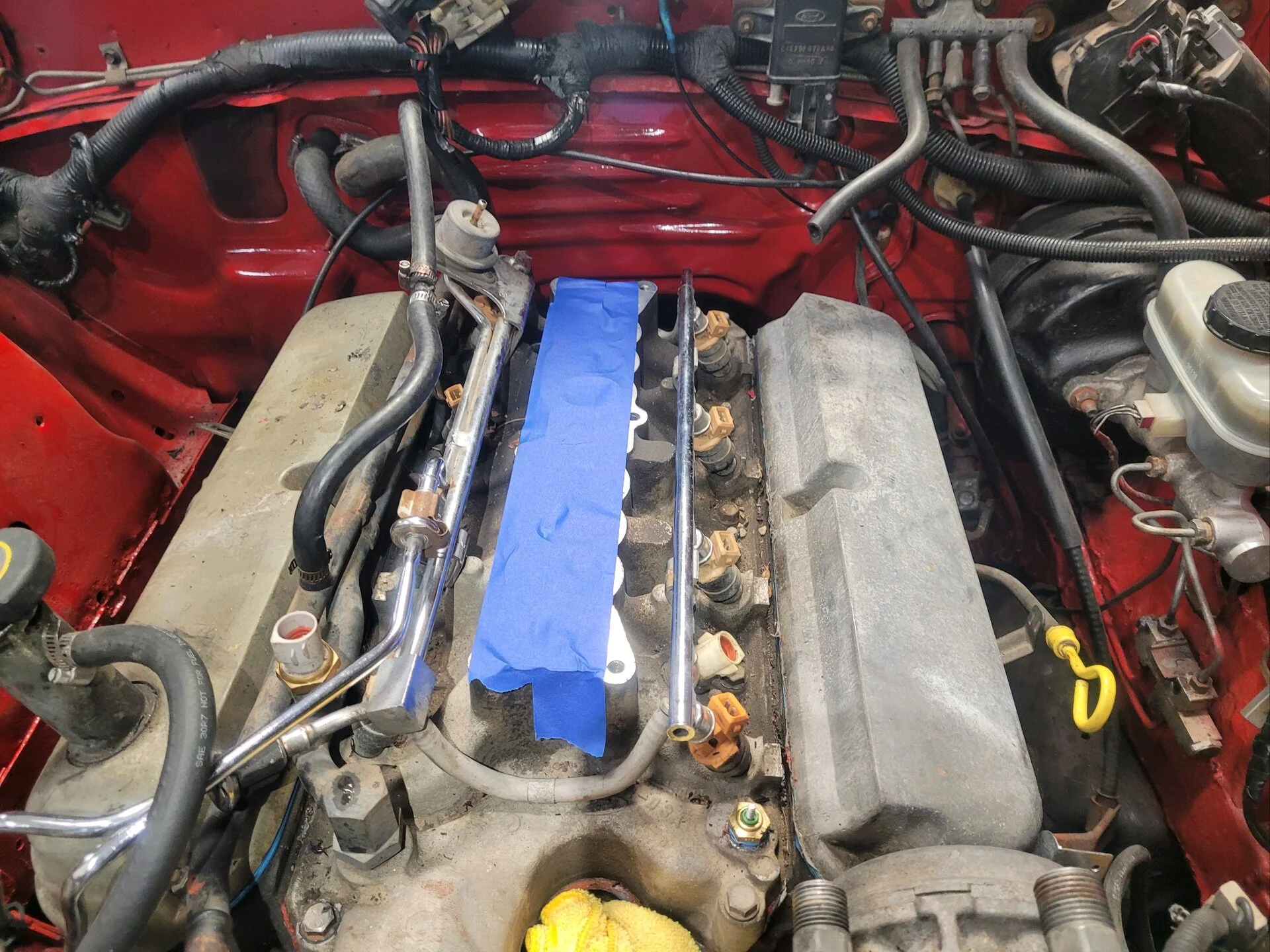

General -- I attached a couple of pics and a more thorough update for your entertainment!
Intake -- I'll keep you posted on the swap. I think I have the parts, but need to clean everything up and get to work.
T5 -- I pulled the T5 transmission. It wasn't shifting the best and the oil pan needed to be removed and I really didn't want to pull the engine so I removed the tranny and then lifted the engine up high enough to remove the pan with the engine in the car.

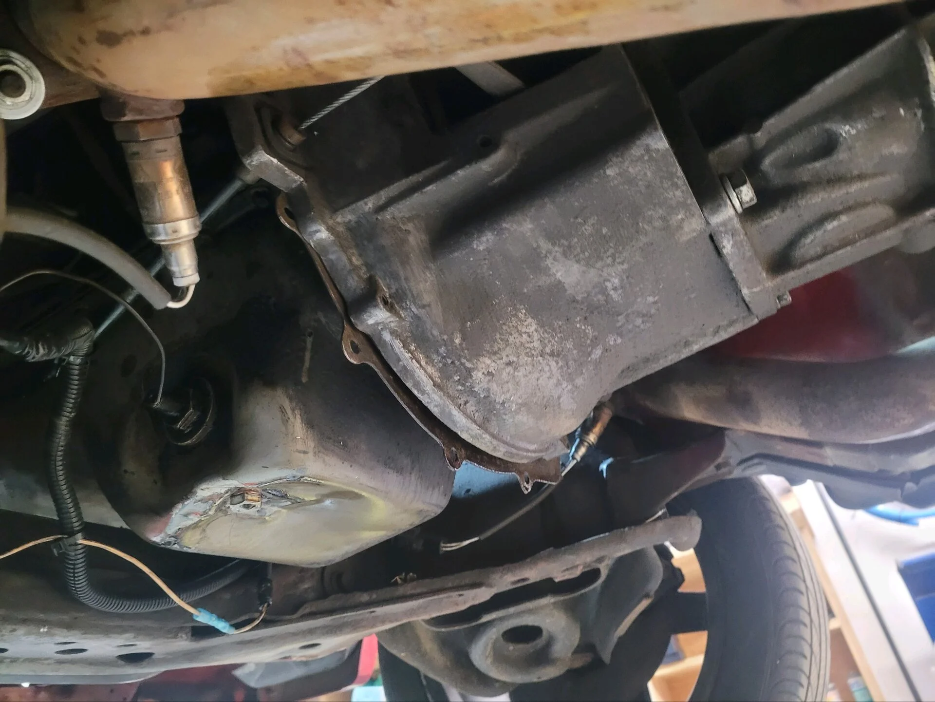

Oil Pan -- See pic of the bent oil pan that was seriously leaking. Going to install a new oil pan -- some knuckle head must have tried to jack up the engine under the oil pan! It also has the wrong block plate as seen in the pic. Fortunately, the oil pan doesn't have any metal shavings and the bottom end doesn't look to bad, but the oil was very thick black and likely not changed recently. I don't know how many miles the engine has on it and I don't see any sign of it being rebuilt. I might pull a couple of the caps and see what the bearings look like. I'm leaning toward installing a new timing chain, oil pump/rod/pickup along with seals and then putting on a new pan and hoping the bottom end holds up for a while - is this a good plan or should I pull the motor and install a crate motor?? I'd like a reliable ride, but don't want to get a crate motor right now.
Steering Rack -- I also went ahead and remove the rack since it's leaking profusely -- but note that I didn't have to remove the rack and was able to get the oil pan off with the rack on the car. Still considering the best option to get an upgraded rack -- maybe an upgraded SN95 that is rebuilt by a reputable small town shop?
I'm not sure what the forum rules are, but maybe I will need to start a new thread if I keep up a discussion on this somewhat convoluted progress?

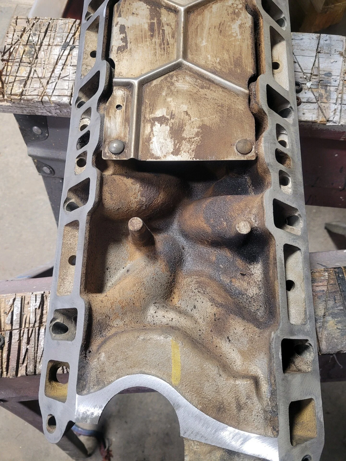

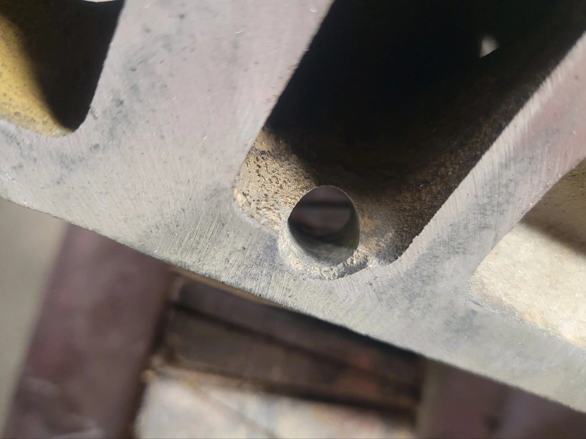

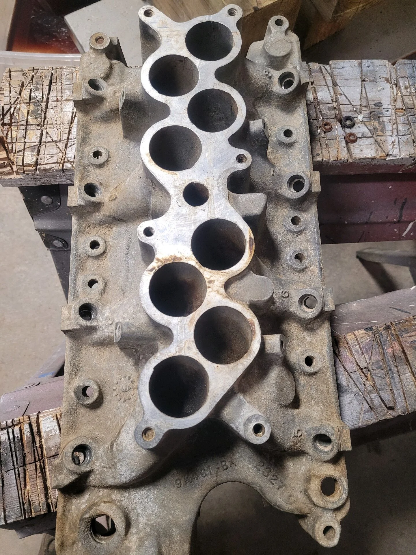

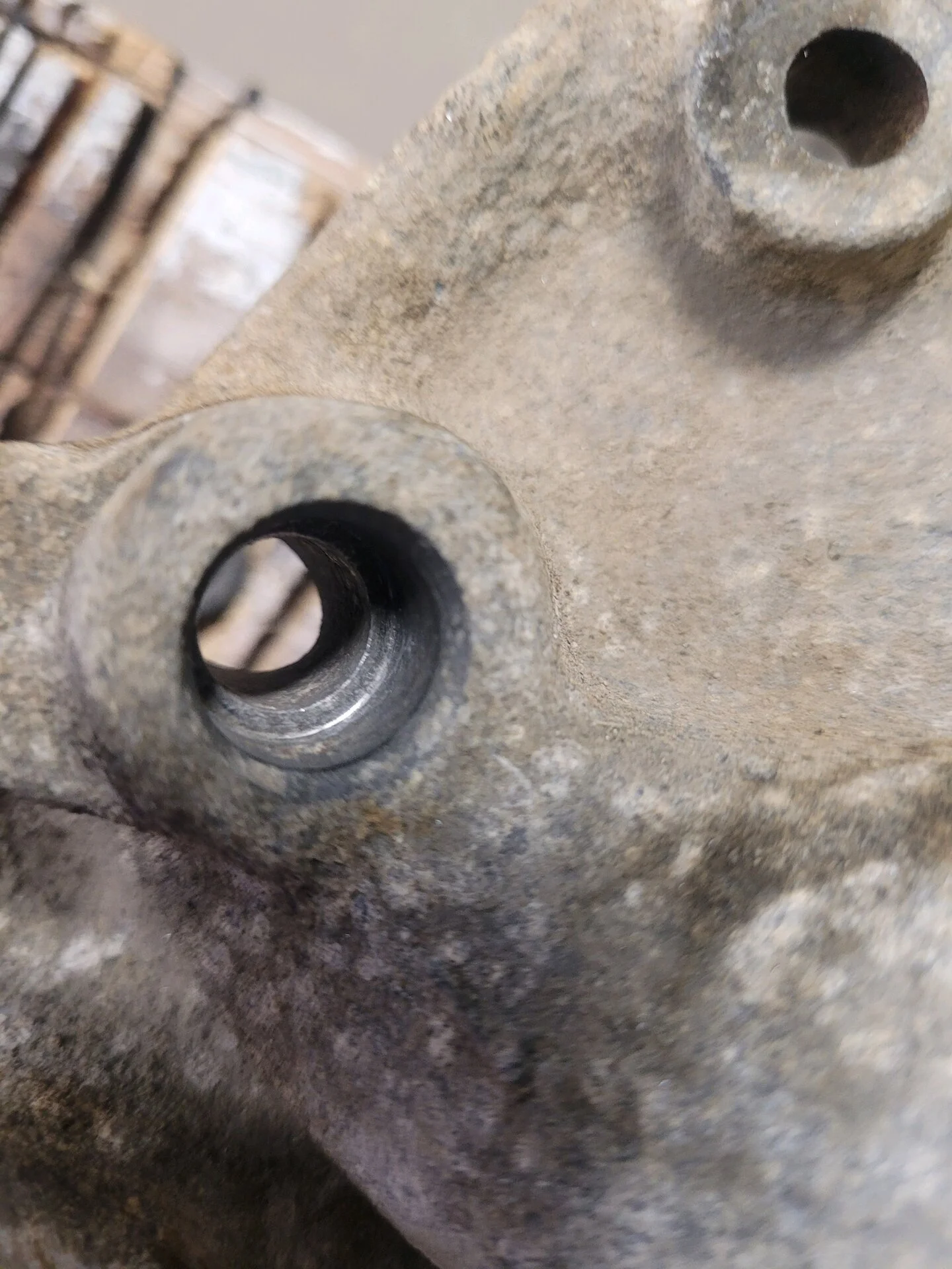

I had to pry out the injectors from the explorer lower intake. After an initial cleaning, here is what it looks like.
How clean do the injector ports need to be for the injectors to seal properly and not leak?
Any ideas on a good technique to polish the ports without going to a machine shop? Maybe use some sandpaper on a Dremel?

Clean them with some brake clean and a rag, no dirt/debris. I think polishing the intake runners will not get you anything, make sure the gasket does not intrude into the port area.
JMO
