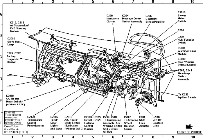

Would you happen to know the location for the SRS Control Module on the 1993/1994 Crown Vic or E-150 Van? My local Pull-A-Part has two of each and trying to find where the modules are on the vehicles.

I don't have info for 1993, but for 1996 it was in the glovebox area or pass kick panel
