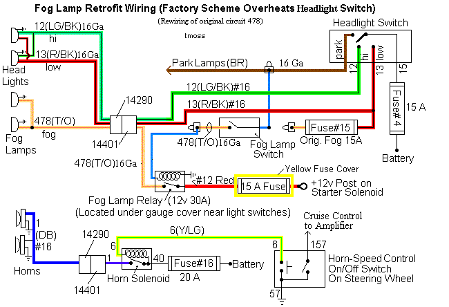

I just ordered a new set of fog lights from Late Model Restoration and I'm having trouble with my stock wiring harness. The lamps do not illuminate and I have full ground at the fog lamp fuse instead of full positive when the key is on, off, or start. I was wondering if anybody had the wiring diagram for the fog lamps, usually I would have access to alldata to pull the diagram but I'm on winter break from school and don't go back till the 19th. Any help would be appreciated!
http://www.veryuseful.com/mustang/tech/engine/images/MustangLights-Horn.gif
