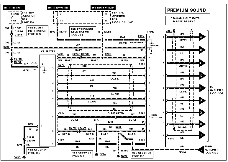

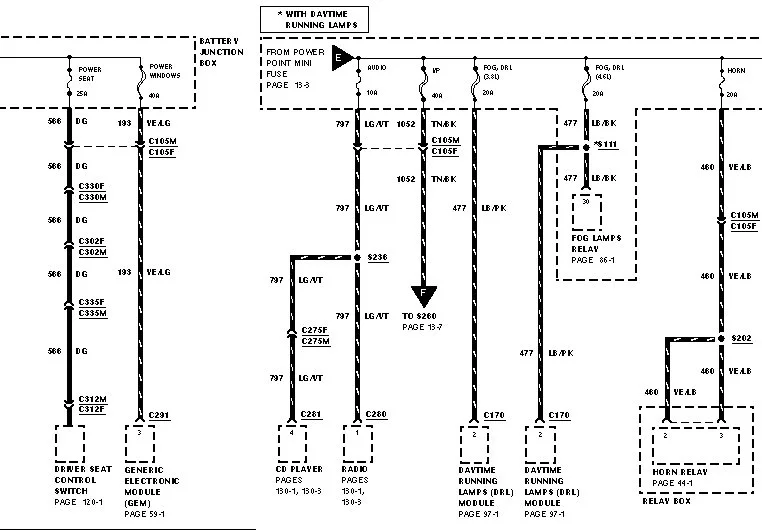

Does anyone have a ford EVTM showing the 94-00 radio wiring with the slave cd setup?
I'm installing a slave cd unit in my fox, and need to know the wiring of the red power plug (6 pin) for the slave cd. I have the data cable out of a sn95 to hook to the head unit, but only have a pigtail for the power harness and no idea where to hook the wires up.
If someone has a scan showing wire colors and what they are (power, ground, etc) can you help me out? Thanks
Doing this. Radio works, slave hooked up, but just need the power figured out
