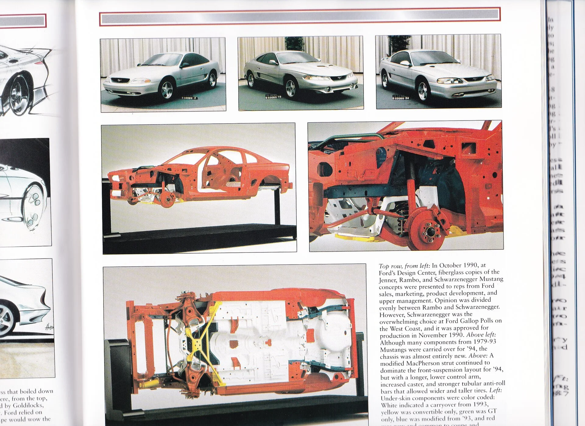

This is from a book called Mustang Chronicles - the sidebar states the white parts are carryover from the Foxbody to the SN95 chassis. So floor pan and trunk pan should be the same length, so H-pipe and cat-back dimensions should be the same.
Thanks. That book seems like a great read.... hopefully it bolts right up....
