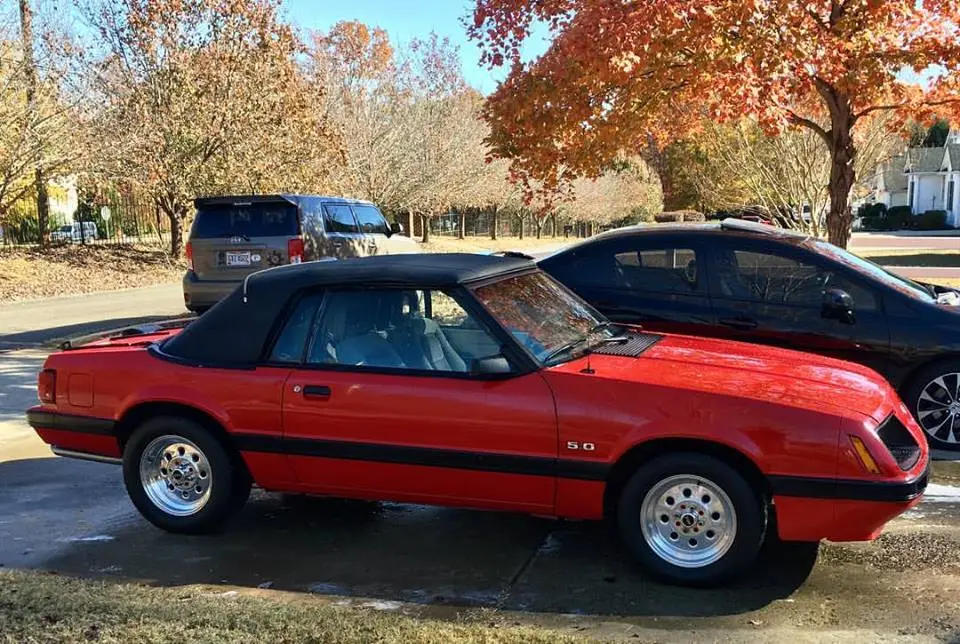

New member, new project, very excited to be here! I've had several Mustangs over the years, which all came & went as my kids grew. Now that they're all out on their own it's time for another. I found a solid 4 owner, 105k '86 convertible/auto locally and jumped on it. I normally wouldn't have chosen a convertible (this is my first), but I did want an auto, and a clean/un-wrecked/un-salvaged/no rust Fox body is tough to find for under $5k. The car did have several upgrades already, which added to it's appeal;

Good to have you with us and what a nice looking 4i. Post more pictures of it when you can.
Love the car. Going to need to address the chassis/suspension along with your other parts/wish list to get into high 11's. Sounds like a fun project and gots to love the 4eye!!!

Welcome and that is a beautiful ragtop.
