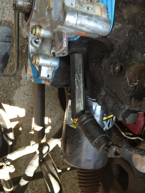

I am swapping my fox brackets for 94-95 accessories. The bracket on the drivers side is hitting the oil pressure sensor mount. Does anyone know what the 94-95 did for the oil pressure sensor?

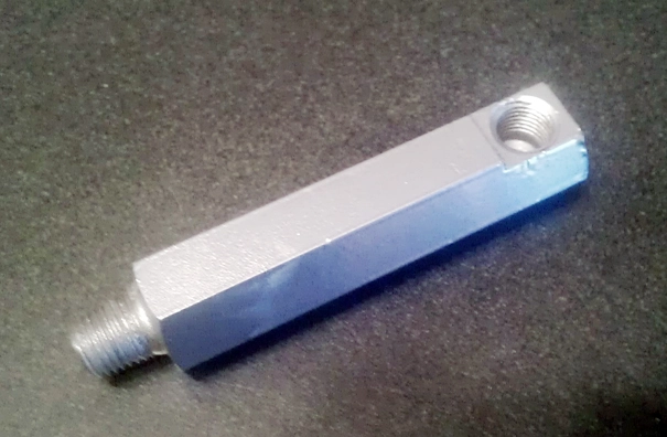

This is the piece I am referring to:
Thank you for any help!
possibly get an NPT fitting at the Home Depot? I know I had to get one for my autometer water temp sender. you may be able to find one that will work.
Adams91lx,the 94-95 factory oil pressure sender (its more of a switch then sensor) mounts directly into the block.
It does not use the extension that fox bodies use.
Here's the best example I could find.
Its not mine,just something I found on the internets.
