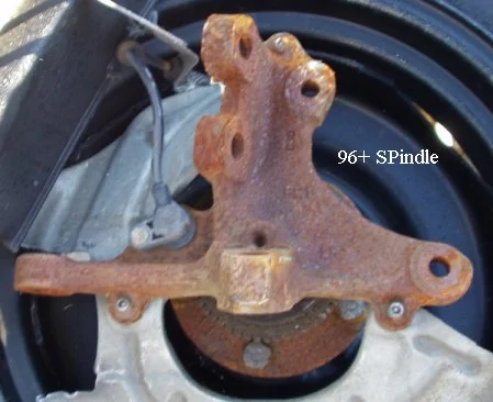

trbkrb Founding Member Jun 4, 2001 1,976 4 39 Houston, TX Apr 6, 2008 #3 Apr 6, 2008 #3 Easy way to tell, it has a curved steering arm. The 96-04 spindles have a straight steering arm. Here is a pic of a 94/95 from Matt90GT's website: And a 96-04:
