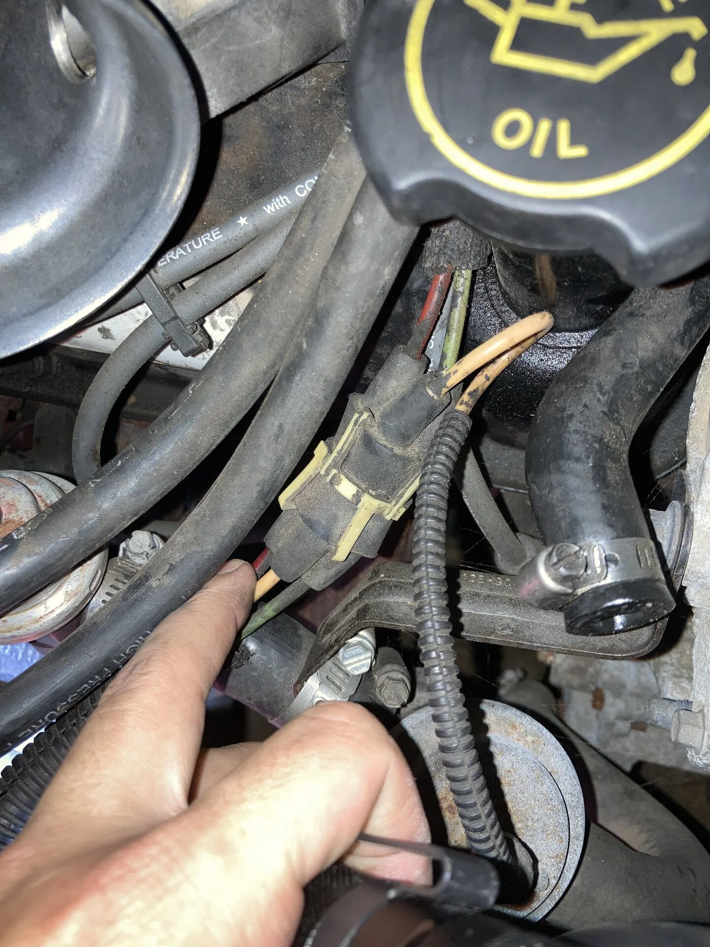

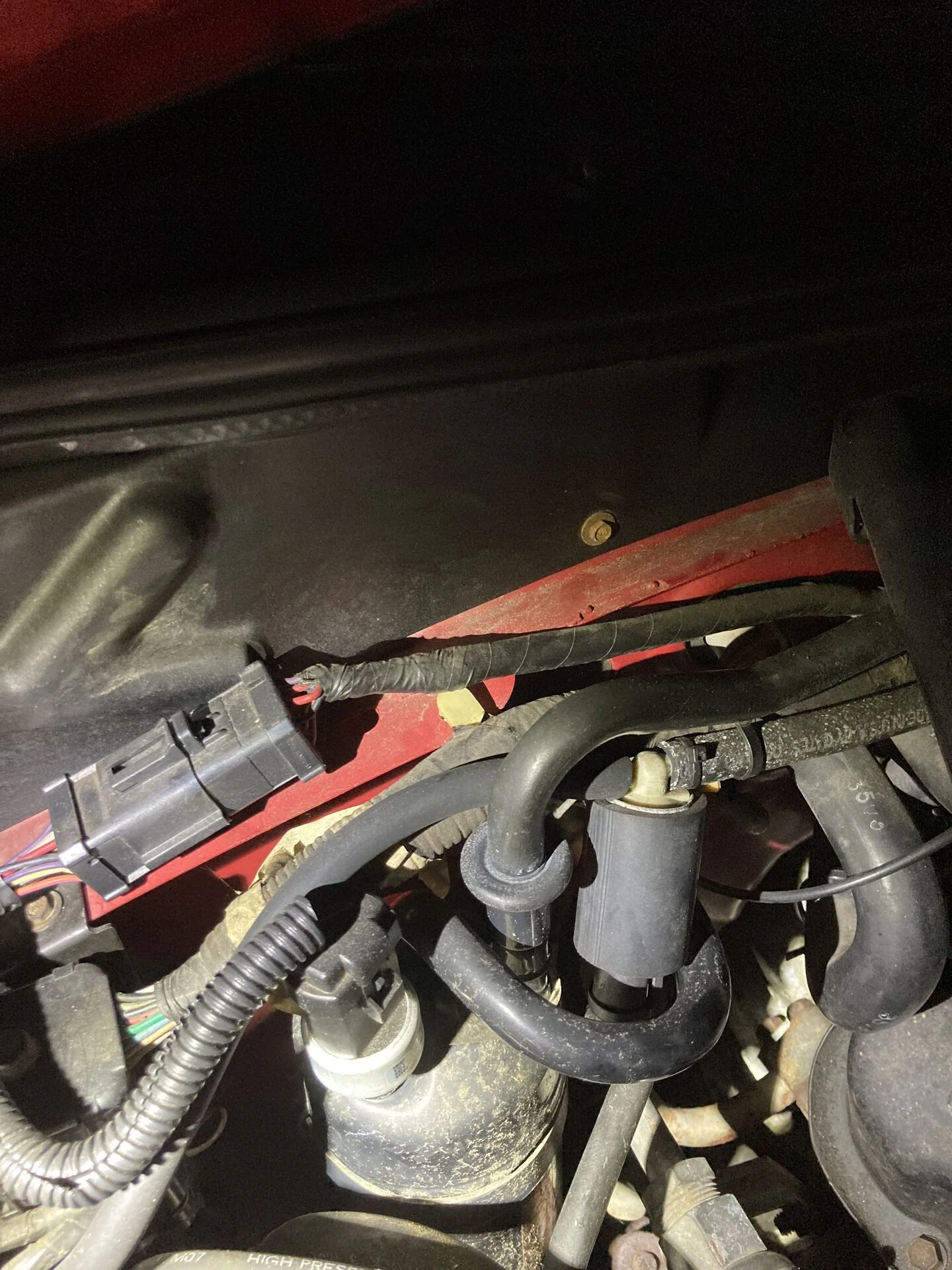

So i just got my new motorcraft iac in and installed.. still no change. Im beyond baffled… i don’t believe in mechanical coincidences, so how in the hell can cleaning these parts wind up making the car idle up +400rpms? I cant get it to come back down no matter what.. the throttle is still hanging up.. the only think im wondering is what is the sensor thats on the rubber boot that connects the tb to the maf? I also cleaned that with electronic cleaner, and thats the only one that I haven’t messed with.. i don’t understand how unplugging the iac makes the throttle down lag disappear yet its not needing to be replaced? Also to even adjust the idle on the iac is basically impossible since they engineered it terribly you cant fit a Allen key barely between that and the oil fill, so its nearly impossible to even adjust. I have yet to try to even adjust the idle since the old one made no change and assuming this one wont either since it still has all the same problems.. i guess all i can even do now is try to find vacuum leaks but i dont have a smoke machine and have been looking and yet to see a leak. All the vacuum hoses on this car are actually still looking in good shape (at least the ones i see are) so i have my doubts unless something magically came unplugged and i dont see it.. someone please give me some advice, im becoming frustrated.. i hate throwing parts at stuff since this always happens, but i really felt like i was on the right track since all i did were those things mentioned and the problem got worse. Also its not even really drivable the way it is, idles too high and even in gear i can basically go down the road in any gear without giving it gas and that is no bueno. Again thanks for any help you have to offer
Vacuum should be about 15 hg +- depending on idle rpm and steady.
Check the vacuum line under the intake in the front, it goes to the charcoal canister, it may have broke or came off. Hard to see.
Ok thanks, also ive been looking for the line u mentioned and i do not see one, so you must be right about it being hard to see
Edit: are you talking about the 3 that connect underneath the intake boot? Just looked at them and they LOOK ok..
It come out from under the front of the upper intake going to the passenger side by the fuel lines down to the canister. You just about have to raise the upper intake to see the nipple.
I assume by front you mean the front of the car? I swear ive been searching nonstop and see none. I do however see the one go to the back(firewall side) of the upper intake and can feel that it is connected.. also the 3 or 4 that come through under the rubber intake boot look fine..
