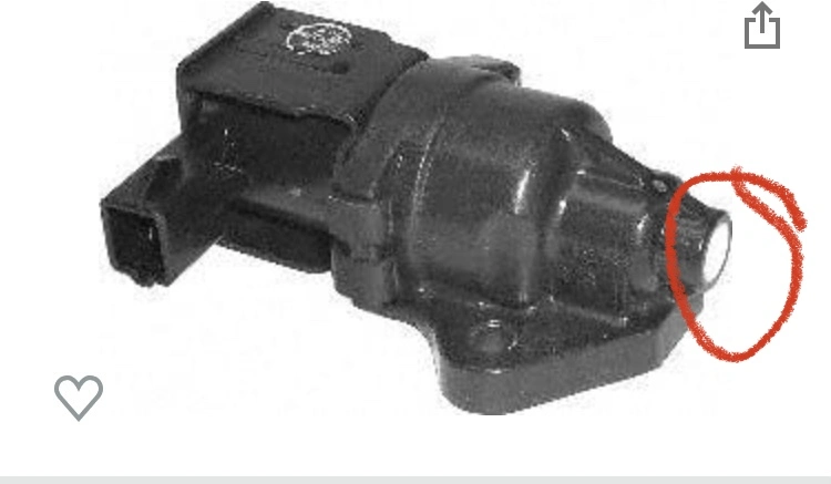

How bout a pic of this plug you're talking about.
This is the white rubber plug, and behind it contains the “idle adjustment screw” for these years of cars apparently. Also i just messed with it some more and was able to get the screw freed up after I hammered a torx bit into it which was able to actually grab the plastic good enough to turn it.. anyways I adjusted it out as far as it could go and still only got the idle down to 1100rpms with it unplugged. Makes no difference in rpm speed whether its plugged in or not, but it solves the hanging rpm problem completely. Only thing i can think of is someone adjusted the throttle stop screw thing in the past and me cleaning the maf undid their “fix” and now its needing to be adjusted again but i have my doubts and i really dont want to mess with that throttle stop stud.

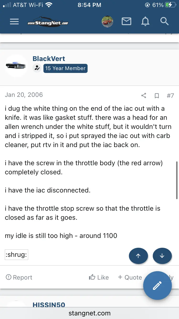

I was just reading another thread back from the stone ages and this guy sounds like he had my exact problem down to the T. Ill include a pic of one of his posts, and of course, unfortunately it was never resolved or at least never posted an update..
Edit: i just checked my tb butterfly, and it looks closed all the way so i dont thing the stop screw was adjusted..

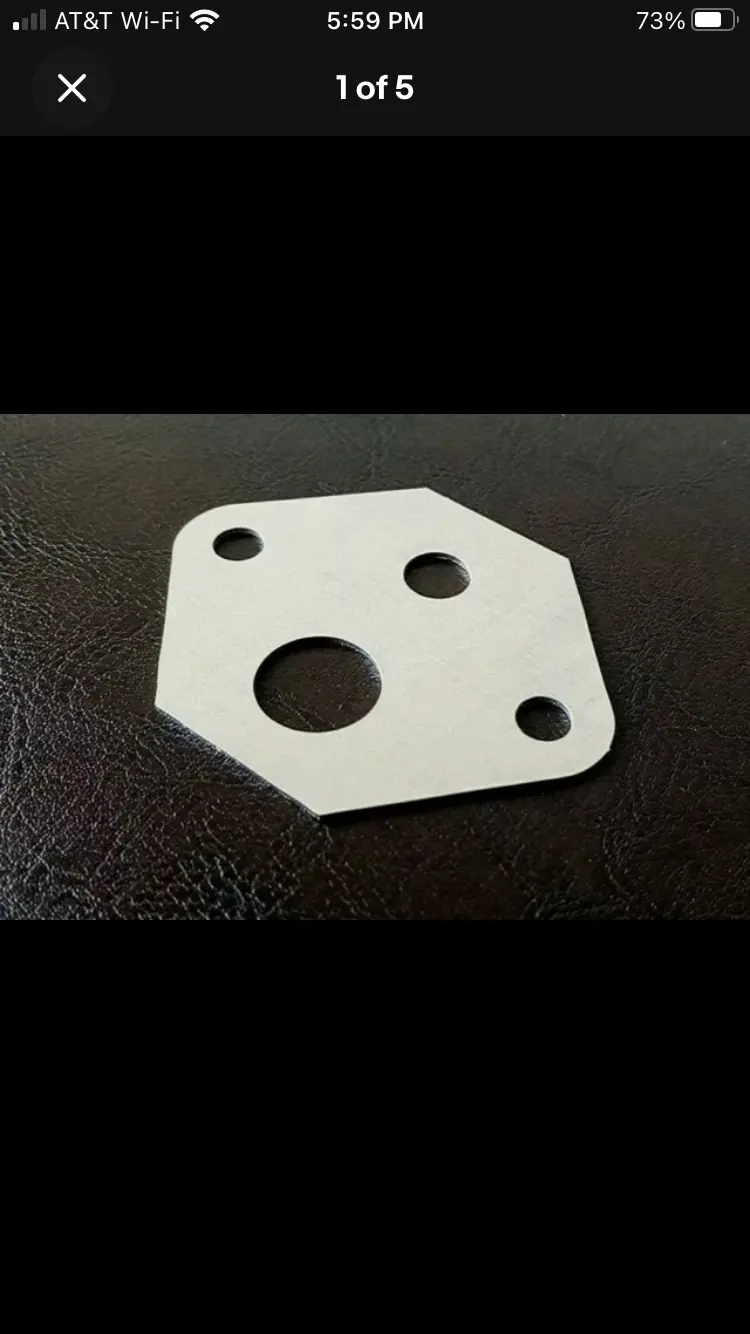

Yes that is correct! I turned the throttle stop screw which is apparently not supposed to be messed with because the tps voltage but i claim bs on that because mine is just fine..But i will be trying the iac restrictor plate (I’ll include a pic of it for anyone wondering) i need it to be plugged in because without the iac plugged in, trying to have A/c while idling doesnt go so well.. but anyways from what i read many of these sn95s need that plate to stop the hanging throttle while driving, and the rpms shooting up 200 rpm between shifts.. I’ll update when i receive the plate and let you all know how it works in case other people have this issue in the future..

Where did you buy the IAC restrictor plate?

I got the iac plate off ebay, just search your year car iac restrictor plate and it should come up, make sure the seller isnt in china, i made that mistake and i probably wont see it until next year lol.
Also with the iac unplugged, one thing that is an issue is if you have A/c, forget about running the A/c while sitting there at idle, the IAC is needed for that to happen successfully. Hopefully with the plate its a good balance between allowing the iac to do its job while also not keeping the rpms hanging between shifts..
