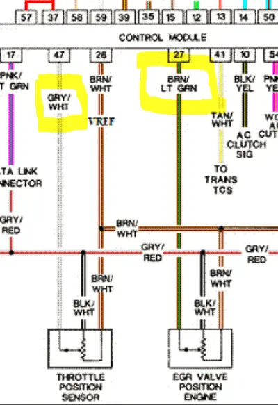

Thank you for attaching the link above. It has a lot of good info for checking out the EEC system including the idle.
In case you need to check them, I used to check the TPS and the EGR sensor with an analog ohm meter (I am old). The EEC diagram below shows they are still using potentiometers as sensors so you should be able to check the same way. Disconnect the connector and attach the meter direct to the TPS or EGR sensor. There are 3 terminals. Across 2 the resistance should start high and drop when you slowly push the plunger or rotate the shaft. Across another pair it will do start low and go high. Looking at the diagram below I would guess the one highlighted in yellow is the common lead.
EGR sensors had the most problems because the EGR valve gets hot which shortens the sensor life. An intermittent sensor will cause problems for the computer. Only buy OEM for sensors.
If the meter jumps around as you are moving there is a problem. It should travel smoothly as you rotate the shaft or push the plunger. If someone has a Ford manual they used to state the high and low resistance readings.
