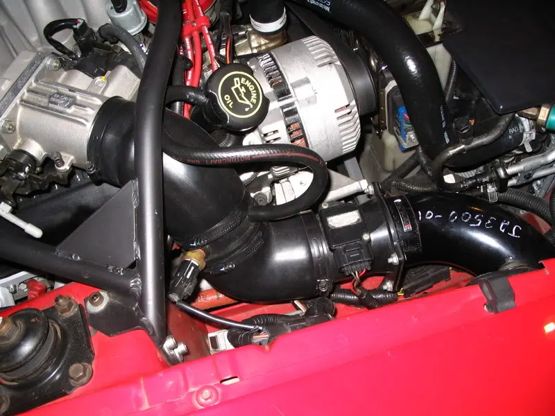

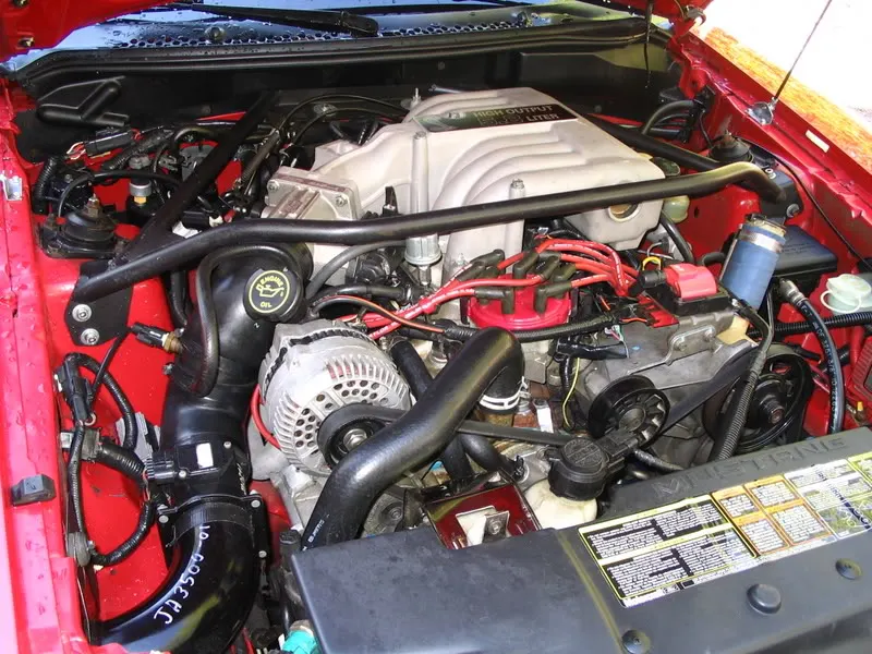

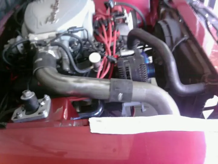

here is the set up I had with mine until I changed over to a PMAS meter.

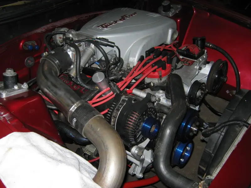

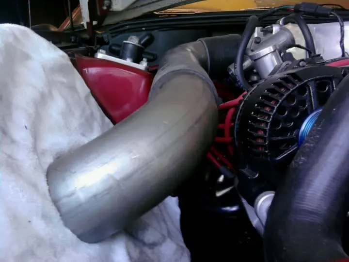

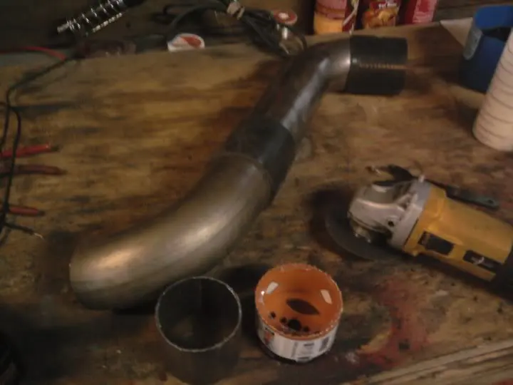

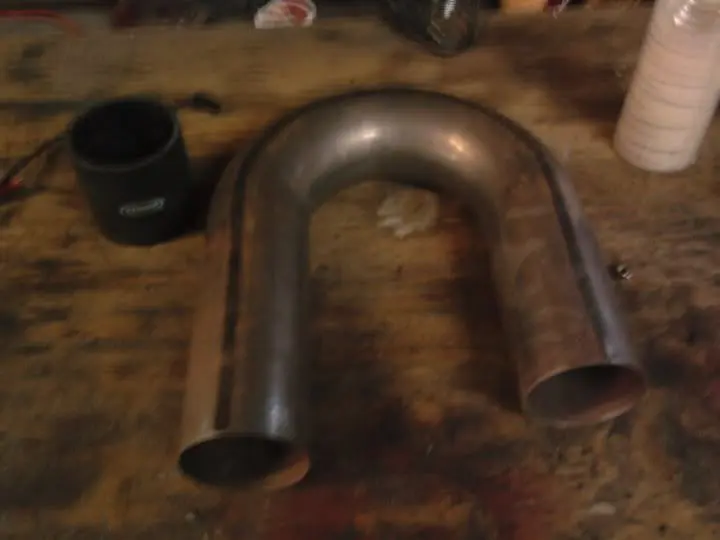

Order some 4'' mandrel bend. that is a tad bigger then 90mm a J or u bend should be enough to make an intake... then just get to cutting and welding...

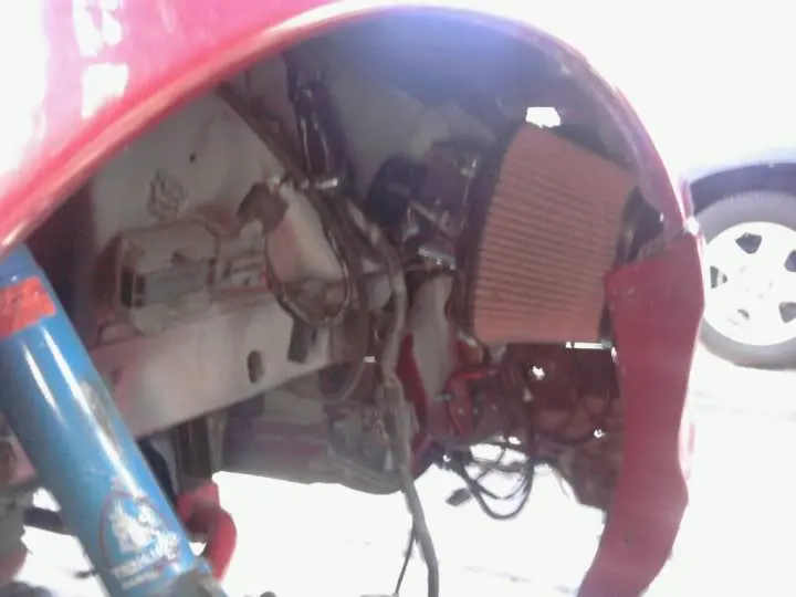

Filter should be sitting about here:

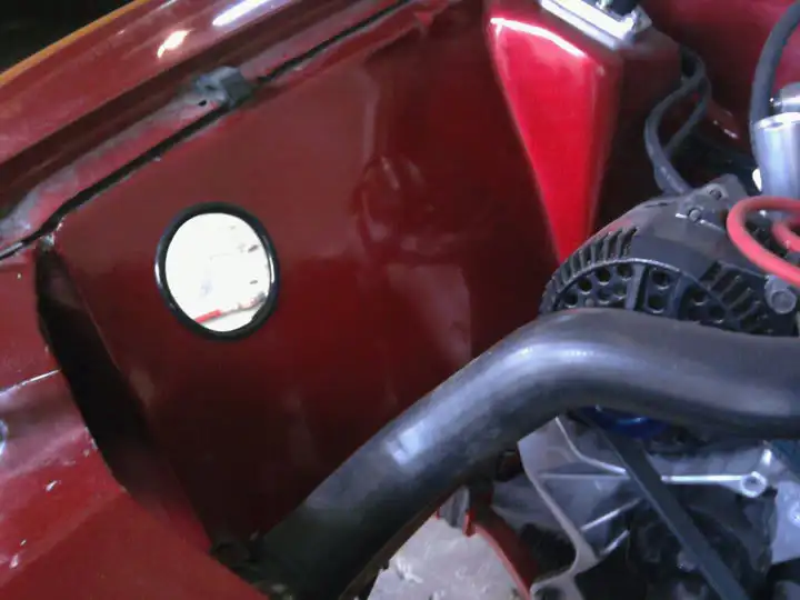

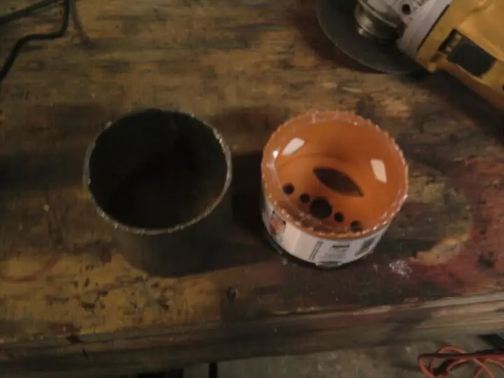

Just finished up the hole today for the intake like blackvert i lined it with silicone vac hose.

Thanks Venom, Adam. Adam - where did you put the MAF at? Is that what I see at the end with the air filter hooked to it outside the fenderwell?
Yea im gonna try to keep it in the fender directly off the filter. So i figure there its not after a bend or anything... Ill see how it goes for tuning. If i have to move it to the bay so be it :shrug: im not gonna weld together the 2 pipes just yet incase this is the case.
