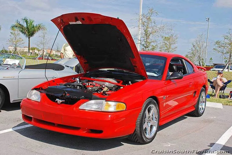

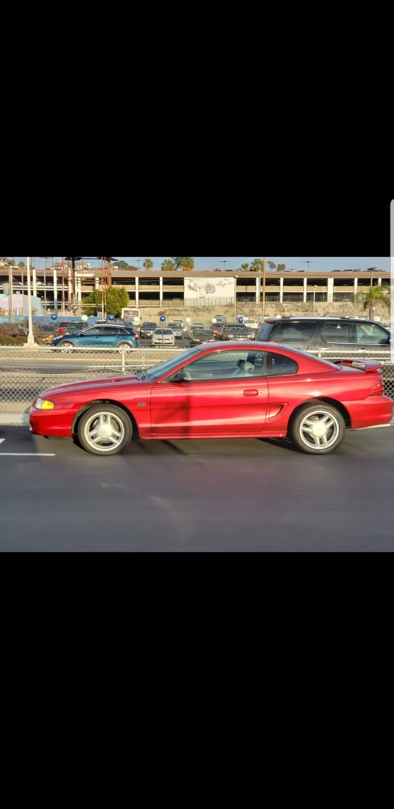

Here is my previous red 94GT. The rims are 2003 Cobra chrome 17's with 275 tires up front and 315's out back.
The drop is subtle. When I get the new tires on the white car I'll post some pics.
Perfect! Just how I like it,I might even omit my isos in the back
