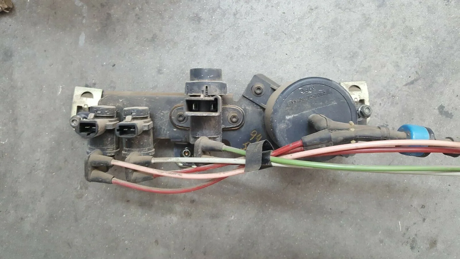

The EGR is only supposed to open at part throttle, and should be closed at idle. The EGR works off of engine vacuum, which means there shouldn't be any suction on it at idle. If it does, the solenoid in the passenger fender may have gone bad.
Here's a picture from eBay. The EGR solenoid is the middle one with the green plastic hose coming off of it.
