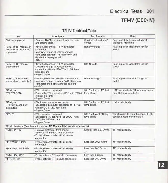

See Automotive Tools Specialty | Auto Mechanic & Technician Diagnostic, Testing Equipment | Thexton
diagram courtesy of Tmoss & Stang&2Birds
