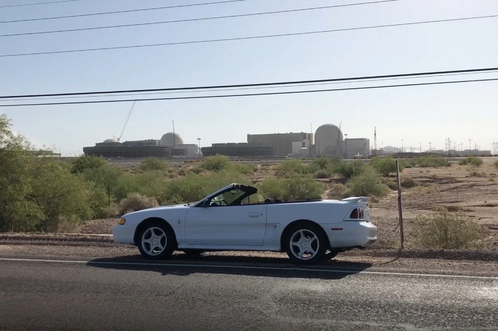

I have a 94 convertible with a V6 and automatic. Everything is in great shape except the motor. No rust at all, was in Phoenix for most of its life! Anyway the V6 is dead and it's tough to find a remanufactured V6. So I was thinking of a 5.0 swap. This isn't a racecar, just a nice daily driver. Finding the engine and trans seems straight forward. I didn't want to mess around with all the fuel injection wiring so I was thinking about just putting on one of those throttle body style aftermarket fuel injection units and an MSD distributor. Is this reasonably easy to tie into the factory harness? I'm not that concerned about the gauges, but would like the speedo to still work. Issues here? Thanks for any help that will allow me to go in the right direction!
