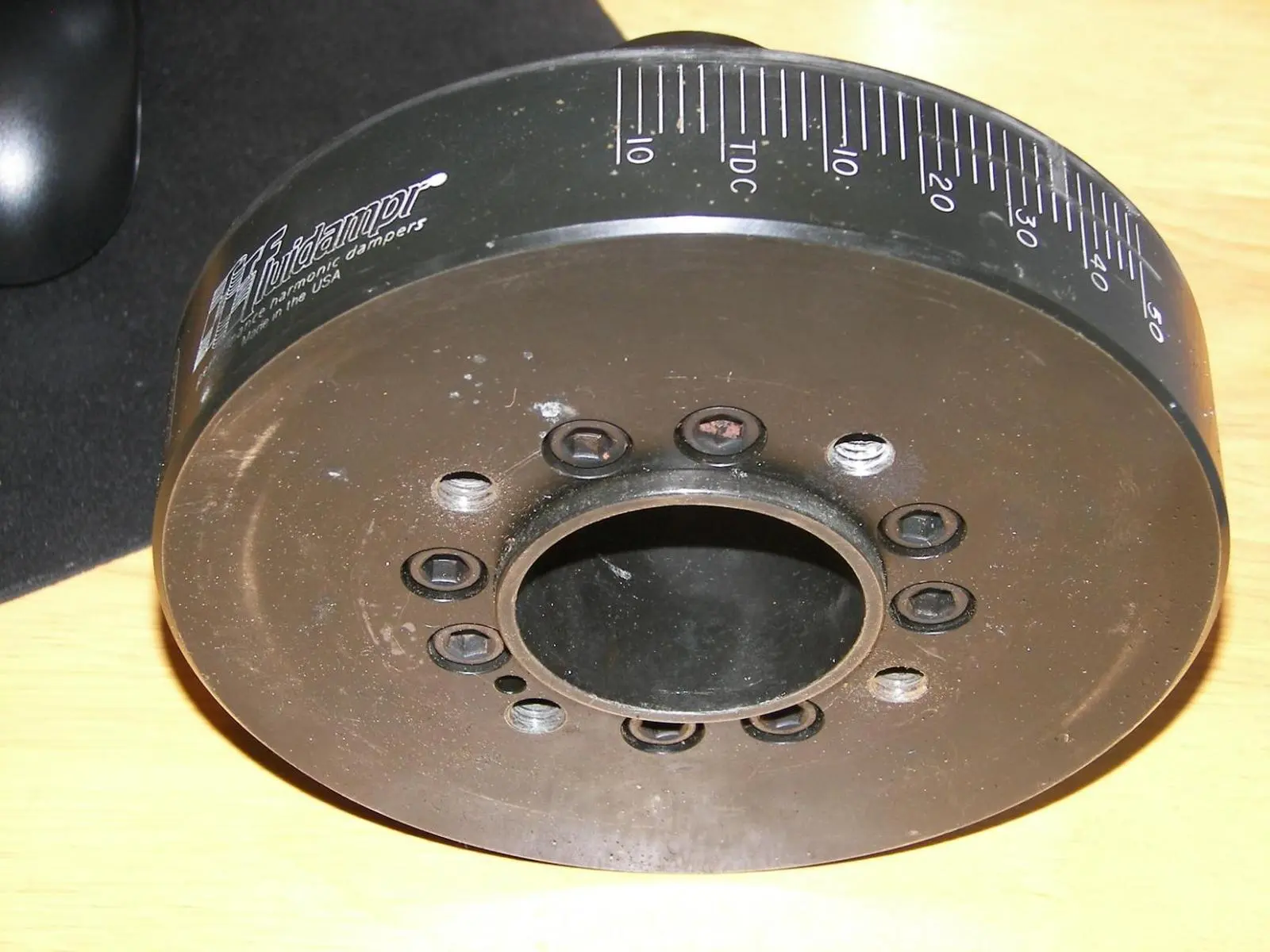

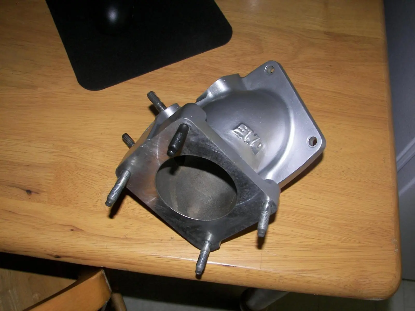

i have an extra SVO intake elbow, and a 50oz fluidamper if anyone is interested.
