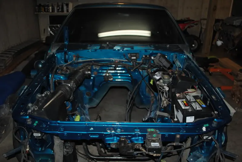

I was thinking about making a thread on the easy and non destructive way to install a 95 brake booster ina Fox for those of you that want to for your 5 lug disk brake conversion. If I get enough people that are interested then I will. I can show you how to do it without beating or cutting your strut tower brace to hell and back for a nice clean install with pics. Let me know guys!
It's really not that big of a deal. I got mine in without any bashing of the tower. I think it was a 2-hour job start to finish. Looking back, fairly easy job. Might be helpful to actuall show people what is needed
Ok give me a bit to get everything together and i will do it. I did it in my 86 gt. Im doing this cuz i have seen a lot of people get frustrated cuz they have to cut or beat the cars. Im all about the clean build. I even proved our lead tech wrong that it could be done. Kinda funny. Main thing is just patience. So i will get stuff together and start taking pics today. Including my setup. Thanks guys!
I did this without beating the strut tower. The issue I had was with the brake light/safety switch hitting on the bracket inside the car. It would short out the brakes and fuse. I ended up just getting a 93 cobra booster which fit perfect without cutting or bashing anything and was very simple to install. good luck though.
When I did the 73 MM front disk/Turbo Coupe rear disk conversion on my previous 89 GT, I used the stock booster and a 94-95 Mustang master cylinder. The brakes worked great and I didn't have to change the stock brake booster, it worked fine. I had excellent pedal feel and very well balanced brakes.
When I installed mine, I found it easier to remove a few things in the way. Made it way easier.
well i unfortunately had to hit the tower with a BFH and a punch to get it in there.. but its not visible unless u stick ur head back there. dont forget about also drilling out new holes for mounting and then as mentioned, the brake switch shorting out and blowing fuses. i had to use a 95 switch and mod it a bit to work

Hey don't piss him off, I want to see how he got a booster to fit in his '86 without beating on the strut tower, haha. If he's got some new trick, I'm all ears. I cut the studs on my booster, slotted the mounting holes, beat in the strut tower AND massaged in the corner of my booster to get it to fit.
