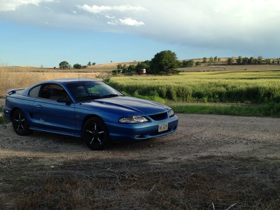

Hello all, new here to the forum, but have owned a mustang for a little over a year.
Ive done a few mods to my car, and plan on building up to a mildly modded daily.
Got this car in may of 2014 as a graduation gift from my grandparents it was a nearly fully stock mustang or so i thought.

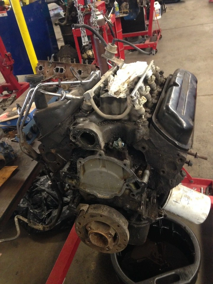

Fast forward half a year and in Tech College i find a low mileage 5.0 for 200 bucks and decide to rebuild it for my car.
Reactions: diohernandez

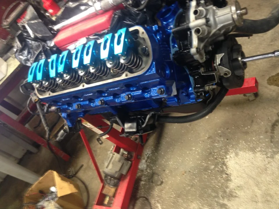

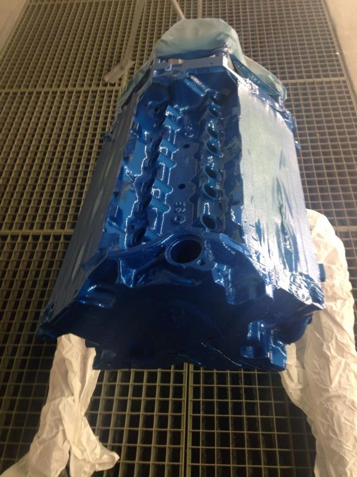

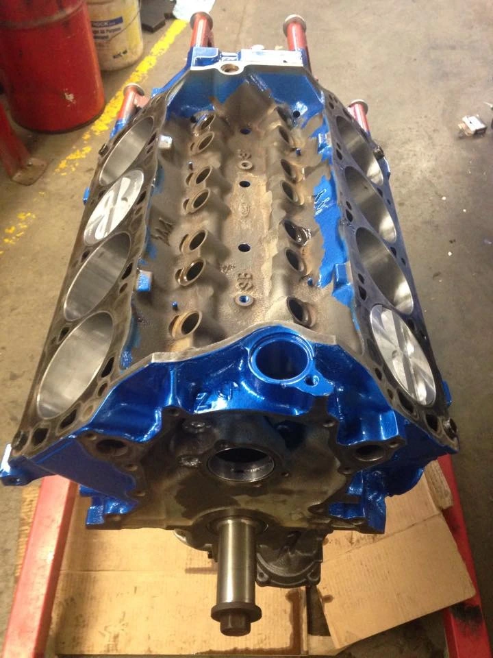

Found out the used 5.0 had very very minimal wear but I went ahead and bored it .020 over and put in dished pistons, Steeda 19 cam. Gt40P heads with a 3 way valve grind, and a fresh 1998 Atlantic blue paint job. 1609723_663279300454120_6121608320142346044_n_zpsh8jrulol.webp

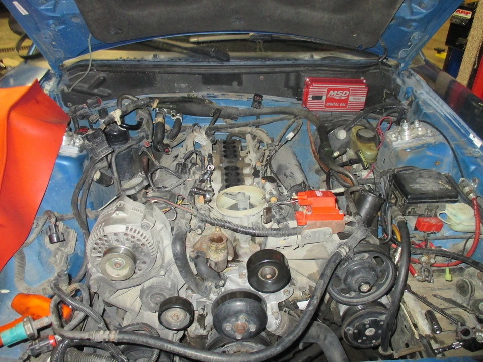

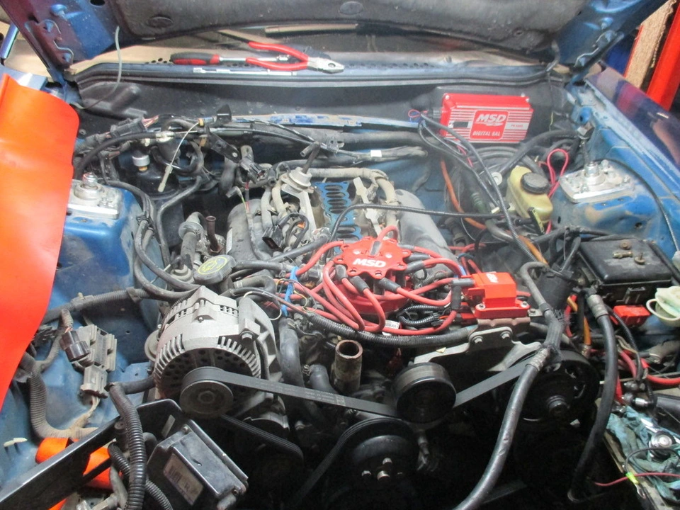

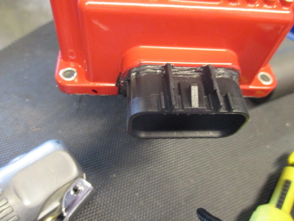

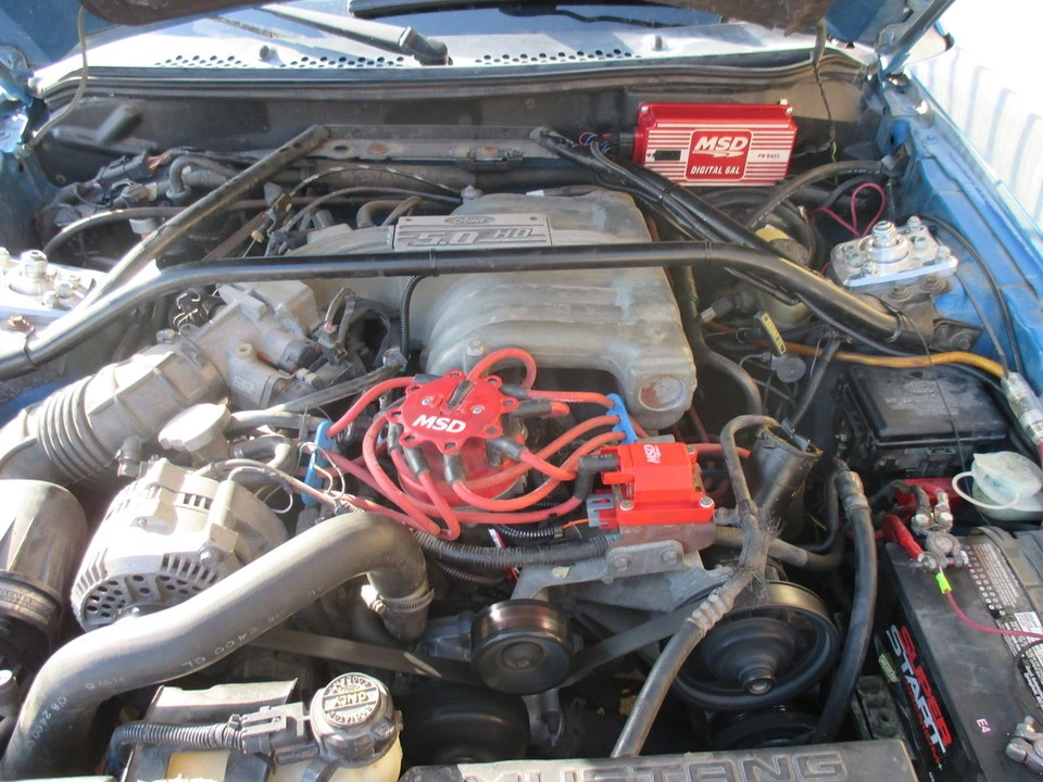

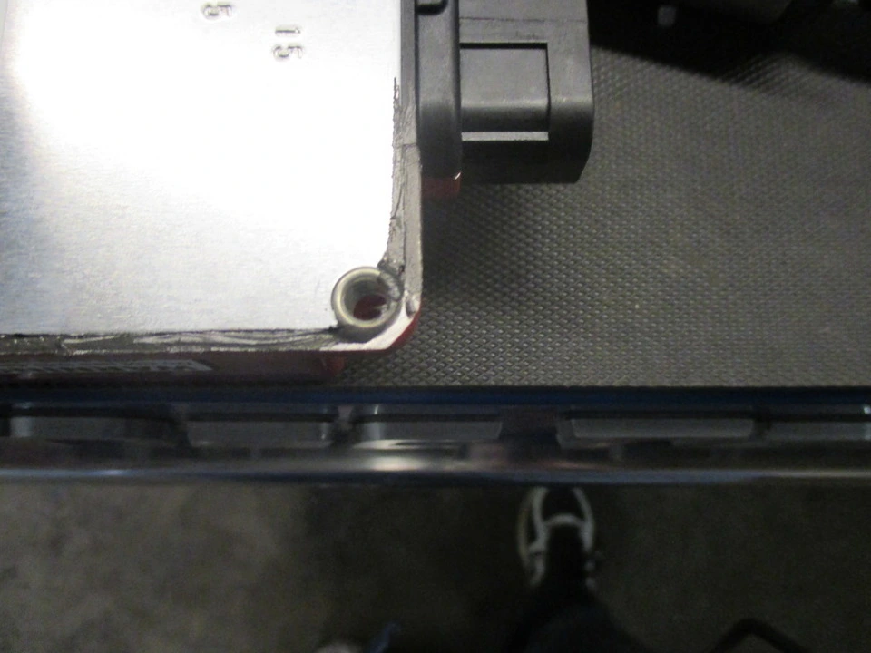

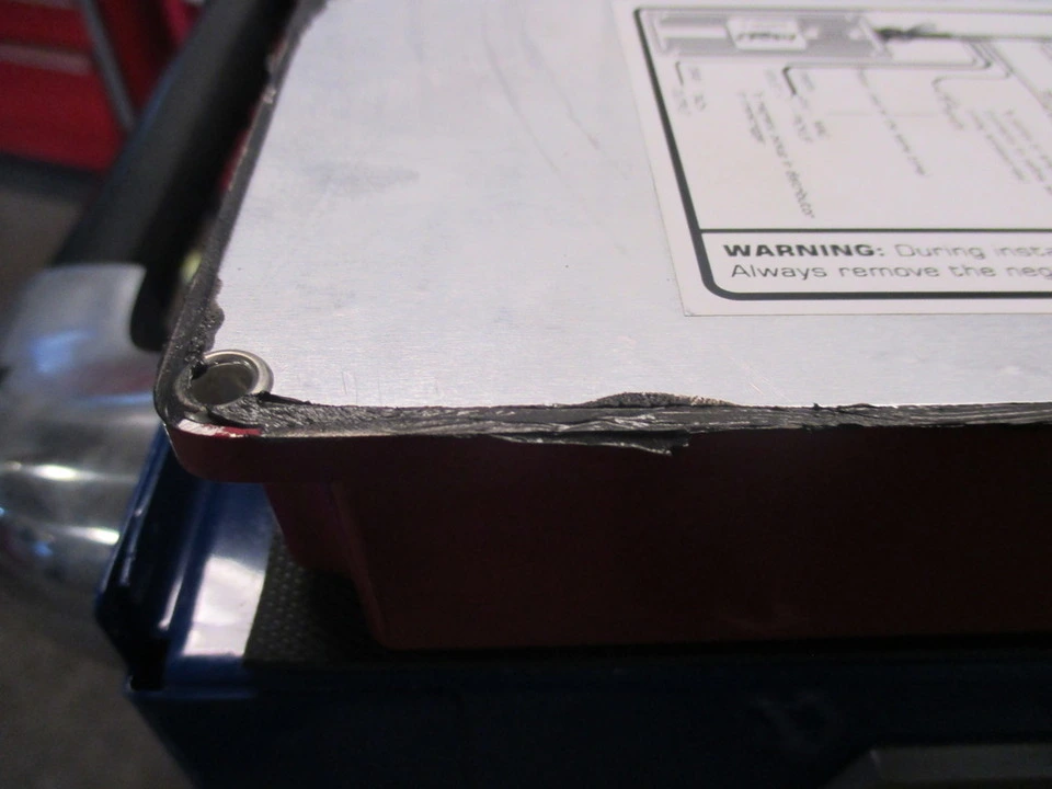

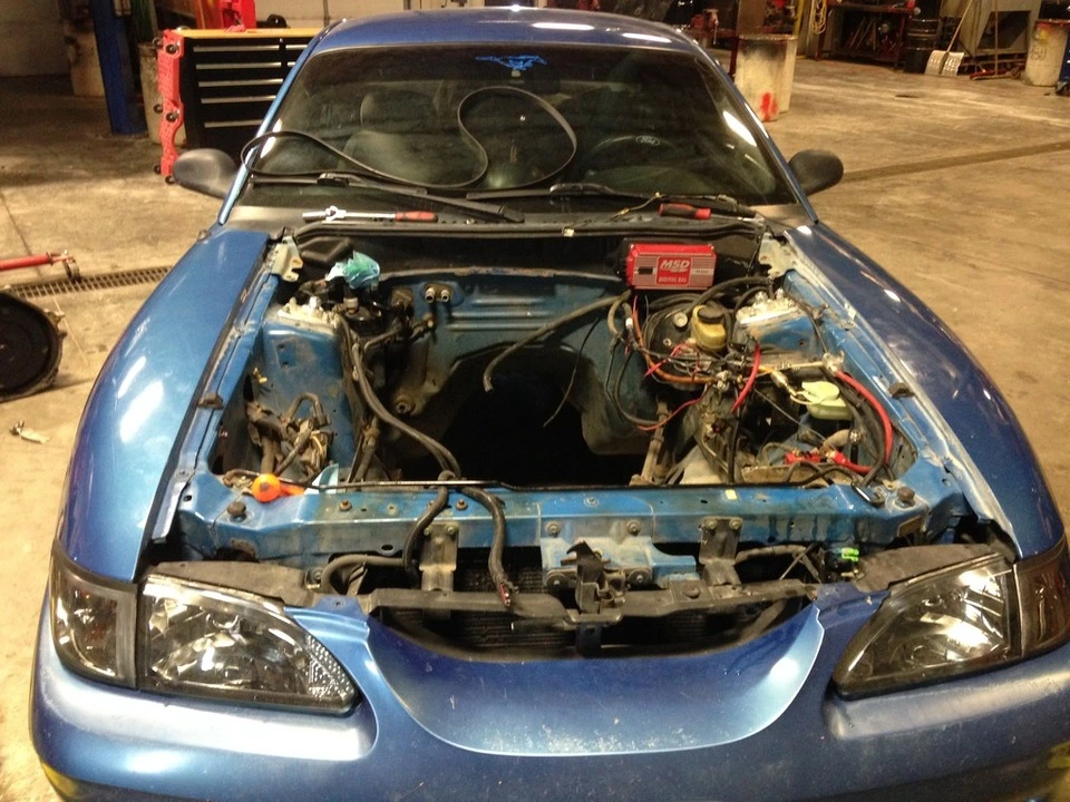

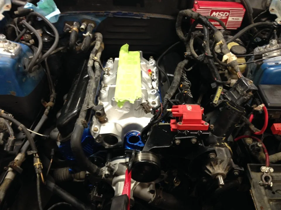

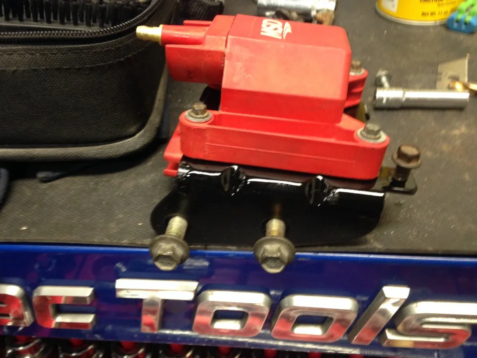

installed my MSD 6AL I've had lying around for a few months. PLEASE excuse some of the wiring. ALL of the rigged wires are from the PO, which I will fix when I pull out the engine. IE redwire coiled up because it was hot wired for the v6 power seat in a V8..... or the zero gauge amp wire for a 400 watt amp *ROLLS EYES*
I RTV'd the seams of the box to keep out any water that might get on or near it.
I just need to build a small heat shield for it now.
The coil was the OEM original from Sept of 1994. From a dead stop the car no longer bogs, then come alive. Starts up with a bump of the key and idles much smoother.

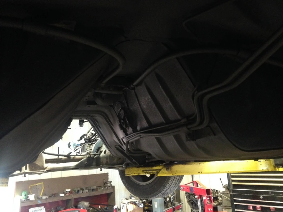

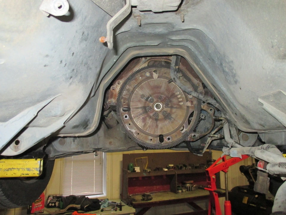

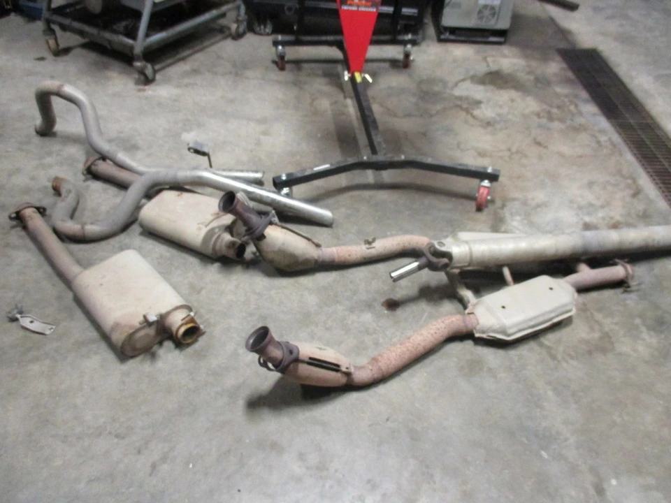

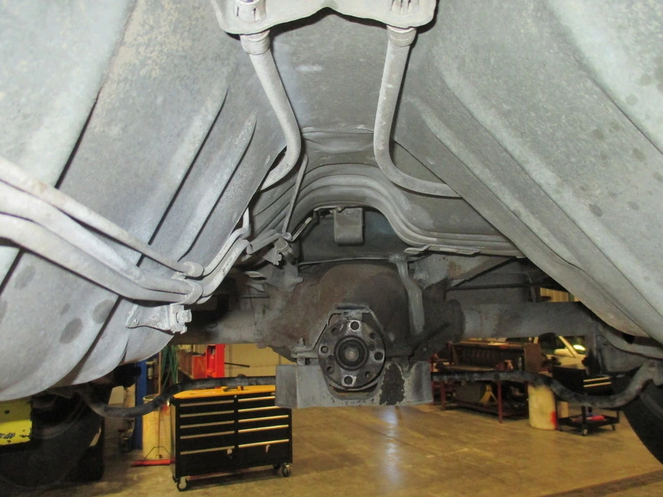

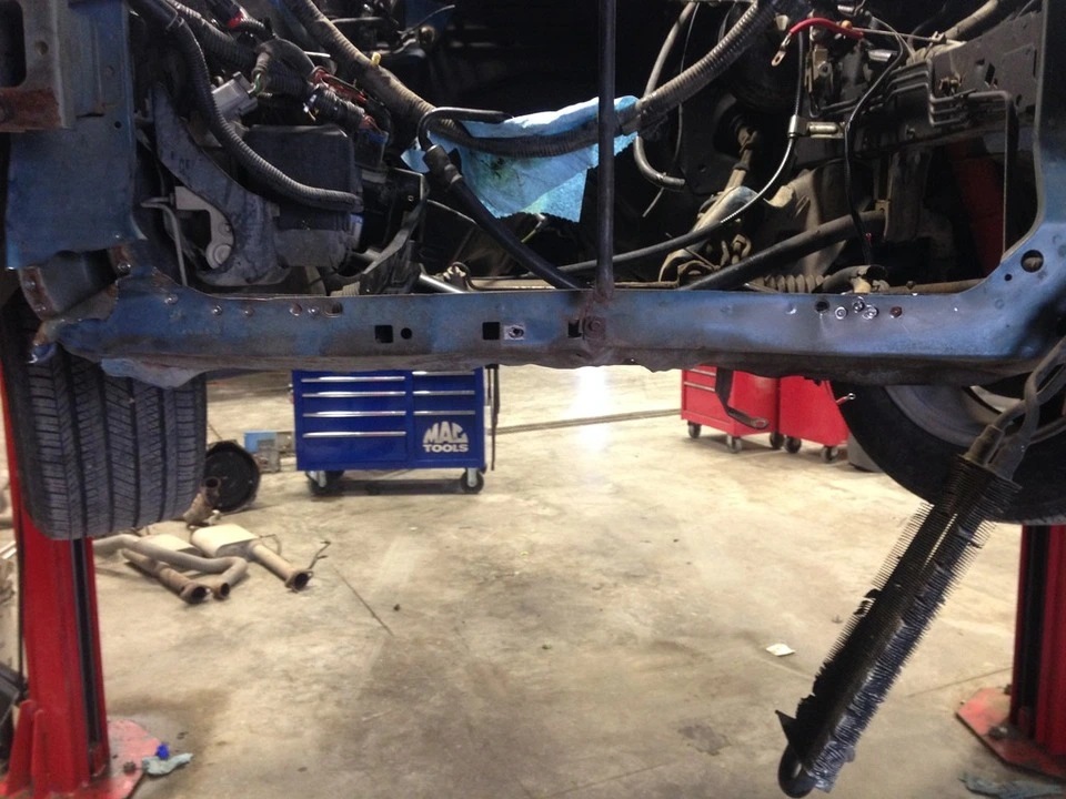

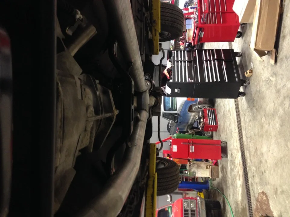

pulled the exhaust, transmission, and most of the engine in a little over 4 hours. i was surprise to find the ease of removal of every nut and bolt despite being a Kansas car.
the under side looks clean with minimal rust, and the rust present is surface rust.

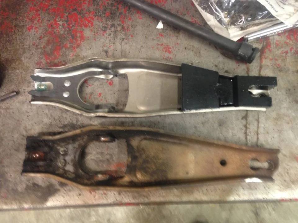

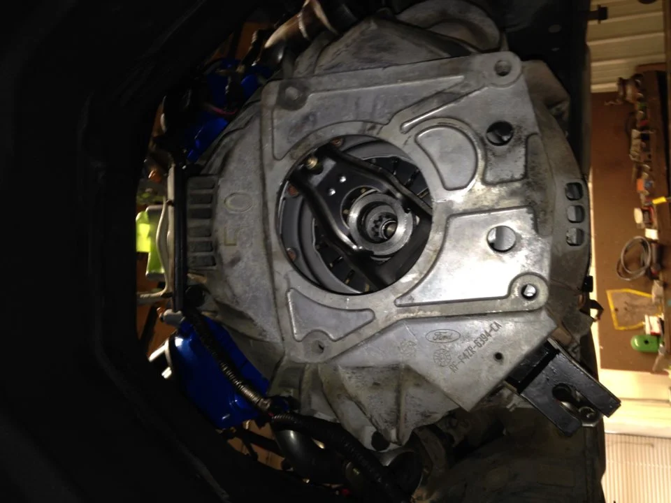

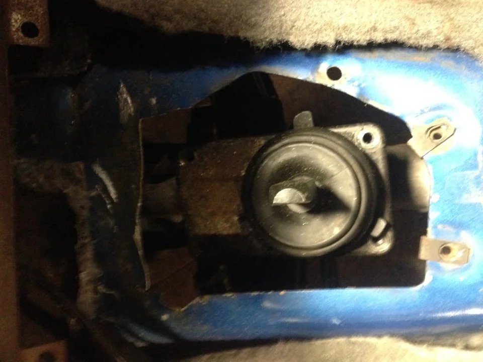

Over Christmas i went to Alabama to visit family, and while i was there i stopped by Prestige Mustang in Monroe, Georgia and picked up a t-5 conversion out of a low mileage 95 GT (80k). A used drivers power seat, and some interior trim.

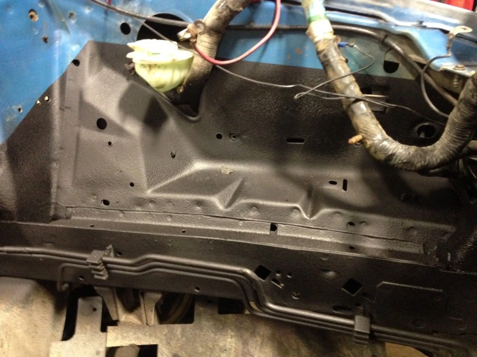

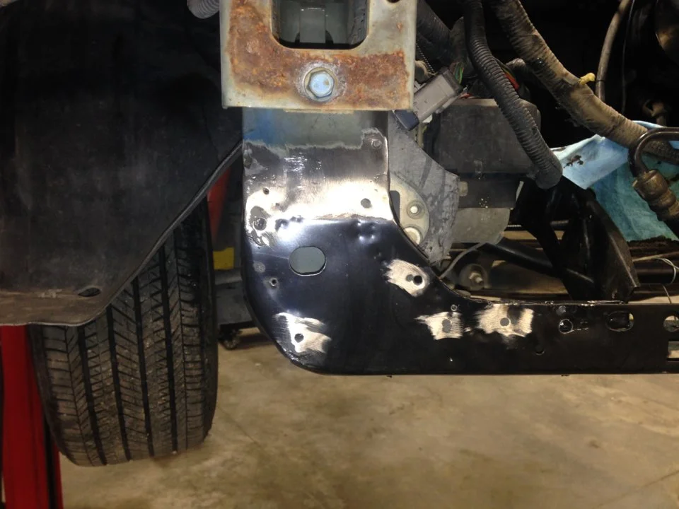

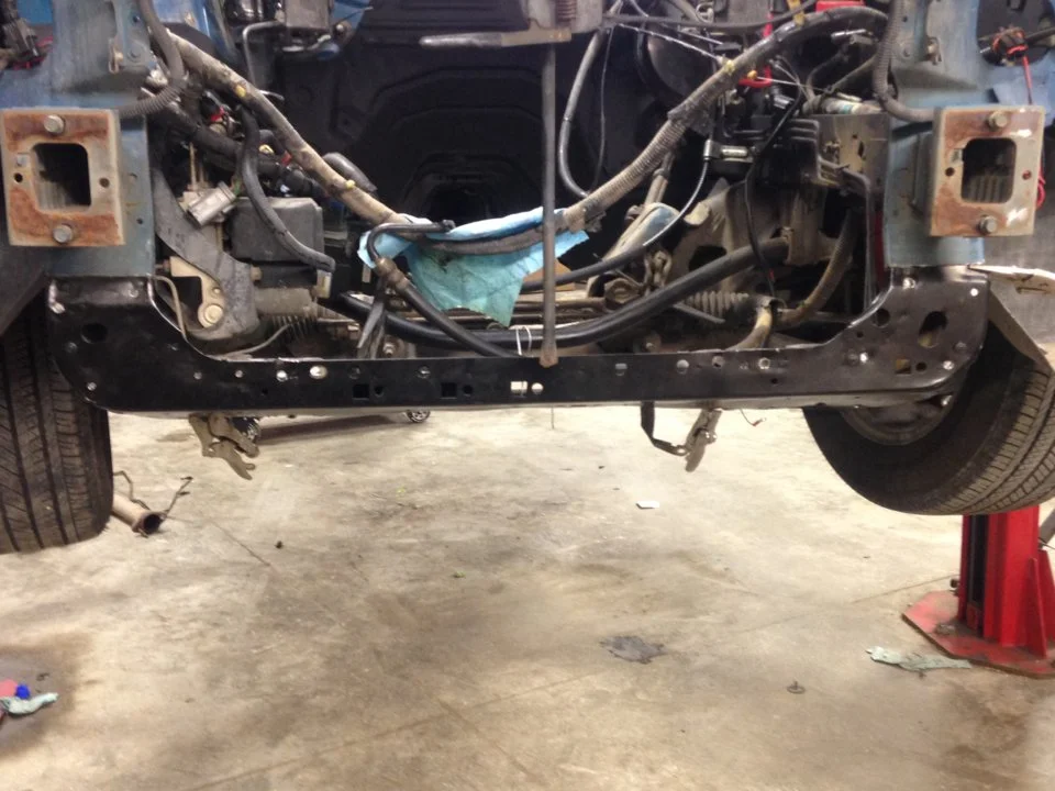

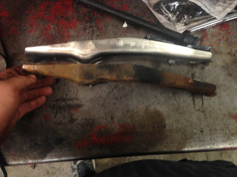

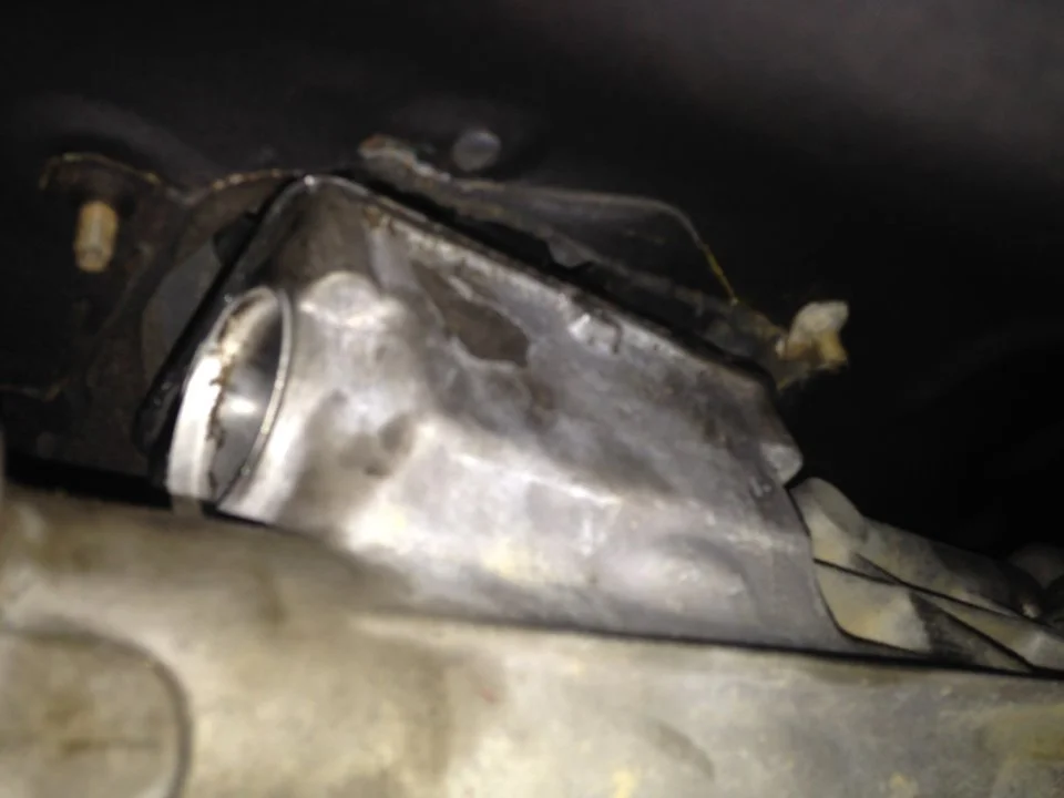

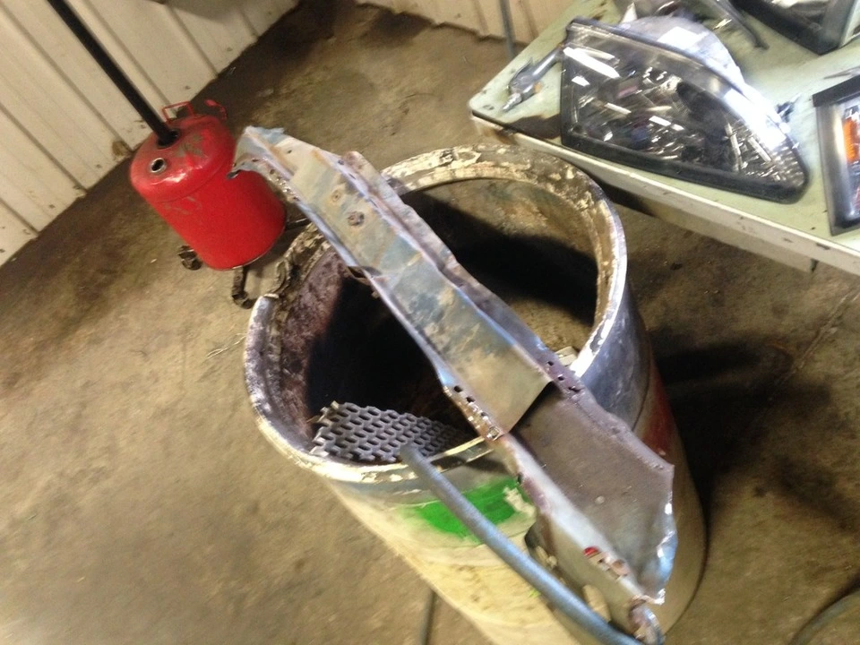

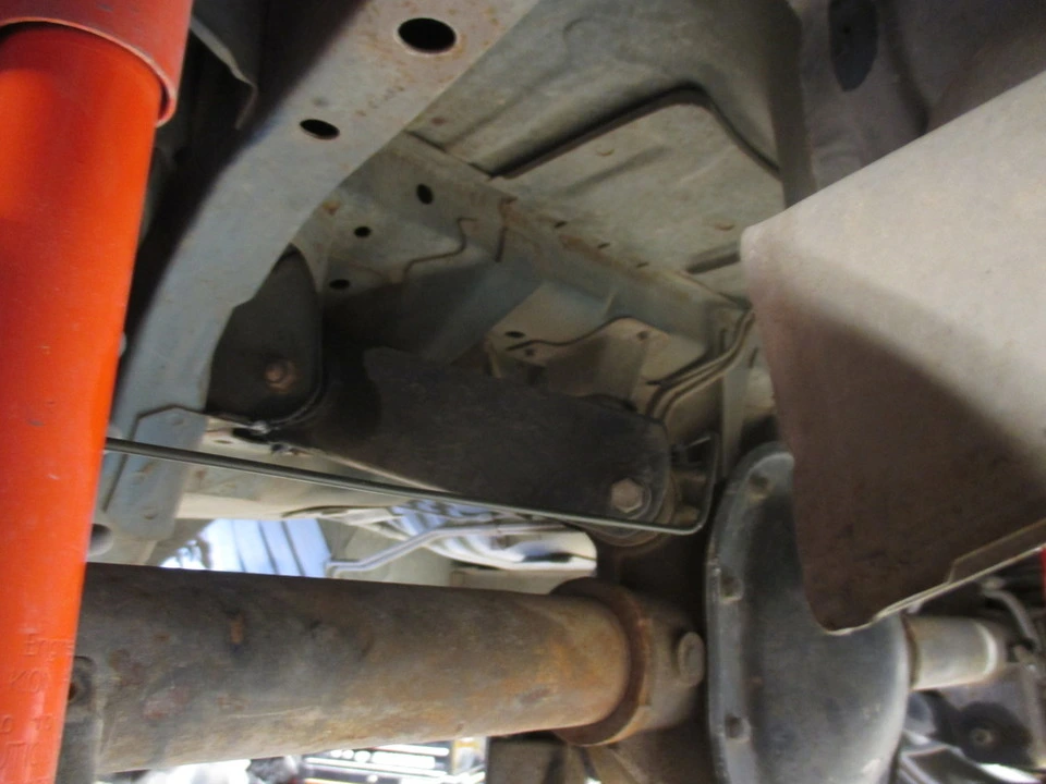

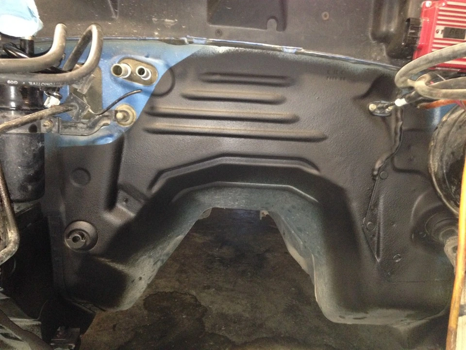

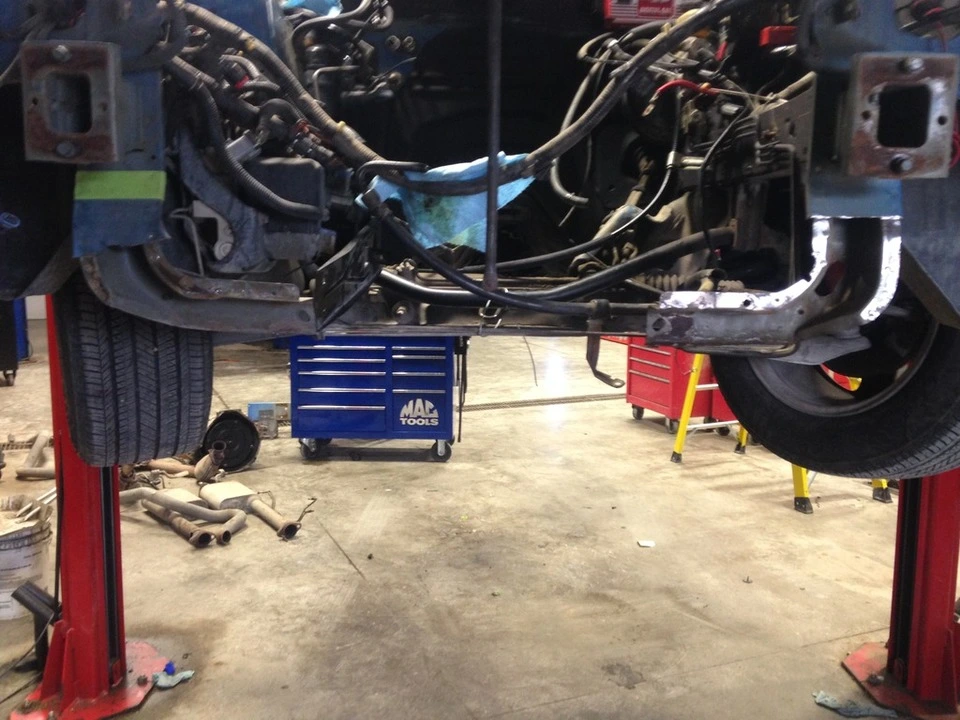

While the engine and trans are out I'm going to undercoat the underside of the car, and replace the mangled radiator support that was damaged from the PO sliding into a ditch and being pulled out with a chain.

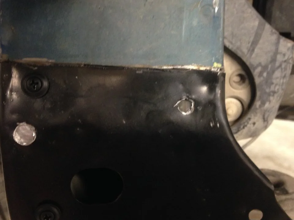

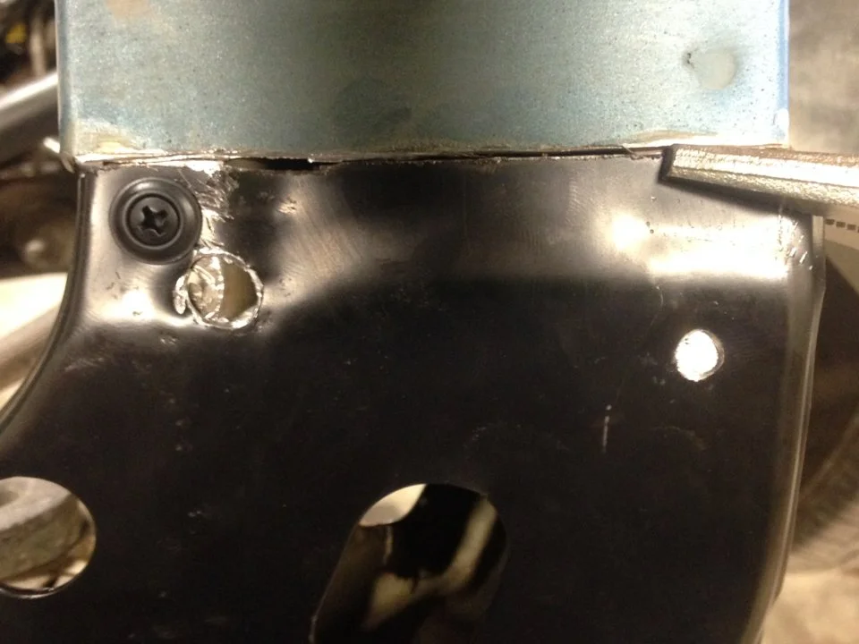

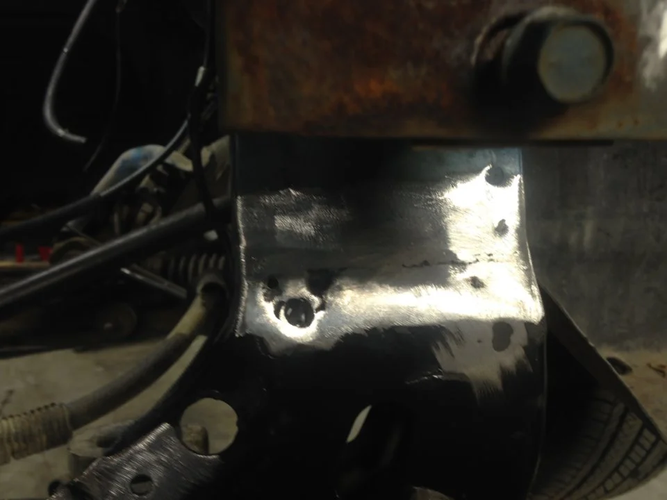

Hey everyone thanks for the comments and likes. I would have been on sooner but my laptop hard drive quite so I had to order parts and decided to buy a new laptop with windows 10. we will see if the moates programing will work on windows 10 lol. I currently on my tablet until my laptop is delivered. Anyway here is some more progress on the build. I attached the lower half of the support with 3M panel bond and then welded the seams and filled with glaze puddy. benefits of working in auto body in High School. I then undercoated the lower support and assembled it. bumper fits much nicer.

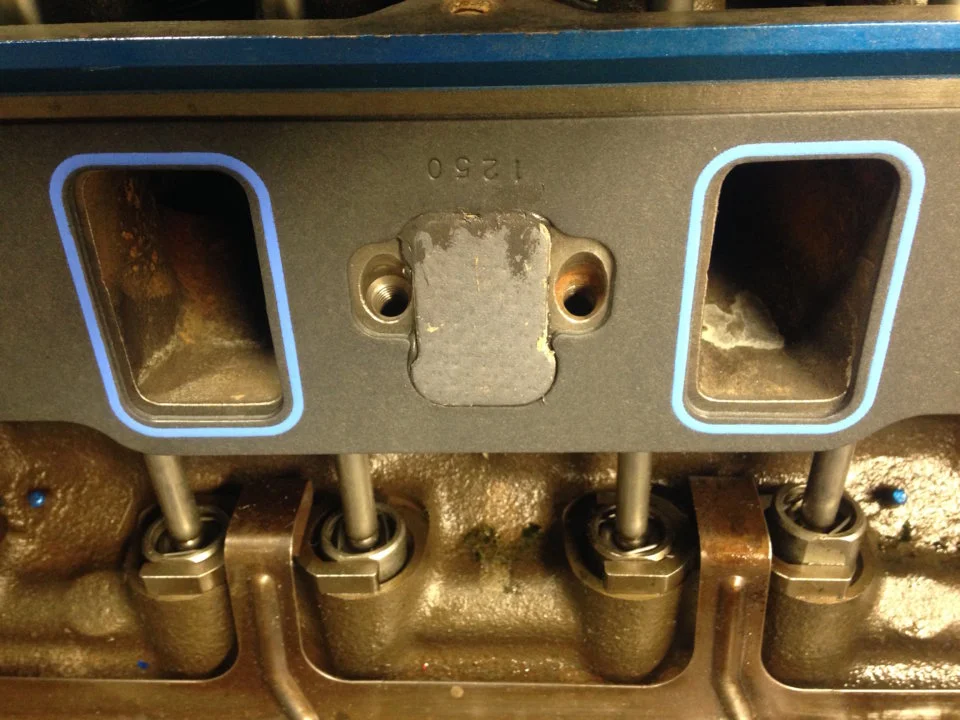

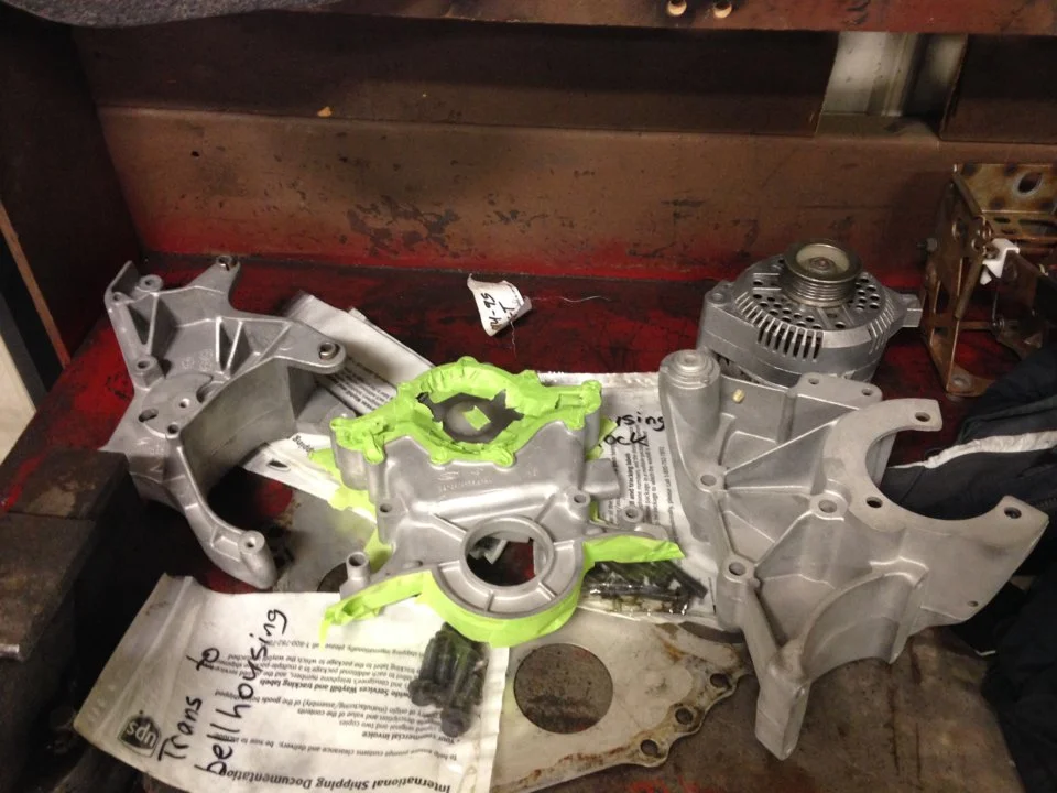

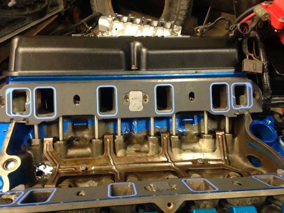

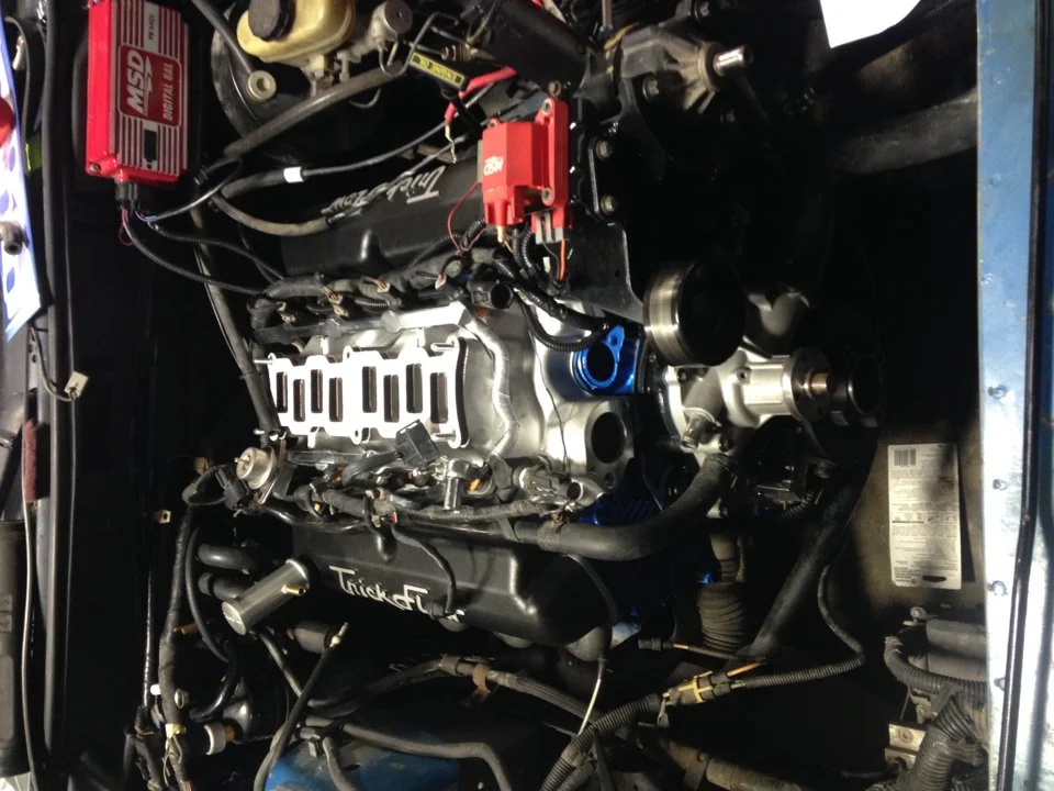

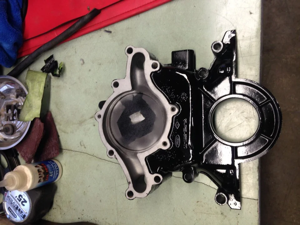

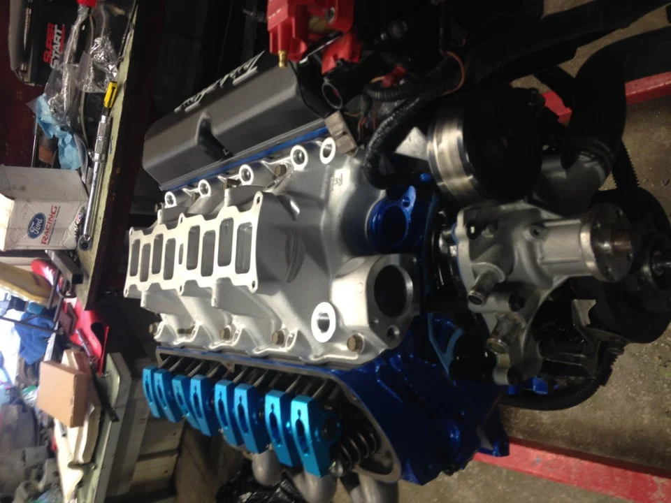

Got all of my parts/upgrades today and started assembling the engine. I used felpro 1250 intake gaskets and plugged the egr off at the heads.

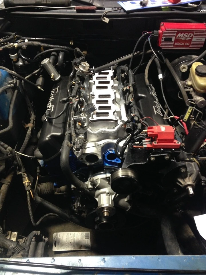

I got the engine accessories bolted on and dropped it in the car before leaving class Friday. Also reused my factory dipstick and bent it accordingly. Also if a MOD would move this to the right section I would appreciate it. Thanks in advance.
Reactions: skyline247

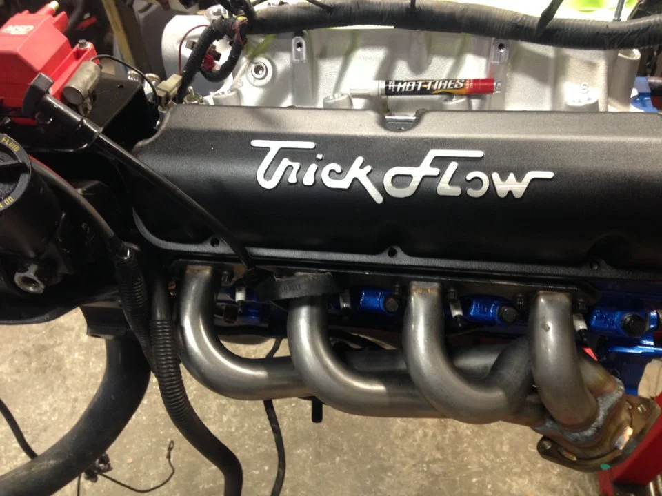

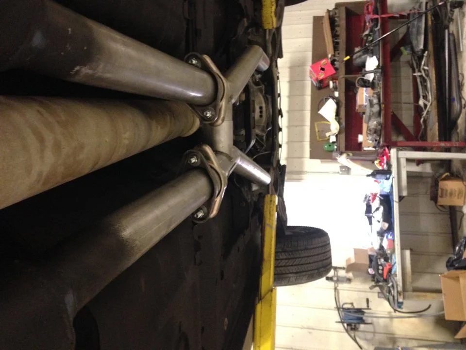

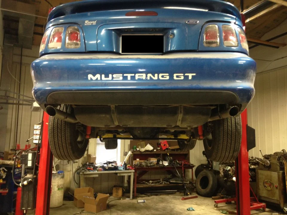

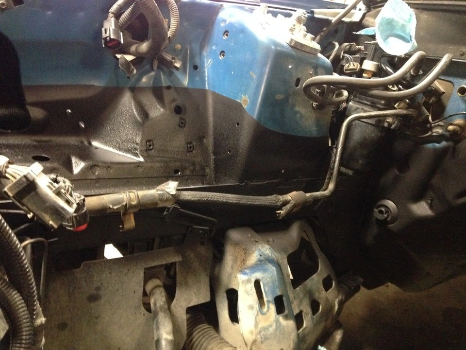

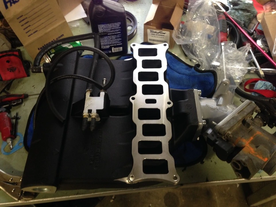

Spent the day putting in the transmission, cutting the tunnel, installing the exhaust, and fitting the intake, with the oil fill being in the rear of the valve cover. I also moved the vacuum booster supply line from the neck of the intake to under the intake to hide the line.
