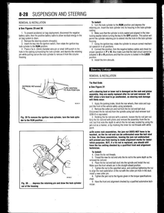

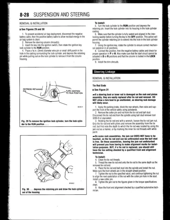

replace ignition lock cylinder see instruction below....see 1-9 under removal and installation.picture in figure #30 shows the steering wheel removed but it does not need to be removed...
