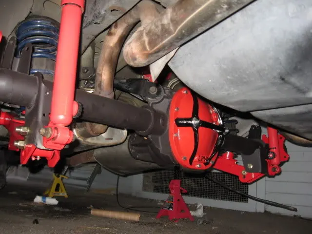

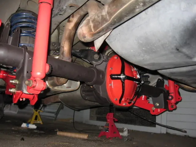

I don't have a good photo of the rear bump stop but here's the closest I have:
The bump stop is the red bit you can barely see towards the top of the photo, right above the center of the axle. Basically, crawl under the car and find where the driveshaft attaches to the rear axle. Then look straight up from there. That's the bump stop.
You will need to either replace the bump stop entirely or get a longer rubber grommet to fit in the existing bump stop. You'll still bottom out on bumps, but you'll hit the softer bump stop before you hit the pumpkin (center of the axle) on the bottom of the car.
