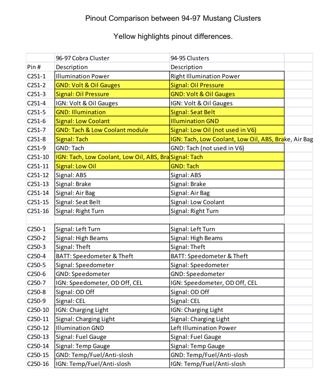

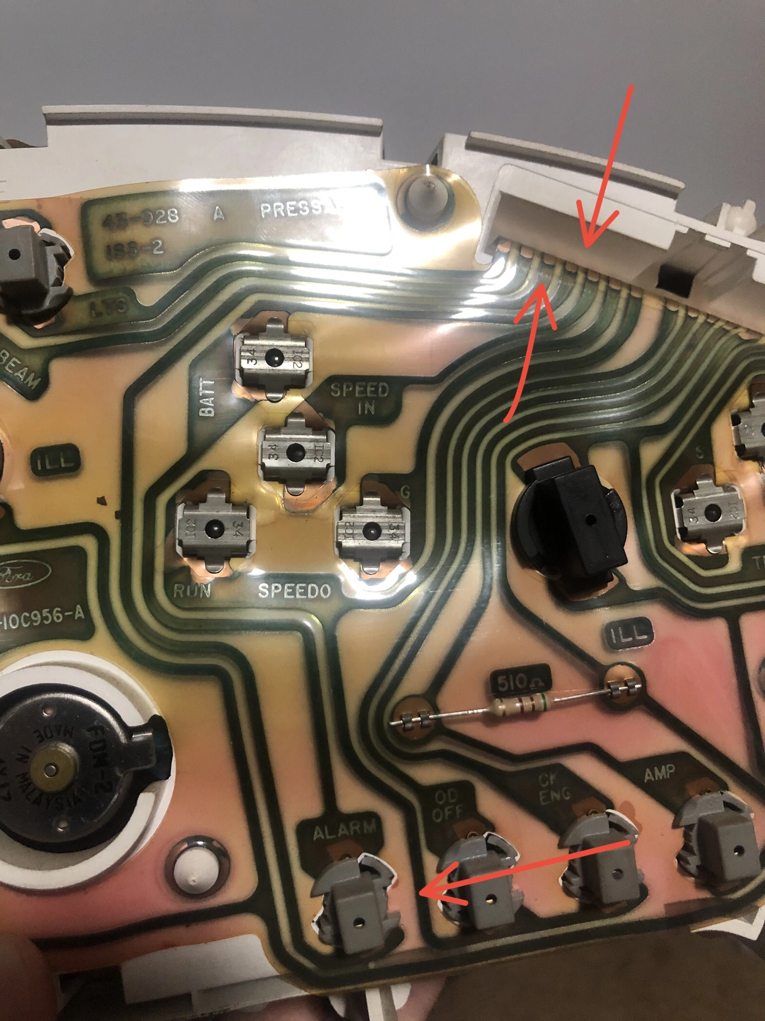

I would look at the back of the cluster on the pcb for any evidence of shorting and the harness, maybe it’s being rubbed and grounding the signal wire.
Photo below should help you out.
The Theft “signal” is #3 on the right side connector looking at the back of the cluster.
It is supplied with constant batt voltage through the speedometer, which is #4
Since you don’t have the module to send the ground signal, I would bet it’s a bare section of wire.

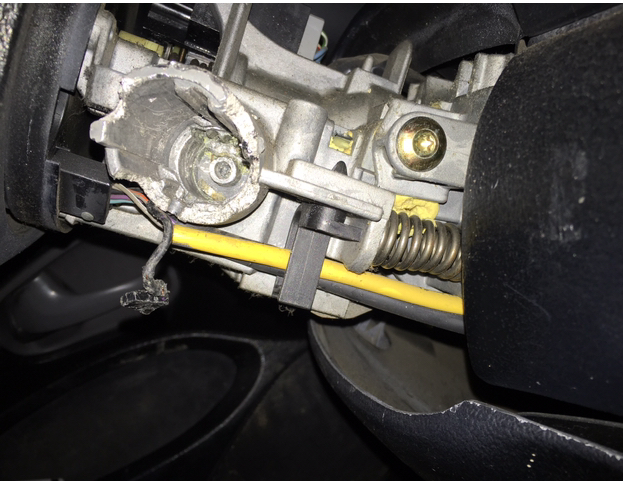

What was damaged?
He tore out the ignition and the ignition housing area. There's a broken key stuck in the trunk lock. Passenger side headliners torn out down to the metal of the roof. And other various cosmetic fixes. Hopefully I copied and pasted the link to the picture of the damaged ignition housing.
What was damaged?
You need to start looking at the junkyards for a steering column. That one looks to me like it is 100% hosed.
Believe it or not...I fixed the old ignition housing. Most of the pieces were on the floor. I wrapped the new ignition in Teflon tape and wired the housing pieces together. Then put JB Weld extra strength around the area that I had put back together informed a new ignition housing. It's been working fine for a year now.
