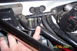

Check the vacuum lines that go to the a/c-heat control knobs. Also there is a vacuum hose that runs along the top rear of the engine bay from the vacuum tree on drivers side marked "A/C" to the passenger side to a little vacuum manifold has total of three hoses going to it. I had to replace this hose because I was having air vent issues too. Check the hose for a hole.
Here I hope this is the problem.
First pic is tree on drivers side the hose I'm pointing at runs from here the the passenger side vacuum manifold in pic two. I just used a hose I had in scraps because ford no longer carries them, according to the dealer I went to.

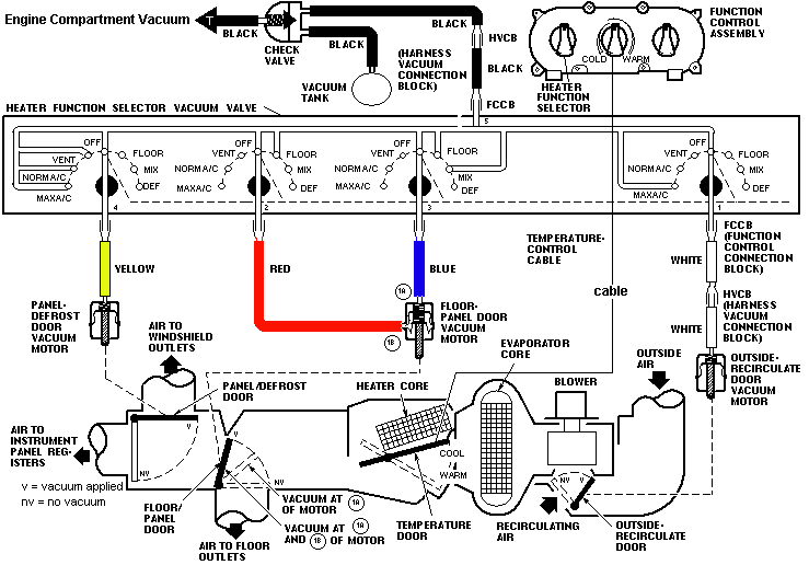

See the following website for some help from Tmoss (diagram designer) & Stang&2Birds (website host) for help on 88-95 wiring http://www.veryuseful.com/mustang/tech/engine/ Everyone should bookmark this site.
Ignition switch wiring
Vacuum diagram 89-93 Mustangs
HVAC vacuum diagram
