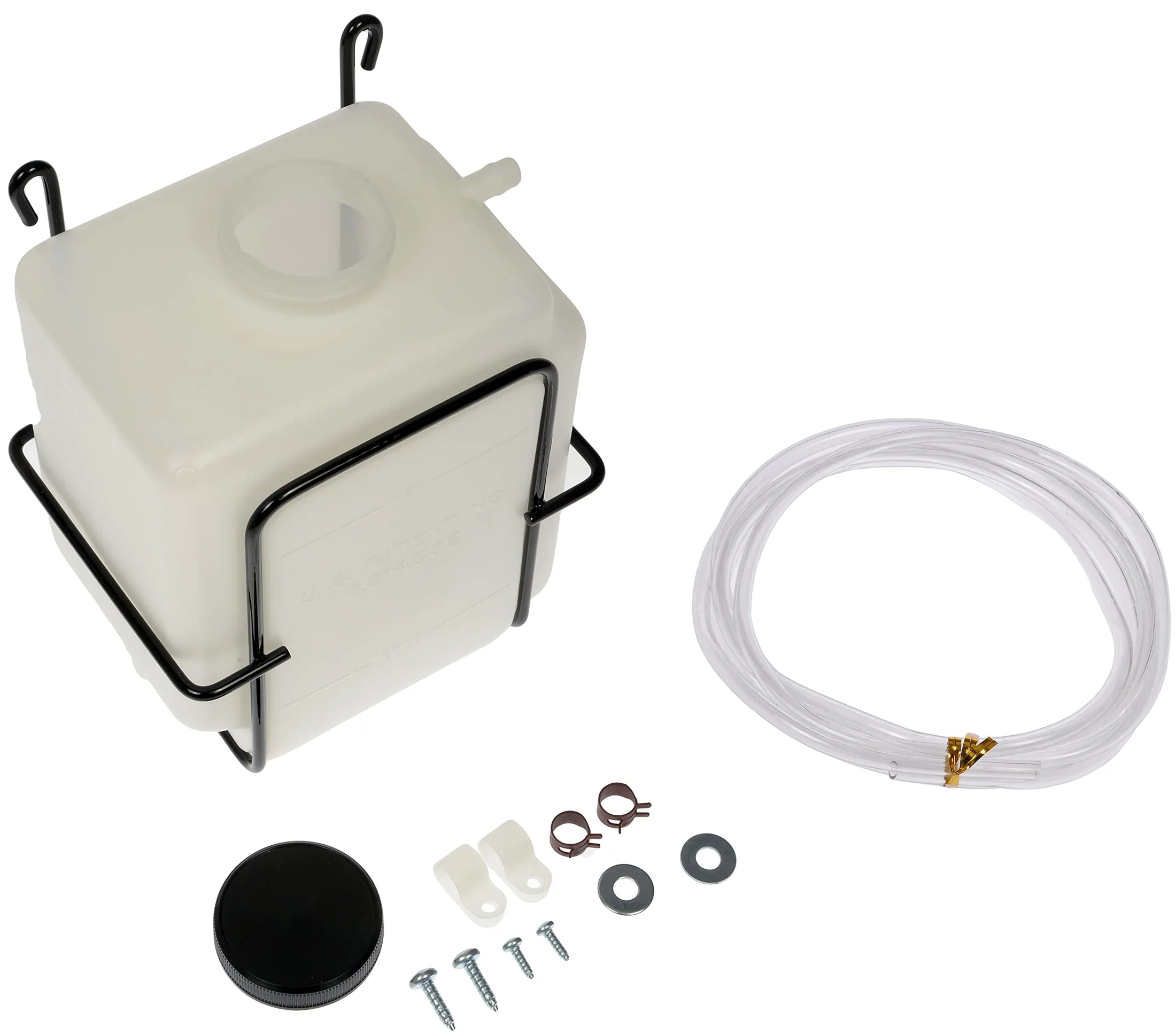

I have the Contour dual fans on my 92 and I had the same problem running the aftermarket narrow cylinder overflow tank. It was too low capacity to hold the overflow in all circumstances. Since my car has the battery mounted in the back, I had space in the factory battery tray area. In that area I mounted a larger capacity universal overflow bottle. It solved my problem of inadequate overflow capacity.
Reactions: dan50 and nickyb
The universal overflow I used is Dorman 54002. You can google that and get it various places
