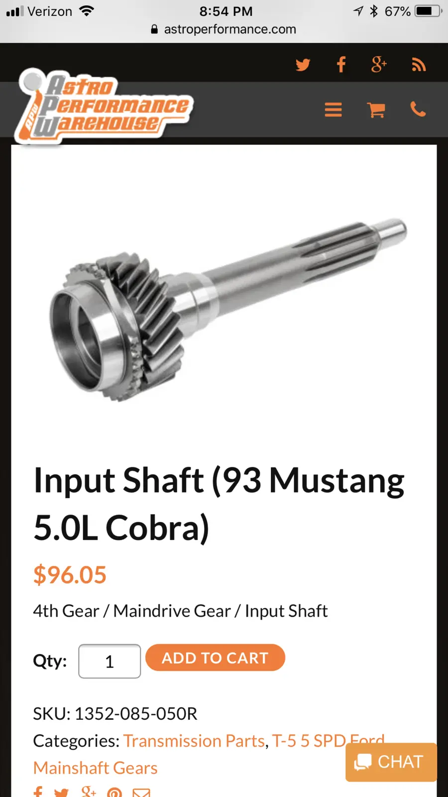

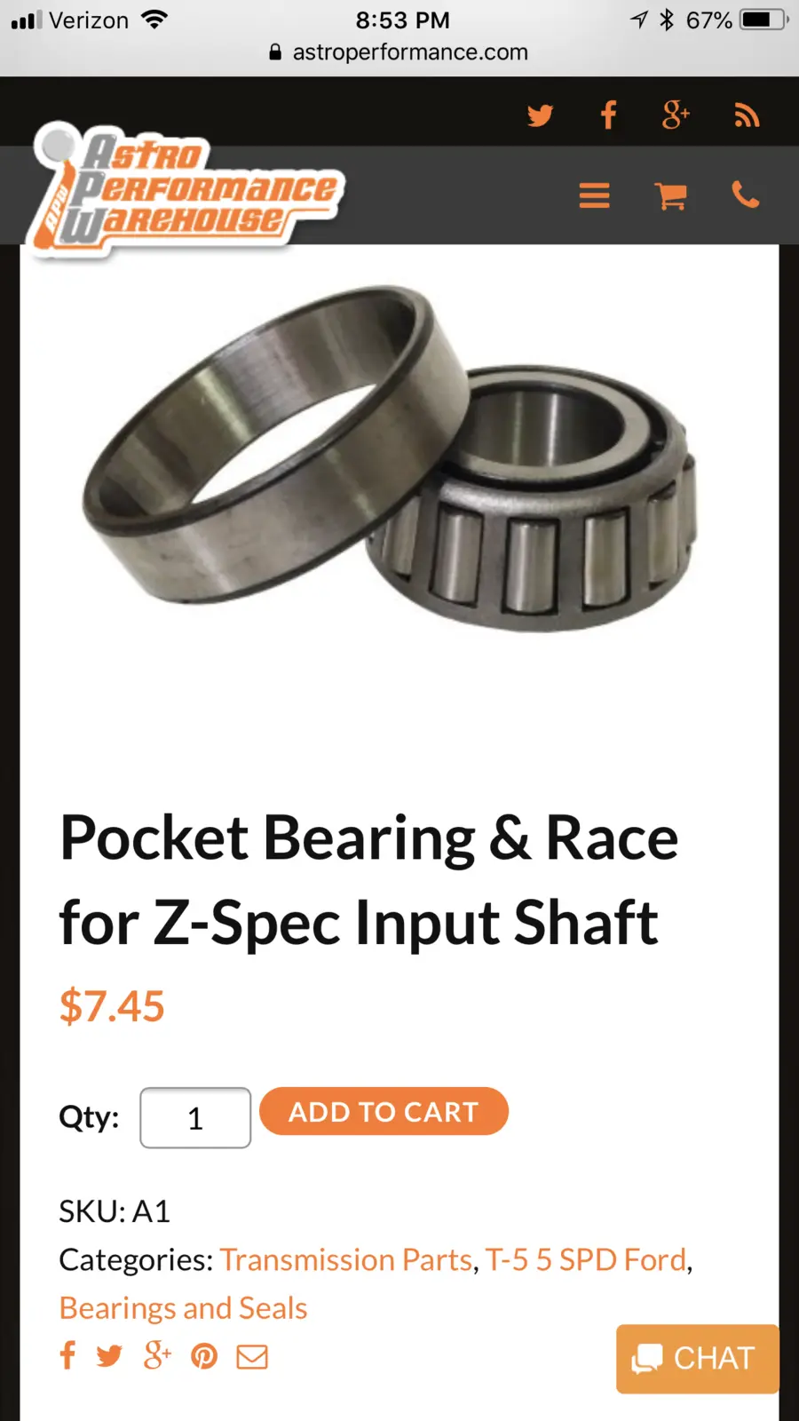

So I’m changing my mind fitting a SN95 T5 with SN95 bellhousing into my fox build. Just don’t want to deal with the potential headaches. Just going to change the input shaft and use a Fox bell. The T5z I have came from a SN95 cobra. I know they use a tapered pocket bearing instead of the needle style bearings the Non Z spec T-5s use. Would these parts from Astro be all the parts I need to do the conversion(see attached photos). Any advice would be great. Thanks.

Can you clarify a bit what you have? Do you have an aftermarket SN95 T-5Z that was installed in an SN95 cobra? Or do you have a factory SN95 Cobra T-5? There is a difference as the Cobra factory T5 is not Z spec and is a 3.35 1st gear. The gear ratios are different, which also means the input shaft is unique to the 2.95 gearset that comes in the T-5z. Can you post up the transmission ID tag numbers?
I believe this is the input shaft that would be needed for a T-5Z with the 2.95 gearset and pocket bearing to be run on a fox.
https://www.astroperformance.com/product/input-shaft-24t10-spline/
BUT, I would defer to calling and speaking with astro performance, as well as clarification as to the trans you actually have on hand. That input shaft is not cheap, so you definitely want to get the right part here.
You also need to either shorten the SN95 throwout bearing retainer, or purchase this
https://www.americanmuscle.com/ford-t5-retainer-8393.html
The bearing is a a1 part number bearing. It is the same as the one pictured.
I've replaced Tomas of them with overt the counter federal mogul a1 bearings from the local parts stores. They usually run between 4 and 6 bucks.
I usually deal with Hanlon Motorsports or the Gearbox.com. Most of them will go by tooth counts. Meaning....you can count the teeth on the one you have and match it to the proper one.
Mustang5L5 is right....two different ratios so you must be sure before ordering.

Remember that 94 - 97 T5's have a longer input shaft (about 11/16” longer) and can only be used with a 94-95 bell housing unless you modify or replace the input shaft.
Wow. Never knew that. I always thought 93-95 Cobra equipped T5s were Z spec. Thanks for clearing that up. Checked for the ID tag. Gone of course. The transmission came from a SN95 Cobra. I personally saw the car he pulled it from. He said it was rebuilt to Z specs, but who knows. I guess I should just pull the input shaft first and count the teeth before I order one from Astro Performance.
I don't know if anyone still reading this thread but I have info on this..t5z wasn't ever in any cobra but the cobra t5 is different than the mustang t5.. cobra t5's have the same shifting forks as a t5z but cobra shift keys are still plastic the t5z are bronze my 1995 cobra has a 2.95 first gear along with hardened gears (I have it apart here in front of me) so just wanted to say the cobra t5's are not t5z's but they are not a regular t5 that is in the gt's cobra trannys are somewhere between t5 an t5z
