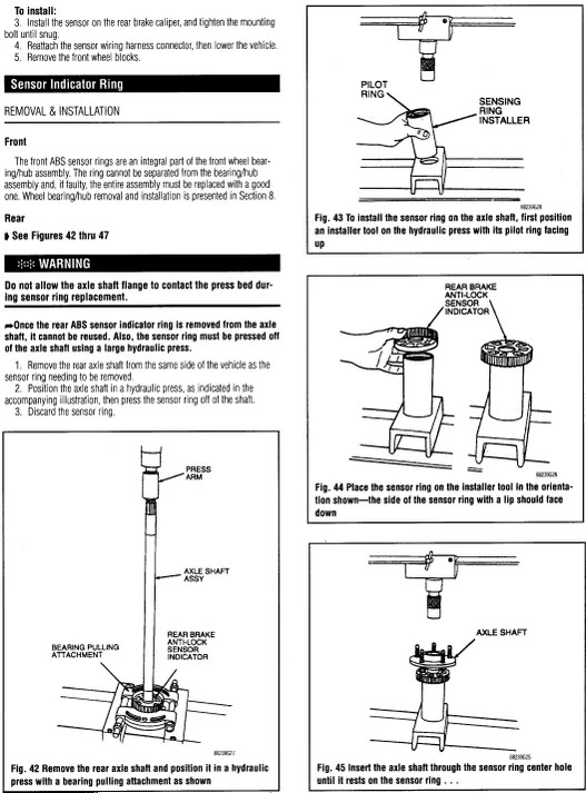

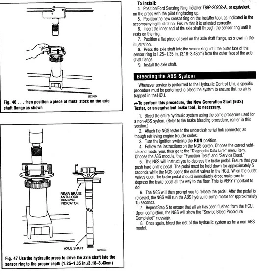

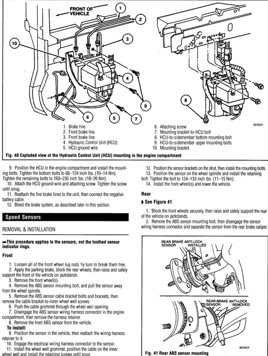

mike is correct x2 and heres some more info....
