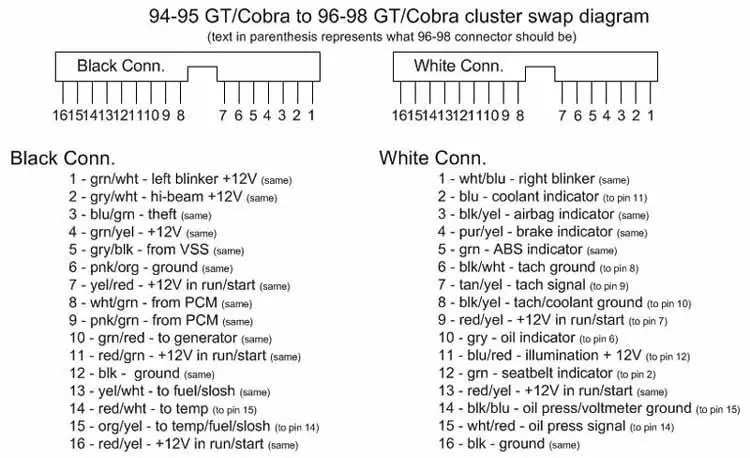

hi i was wondering if anyone had a pinout diagram of the pins you need to switch so the 96 gauge cluster will work in the 95, i know its been done before someones gotta have a diagram layin around.
any help would be great thanks :nice:
I know I'm not the only one with this diagram, since doobie contacted me I'll post this for the millionth time. Hopefully some one will save it and actually share it. Use at own risk
