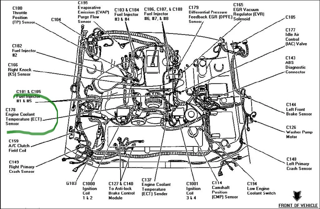

Any idea where the temp sensor is for the fan? Does the ECU need to trigger the need for high speed fan for the CCRM to have power at the wire? Or does unplugging the temp sensor do that for you?
Appreciate your help
Im pretty sure it’s the sensor I marked on this pic-
The sensor triggers the ccrm,but unplugged it “Should” default to high speed. Fingers crossed I’m actually helping ya lol

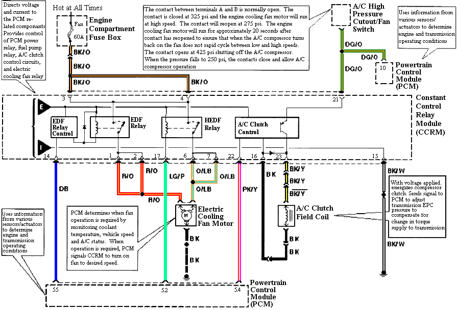

Damn straight they run hot. Scary if you are looking at the gauge. The ones that have a CCRM simply run 9 volts to the fan for low speed then switch to 12 volts for high speed. Just check the voltage to check the high speed function. Some early ones like your 96 has a ballast resistor in conjunction with a stand alone fan relay attached to the fan shroud and had no CCRM. They test the same way. The ect drops to roughly .4v when it gets above about 218 degrees F and the processor requests fan function (turns on the fan). I have watched hundreds of these with a breakout box on the ECT wires waiting for the fan to come on while monitoring the voltage with a DVOM

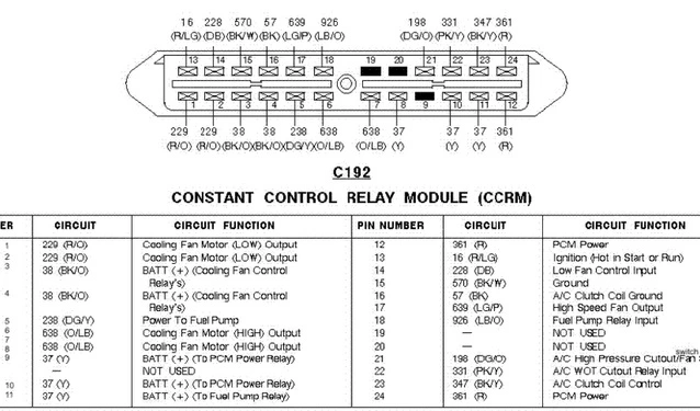

In the past-for me-unplugging the sensor while the fan was running netted me some high speed action-but I mighta just got lucky-as mentioned above-ccrm’s tend to be the culprit- you can goto the pins on the ccrm if checking the connector at the fan or beating on the fan does not answer much-
That ccrm pin out may not be the correct one for your car-it was a quick google-fu search :shrug:
