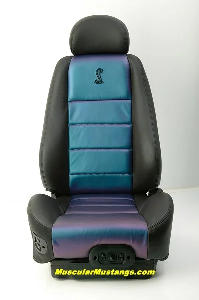

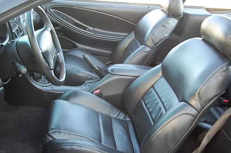

Thanks I saw in the squeaky wheel about the thread and checked it out. I guess one of my concerns are is the seats going to look like mine now with just the insert area being mystichrome inserts or will they look like the 03-04 covers just with my foam. Take a look at the 2 pics below as the top is the 96 interior and then obviously the 04 mystichrom seats. See how there are less lumbar support areas to be the inserts? Just wondering which one it would look like.
Sadly TMI doesn't make the Cobra/Mach 1/Bullitt foam for the 96-98 cars as their frames won't support them. Best you can do is rebuild the stockers, or find a set of 99-04 frames and buy the Cobra foam and covers.
Also, the 96 Mystic color is very different than the Terminator Mystichrome color so the mystichrome seats likely would look out of place.
I knew the color wouldn't match specifically but talking to TMIproducts I thought I would've able to do this. Hmm
Hey - N8 is correct, the 03-04 foams will not correctly fit your 94-98 frames. What were were discussing (and maybe it got mixed up) was simply taking the NOS Mystichrome material and using it for the insert on the stock GT 94-98 Seats - now THAT I can do. But it would be over our reproduction stock GT foams - unless (dun dun dunnnn) you can find ANY 99-04 seat frames from a salvage yard. Either the V6 or the GT frames will work to transform into a true Cobra seat.

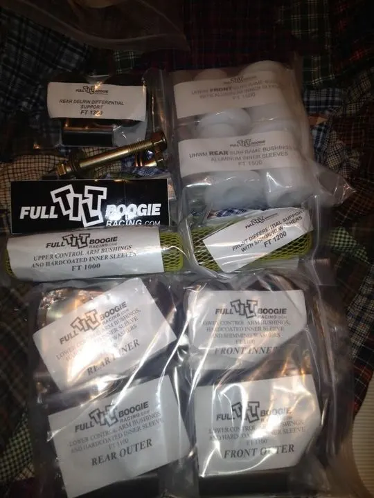

I will have some major changes coming in the next month or so. Here is just a teaser pic of some of the parts going into the car:
Told myself when I started this project I wouldn't have-ass any of the pieces I wanted to add.. When I finally get the IRS in the car it's going to be a Picasso that's for sure! Don't want to ruin all the fun but give me a few weeks and I will have pictures on here. IRS is sitting at a shop currently to get the bushings installed along with other stuff too. Stay tuned!
Very nice. I'm on the same boat and actually have what you pictured above sitting in a box right now. Its hard to have the IRS just sitting around and forcing myself to hold off on putting it in until I have exactly what I need to make it bullet proof. So much $$$$$$$$

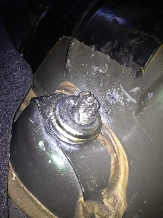

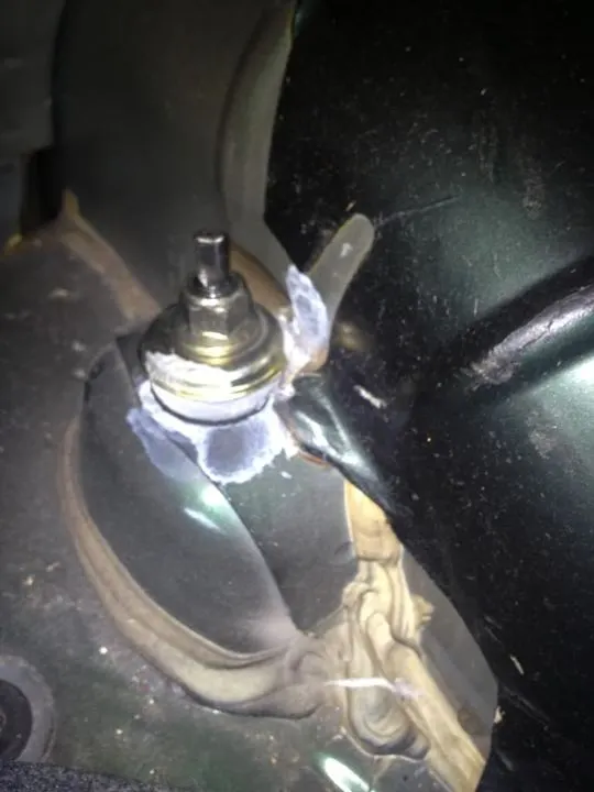

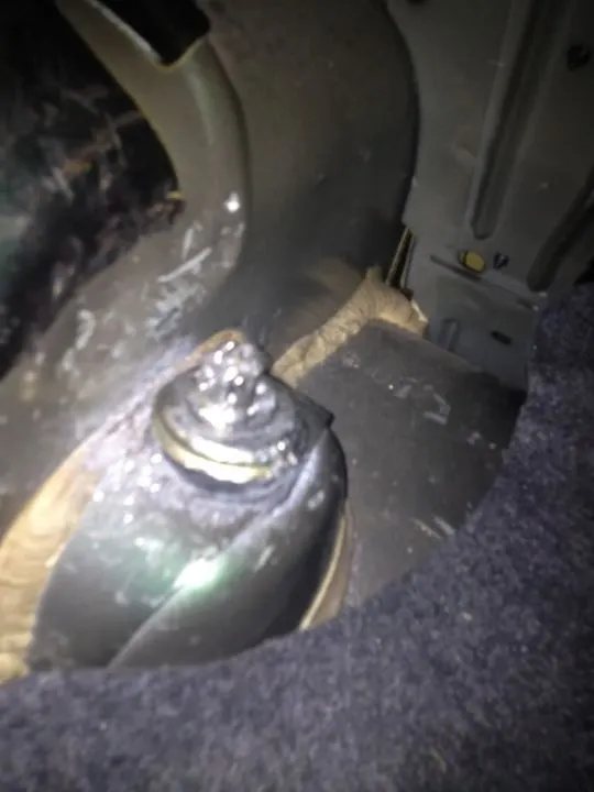

Found a hidden problem with the car today. Not installing the IRS just yet as it is still getting goodies thrown at it before install, but this little problem is going to be something I will get to address at that point:
Passenger side shock tower:
Driver side shock tower:
Why, why, why...
Any ideas how to fix this?
