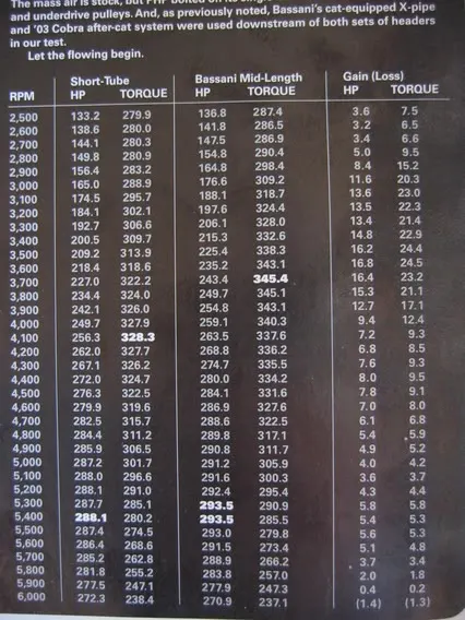

As for the headers , I'm banking on the Bassani Mid-Lenghts for their ease of install. and the best of both worlds in HP (to shortys and long tubes)

thanks for the help. Ya the whole computer flash thing i need to get figured out. i need to find what chips will do it or who will do it. So those headers don't require the engine to be lifted to be installed? or to remove the stock exhaust manifolds?
