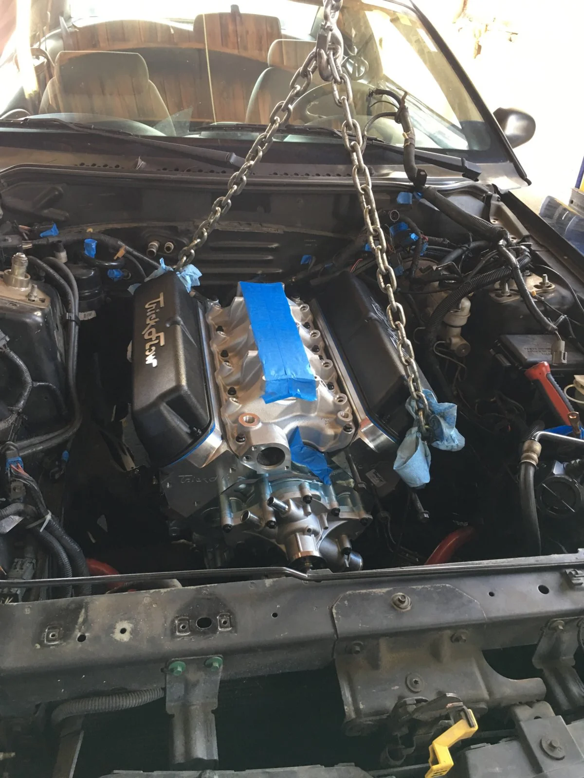

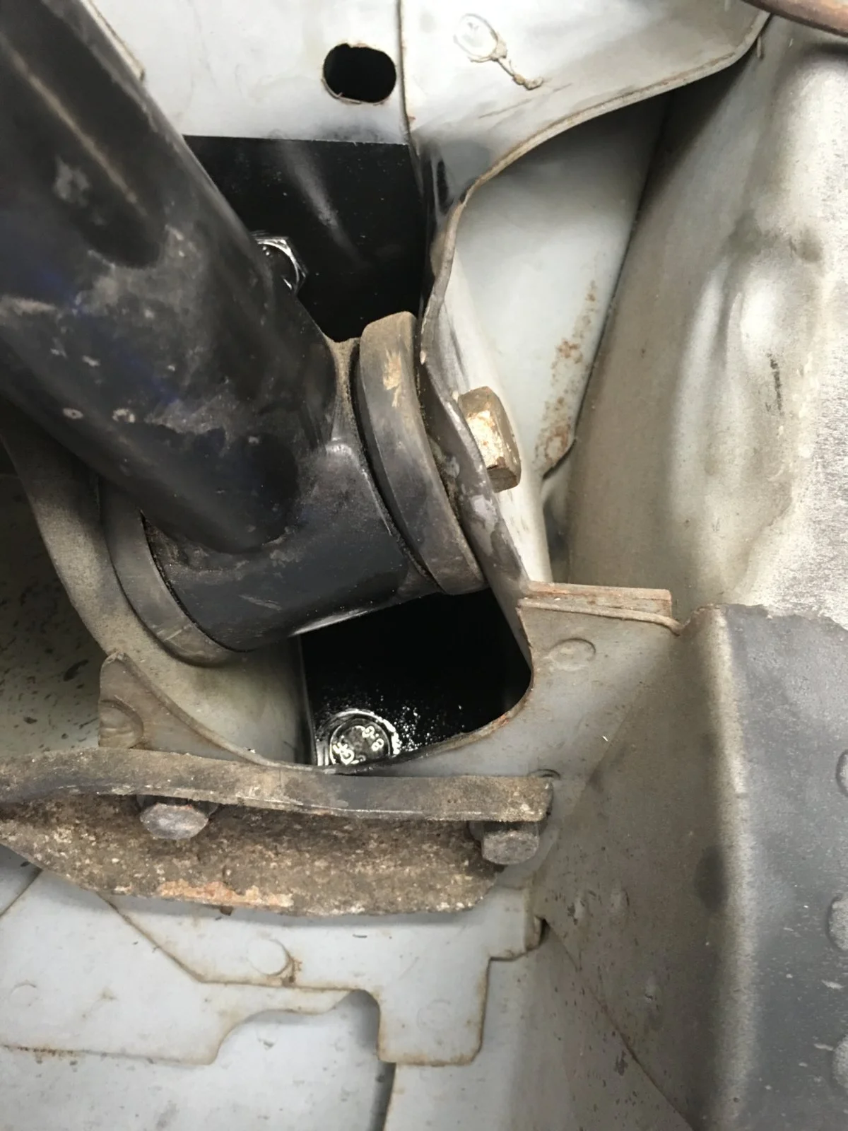

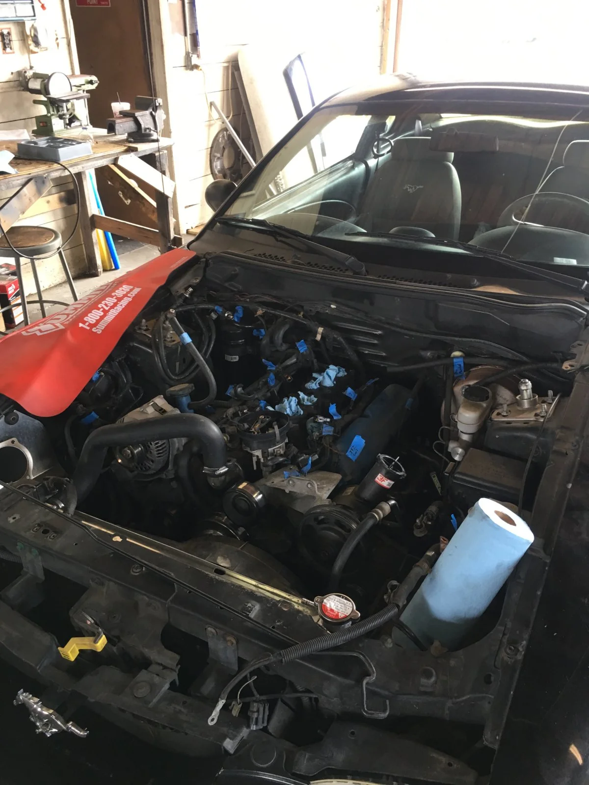

Hey all,

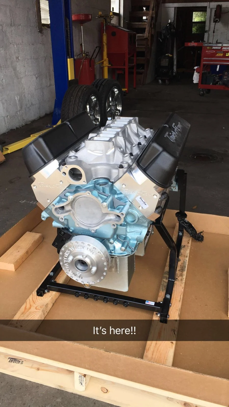

I’m beginning my car build today. Got a 347 from fordstrokers, big shout out to Woody and Nicole. I wouldn’t want to go through anybody else.

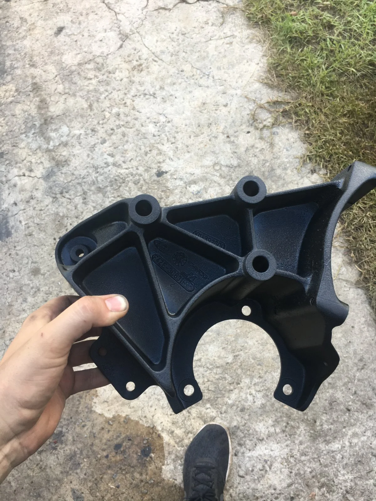

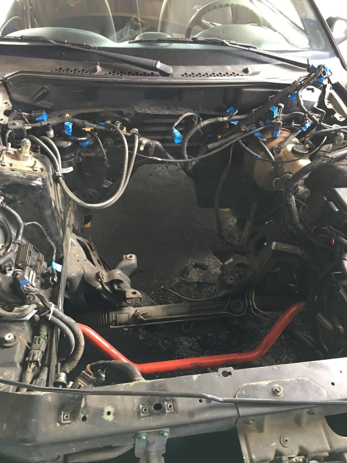

Car is a 96 v6 model that has been set up for a 302.
Car will have an Astro a5, which I have already picked up.

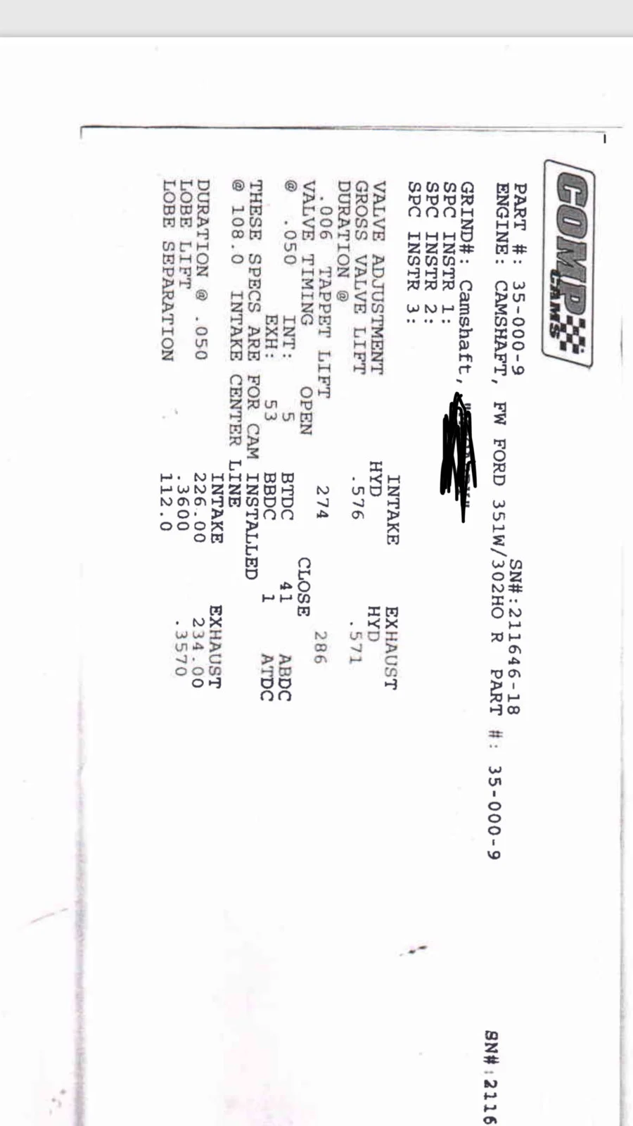

Engine is a dart block, trickflow 205 11r, Callie’s crank, scat h beams, wiseco pistons. Built to handle some good power.
I’ll be updating as often as I can.
Edit:: Cars almost done.
