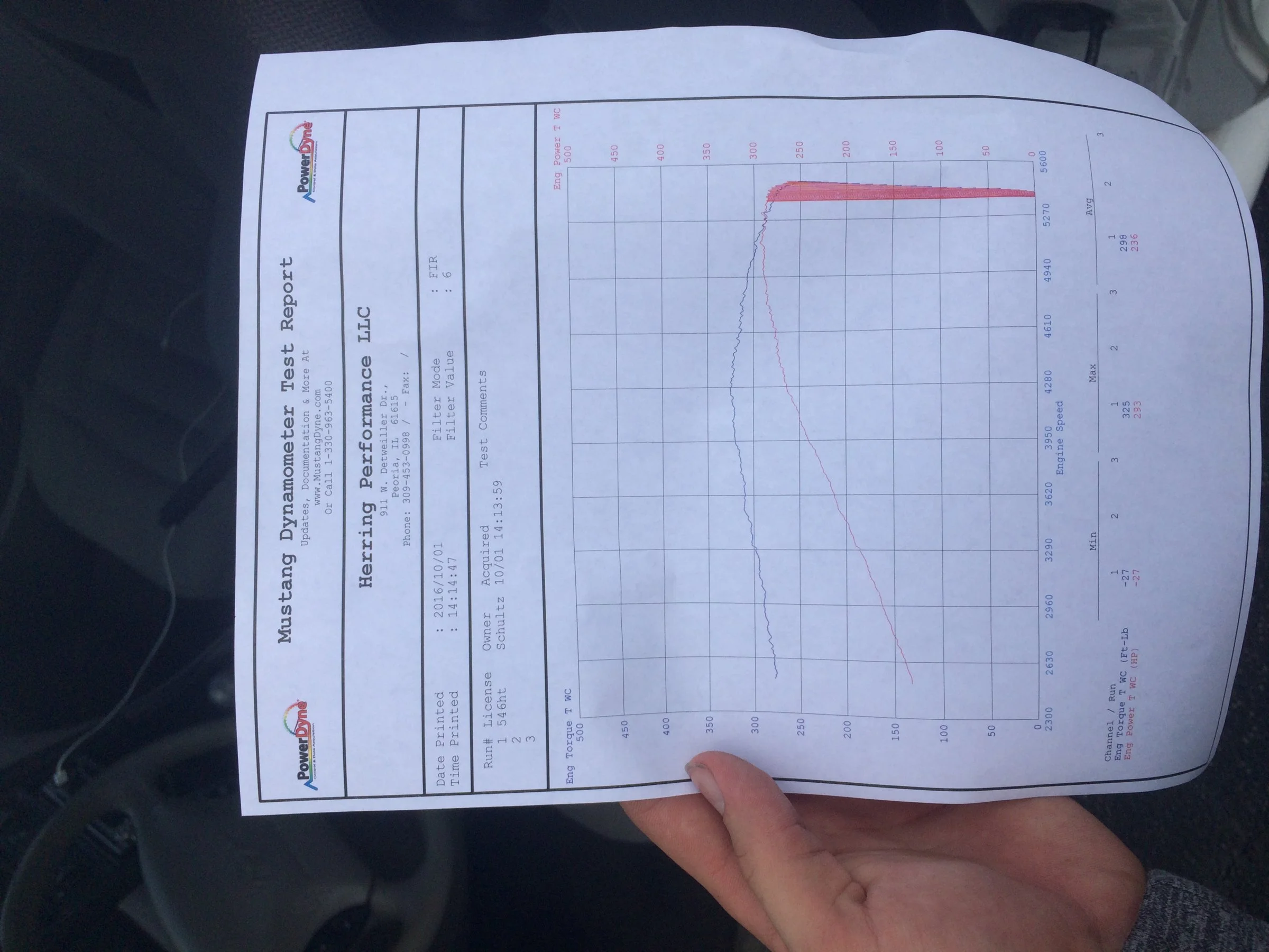

You can reach 300 rwhp. I took a stock 96 gt engine. Threw on cat back exhaust, cut out the cats, LTs, full K&N CAI, 75mm throttle body and plenum, then lastly did the full PI swap. Did a couple pulls on a Mustang dyno (they read low) and got 298 hp and 322 tq. That was no tune and just running on 91 octane pump gas.

I lied it was 293 hp and 325 tq
