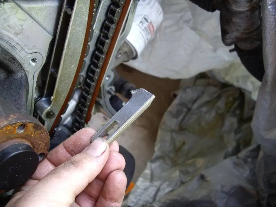

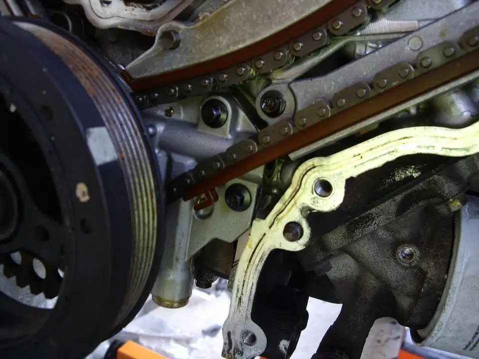

Now there is another thing that makes that sound. Its bad rails or tensioners on the timing chain. You can check that by removing the acc bolted to the timing cover and the crank pulley and inspect it.
I have had a similar sound and this is what I found:
