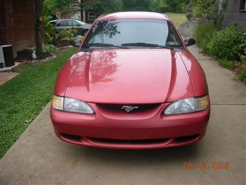

Hi guys I have been looking at buying a used Mustang for a while now and came across a 98 GT with a paxton novi-2000 supercharger in it. the car has 92,000 miles on it very good cond inside and out other than the bumpers fading from the florida sun. is 6500 a good price for this and does the supercharger cause alot of engine damage. I never had a car with this set up and should it be preety noticible when driving and will it kill my gas mileage.

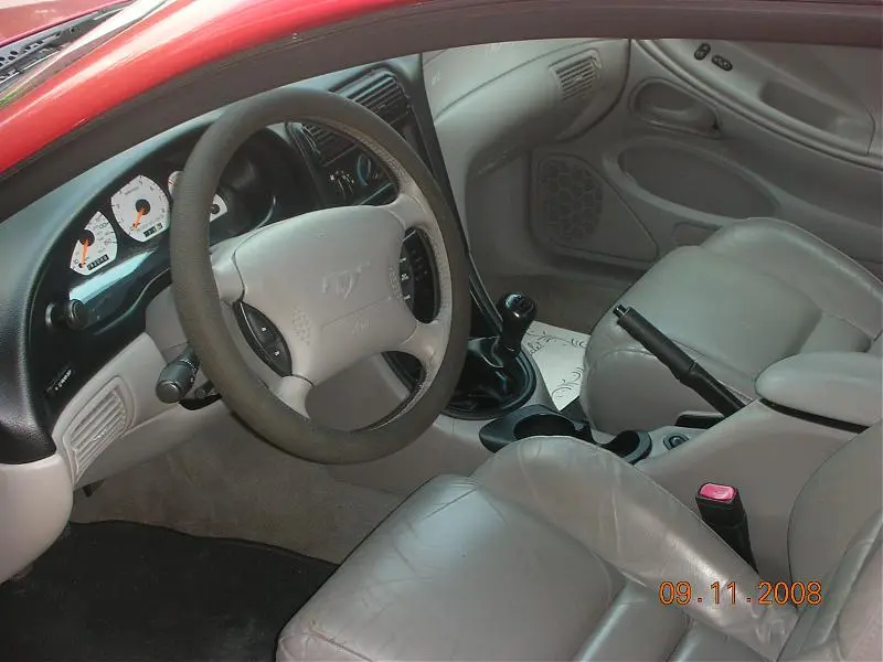

To the OP. Buying a supercharged car isn't going to be a turn the key and forget type of car. It will require more insight into tuning and keeping it operating properly. If you aren't familiar with tuning a supercharged car, i wouldn't buy it. From the looks of things, it appears to be a stock car with a blower slapped on. I don't even see any boost gauges or any other blower support equipment.

After reading this thread I am alittle scared of this car. It don't have any guages inside for the supercharger, I can get a decent deal for the car, would I be better to yank the supercharger off and go back to the stock setup?
