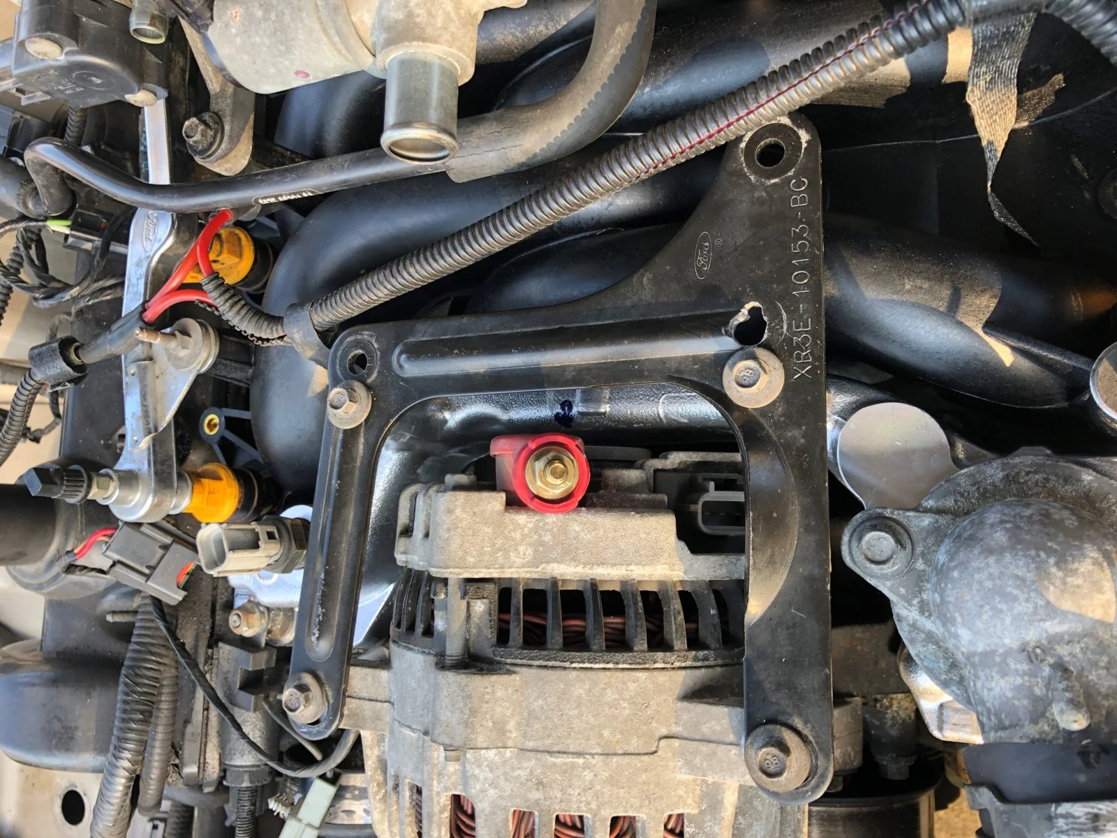

I had to modify the alternator bracket further. Since the bracket attached behind the plastic crossover instead on the aluminum crossover the bracket pushed the alternator forward too much and I feared it would stress the belt too much so I had to add two more holes. It looks horrible so I ordered a new one for 02-04 GT.
