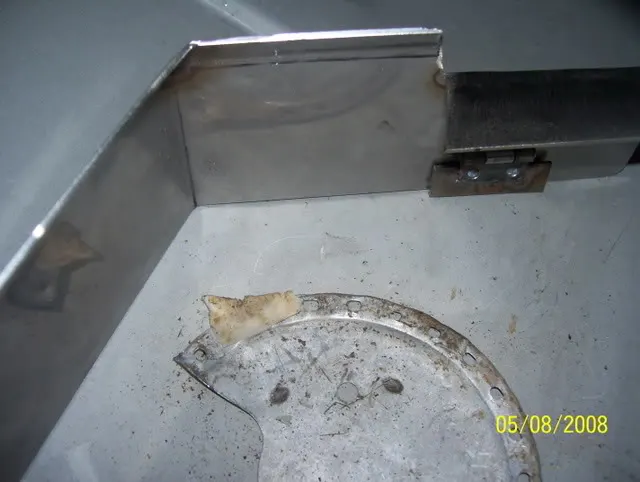

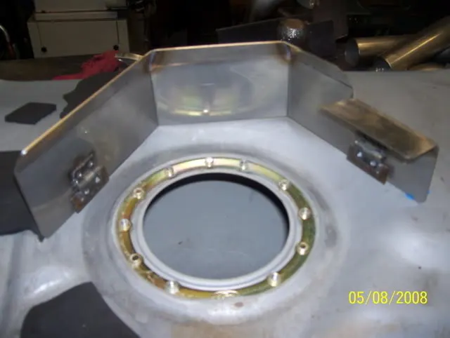

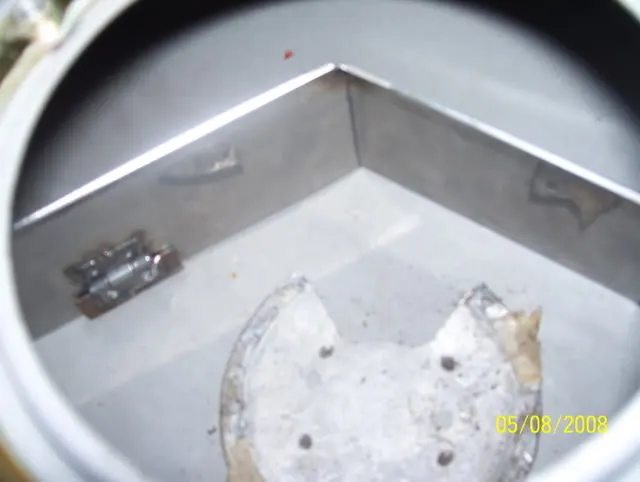

It is almost done. What you can't see will have a trap door on both sides. It is laser cut stainless steel and it fits through the top hat's hole. I will be running this in my car. The tank in the pic is a old tank I had for mockup. Let me know if you are interested in having one. It will be a lot cheaper than having to buy a 03-04 cobra tank. It will also keep you from having to run a sumped tank with noisy external pumps. I will have pics of it installed in my tank in a couple weeks.
