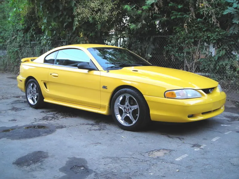

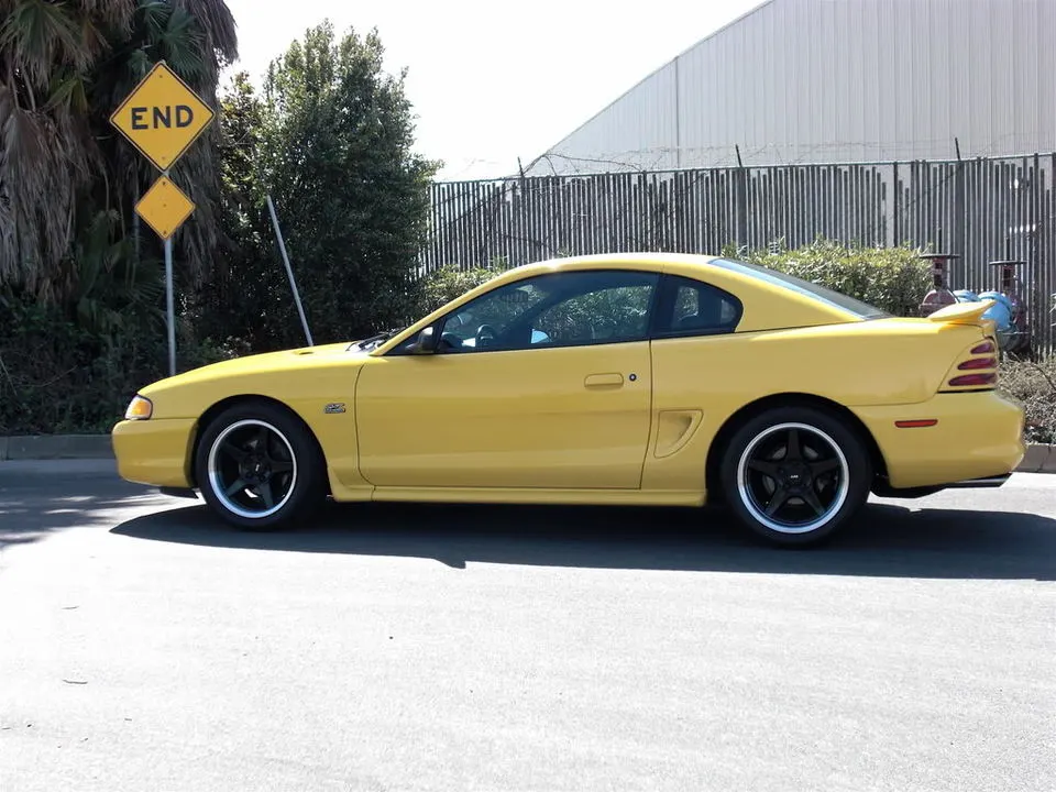

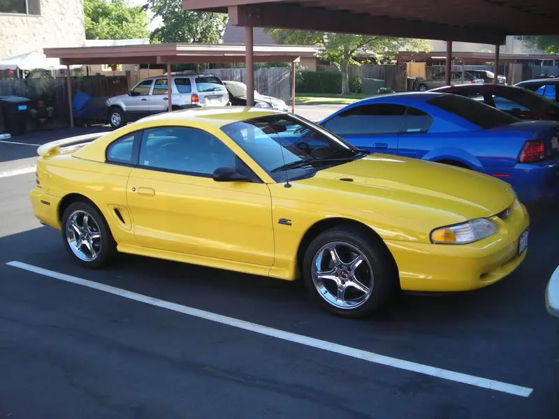

Here is an example of an H&R SS drop on my 95 GT....
Stock height...
lowered...
with the current wheels....

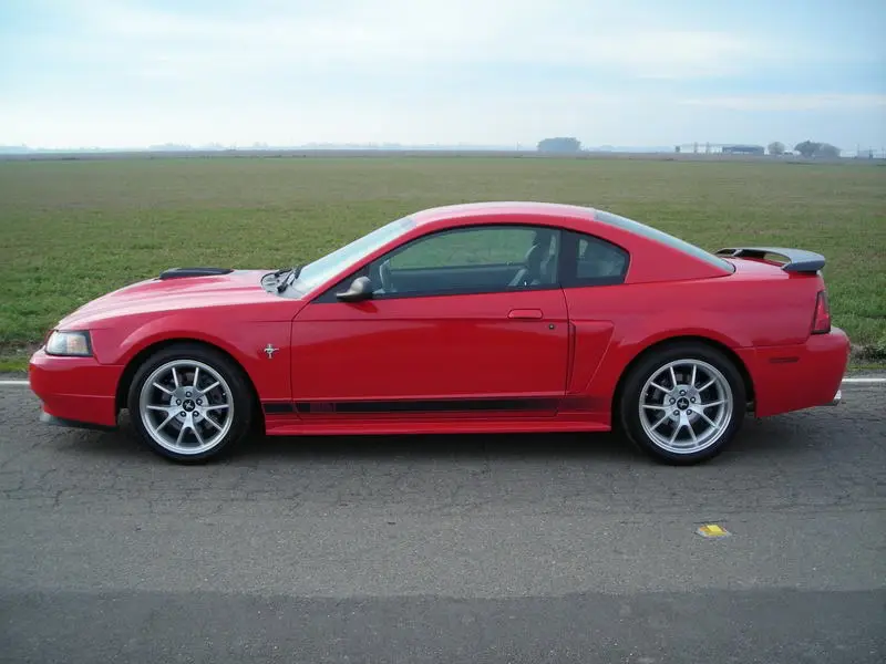

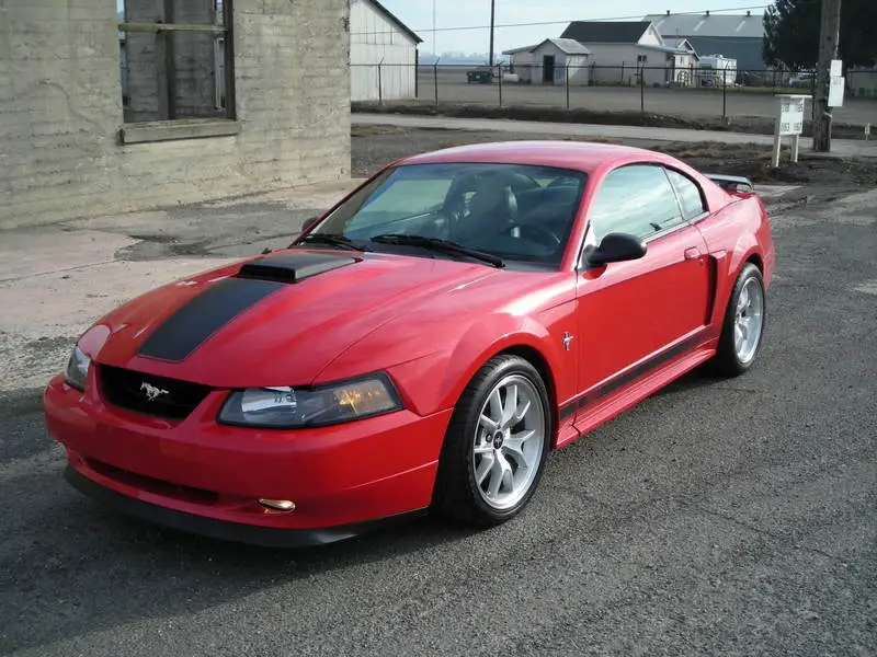

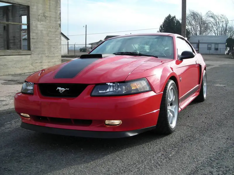

Here are old pics of my Mach when it was lowered on H&R SS's....
