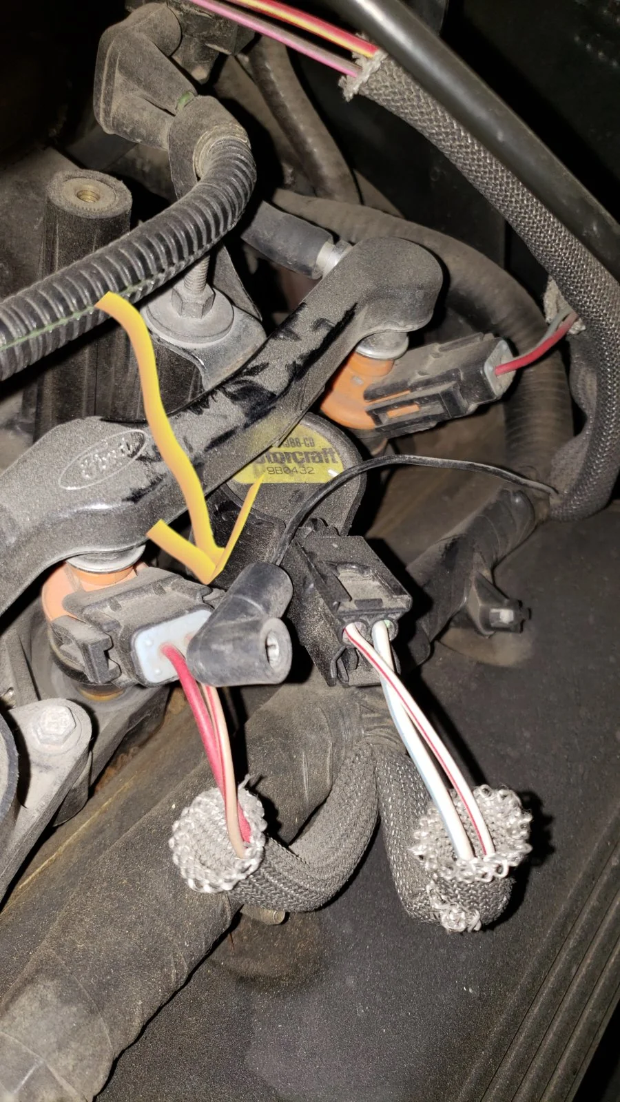

Tk469 New Member May 29, 2018 5 0 1 Bellevue Nebraska May 30, 2018 #1 May 30, 2018 #1 Found a wire unplugged on my injector harness, any ideas?
wmburns SN Certified Technician Aug 14, 2009 5,892 514 204 Houston Texas May 30, 2018 #2 May 30, 2018 #2 It's a grounding wire for the fuel rails. It's purpose is to prevent the build up of static electricity caused by the flow of fuel inside the fuel rail. It goes on any fuel rail stud. Last edited: Jun 9, 2018
Tk469 New Member May 29, 2018 5 0 1 Bellevue Nebraska May 30, 2018 #3 May 30, 2018 #3 Cool cause that's where I put it. Thank you!
