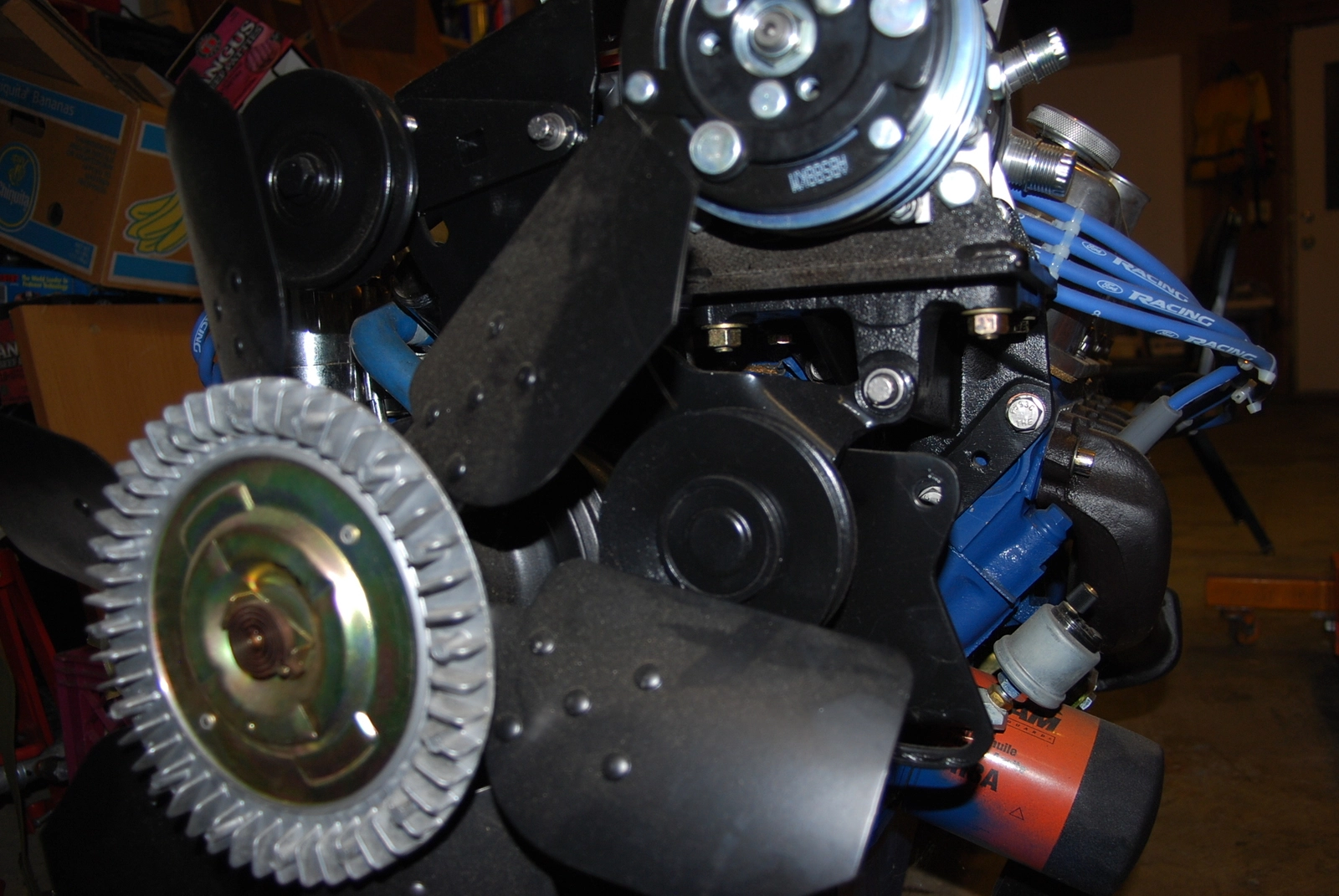

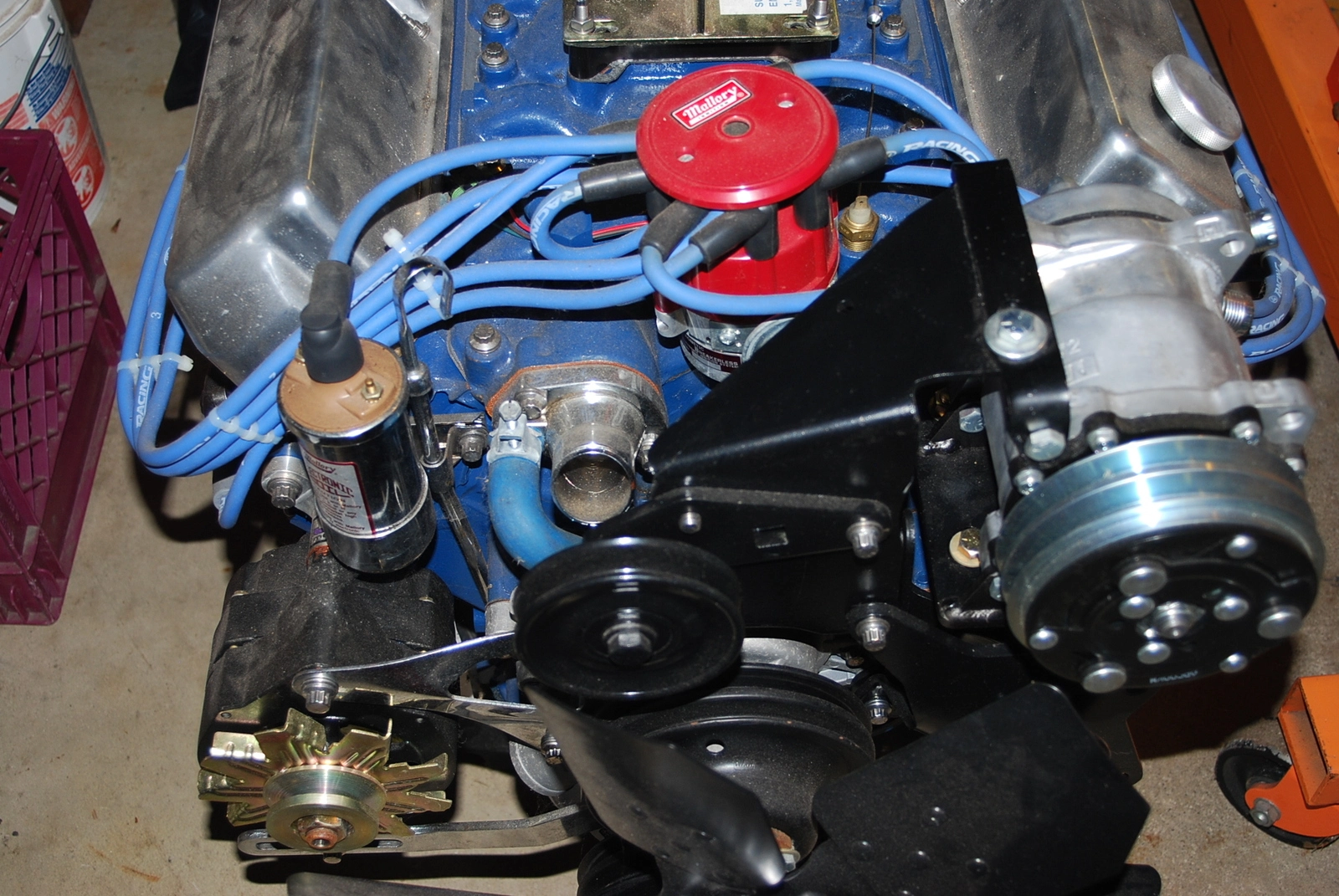

Also, does the original belt style tensioner work with this updated system?
I'd give the guys at classic auto air a call, when I called about my original air system, the guy I got was the one that wrote the installation manual for their perfect fit system, and he also knew a lot about the stock system. Didn't try to upsell me, and ended up helping with what I needed to repair my original ac, and upgrade to 134a.
And on the question about tensioners, you should have a fairly similar setup to mine, so yes.
