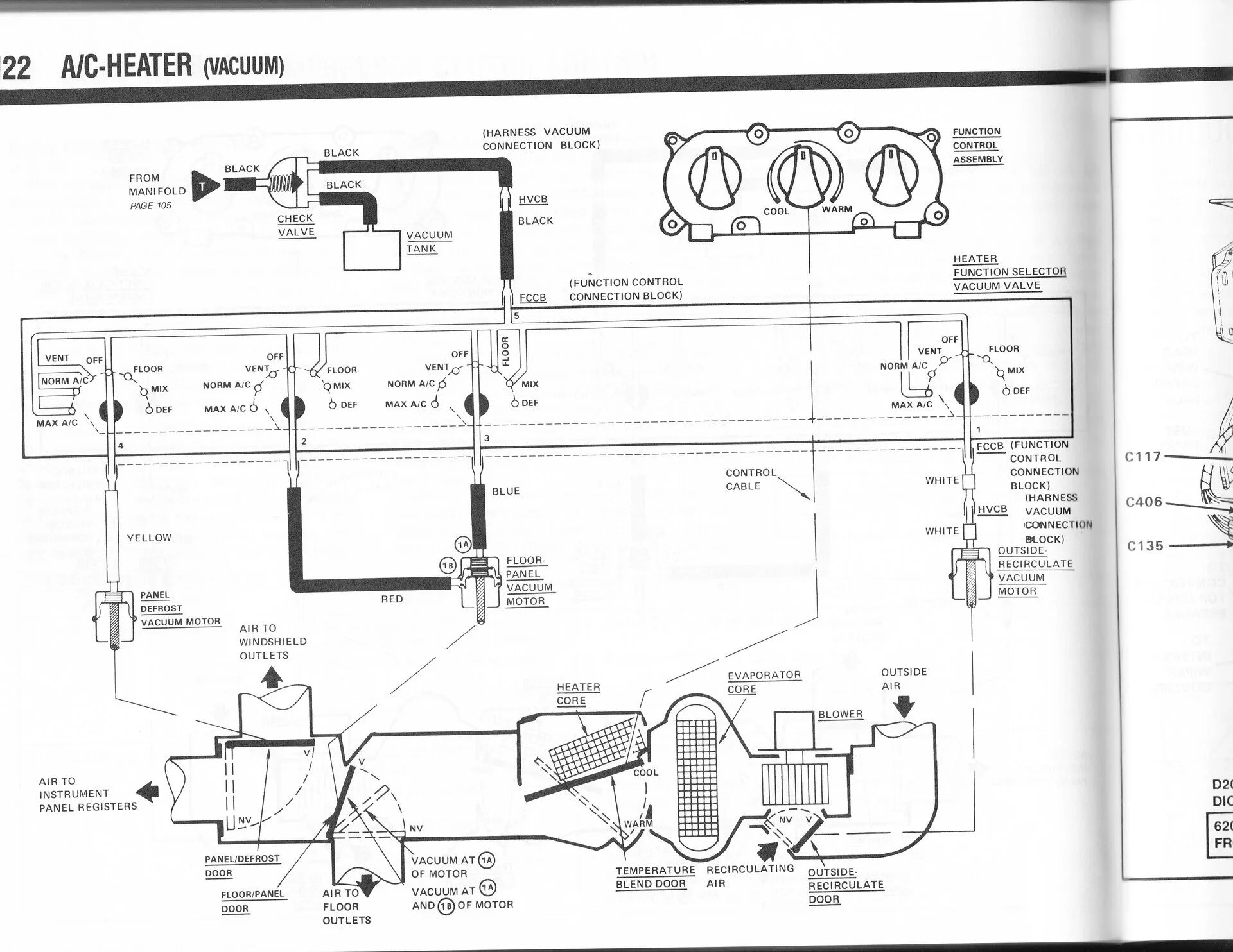

The A/C control system uses engine vacuum to operate the flapper valves that control airflow to heater and A/C.
You get to look for a broken or disconnected vacuum line in the passenger compartment or under the hood. Start with the passenger compartment first...
