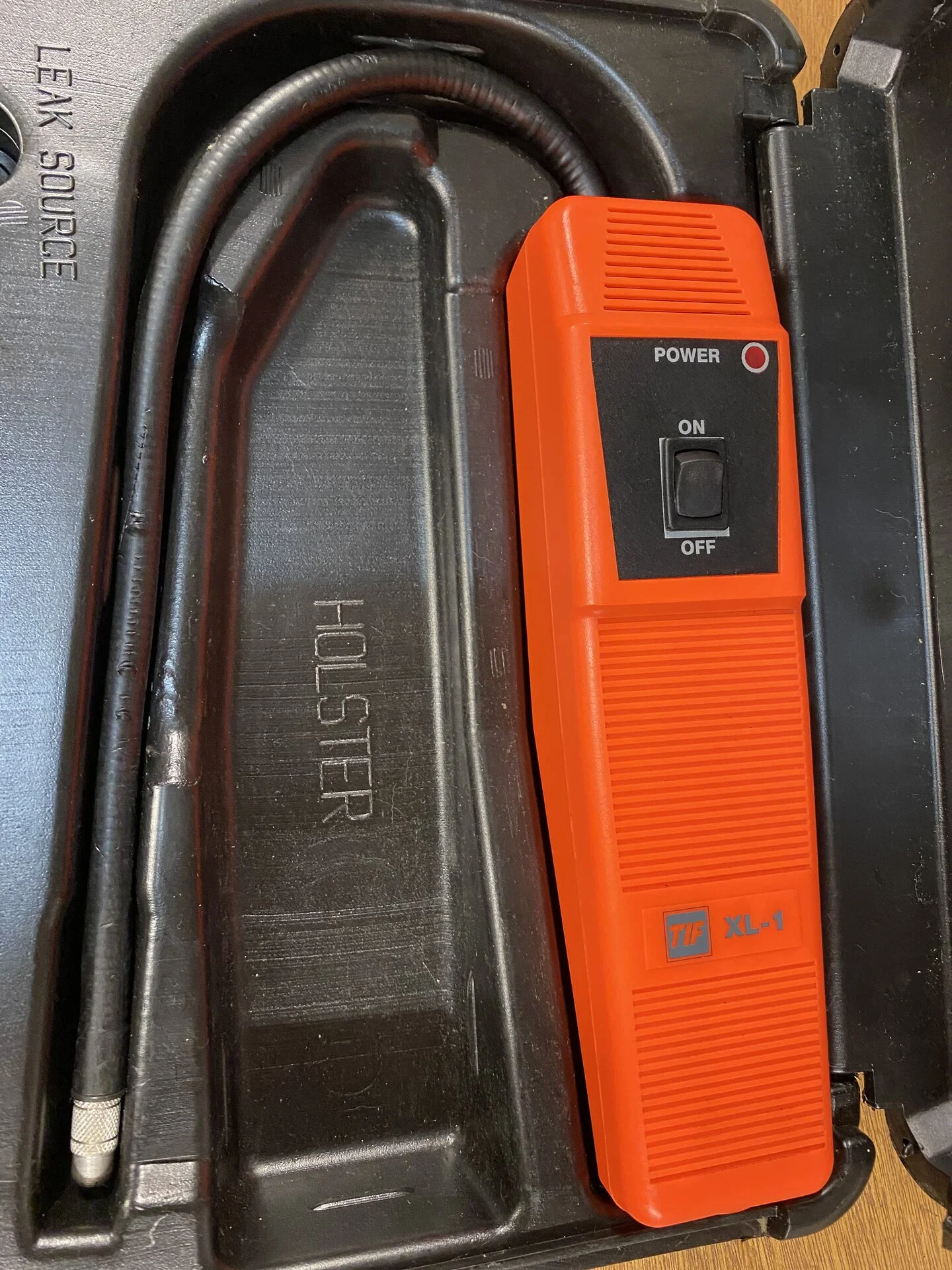

I skip the dyes and lights and go right to the Sniffer.
I used a TIF XL-1 which works quite well for R-12/R-134a and has found tiny leaks. You can get these on EBay for $50 used. It’s just much faster.
If you system is empty you can squirt a little R134 in the system (if you have converted and have compatible oil). Just enough for positive pressure. Then you can sniff around and try and detect the leak.
A very common leak point is the shaft seal on the compressor (I know you said yours is brand new) and a clue might be oil residue on the snout of the compressor under the clutch area. This area leaks with r12, so it definitely will leak with the smaller 134a molecule. The sniffer does a good job here.
