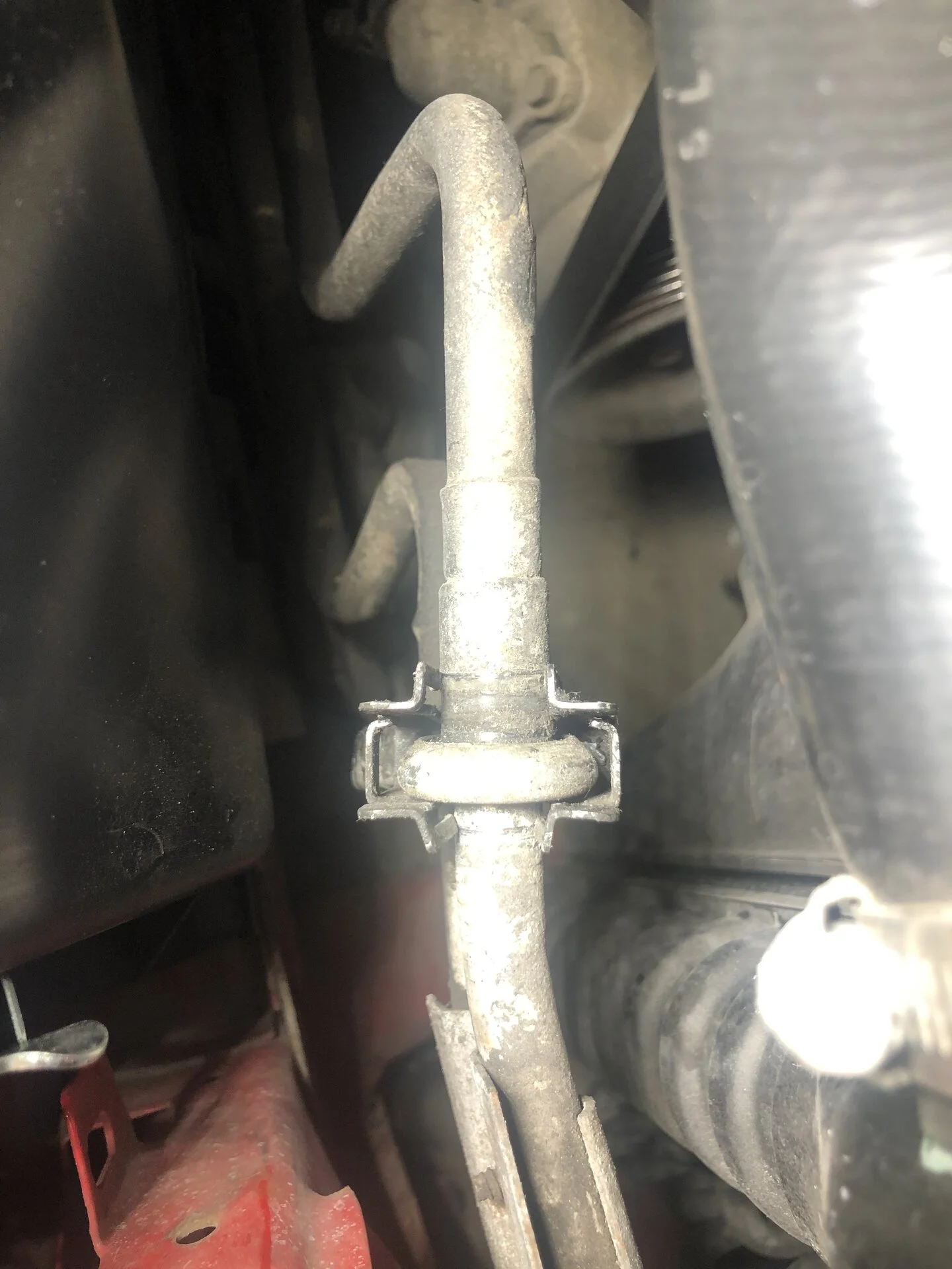

Here is the clip, I was able to nudge it off with a screwdriver. But the next question is, how do I properly unattach the line from the condenser?

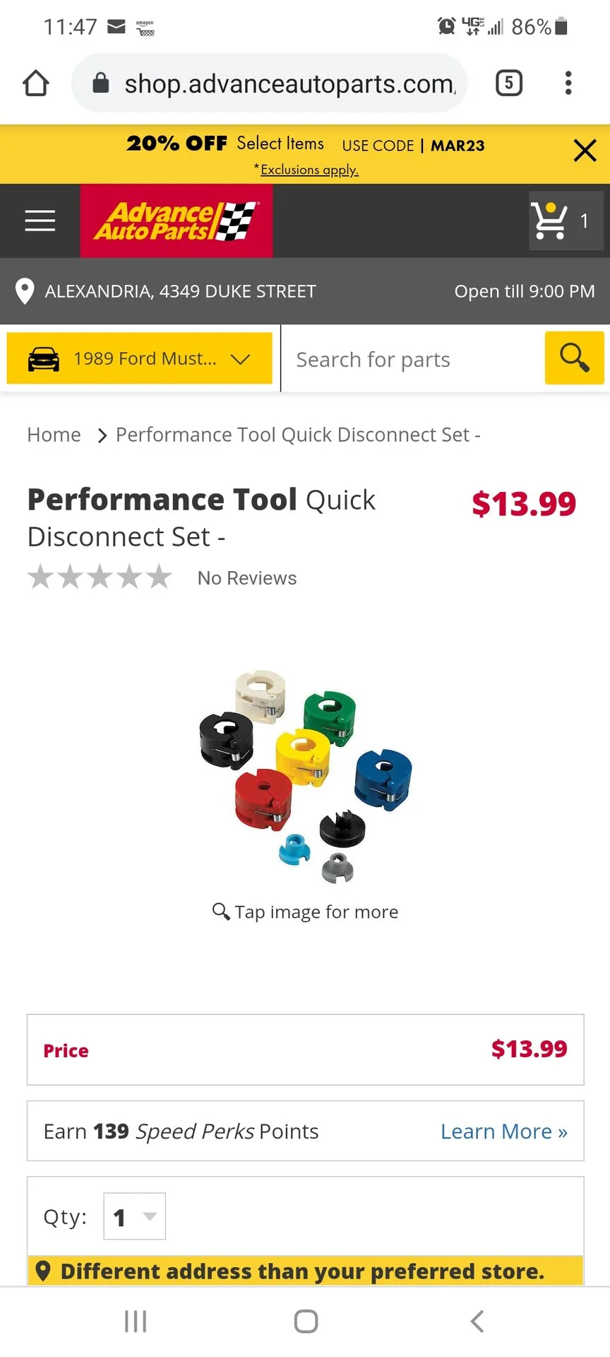

First make sure all the freon is out. Then use one if these.
These are like clam shells. They wrap around the line. There's a lip on the inside that slides inside the round flange and unlocks them. Very useful on fuel lines too. This style is way easier to work with. A little wd40 or oil on the line helps too. Push it in and twist back and forth while pulling the lines apart.
