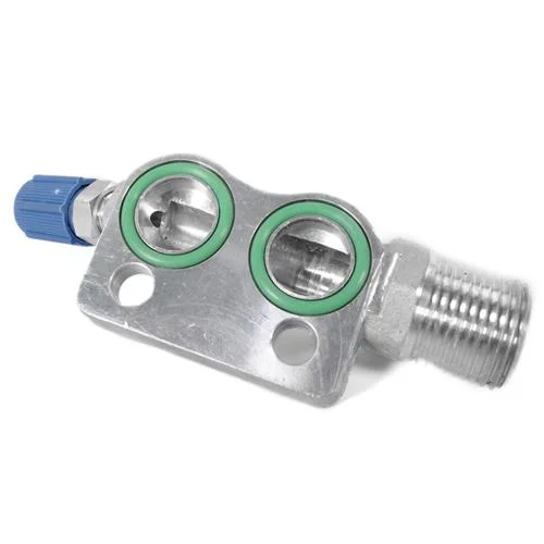

Should I buy this https://lmr.com/item/LRS-6888747/Mustang-A-C-Manifold-Service-Attachment-Charging-Port-79-93 as well or just a new pressure relief valve?
https://lmr.com/item/LRS-6888748/Mustang-A-C-Manifold-Service-Pressure-Release-Valve
And this ?

Fitment Note
If the factory accumulator and compressor hose is utilized, this service port does not have the same half-moon shape inside. To correctly utilize this new service port, you must purchase a new A/C Accumulator & Compressor Hose.
would not having the proper acumulator cause
A/C Manifold Service Attachment w/ Charging Port to pop????

Fitment Note
No. That half-moon feature just allows the hose to rotate a little so when you tighten it down, it needs to be clocked in the right orientation.
The little half-moon feature just locked this feature in place. Without it you can spin it up or down slightly before you tighten the fitting up. Once tight it doesn't move
Should I just buy this kit and get it installed and charged up?
Or just a new orifice line and accumulator line with new high side and low side pressure ports ? and a new Motorcraft clutch cycling switch? got to have my A/C working.
