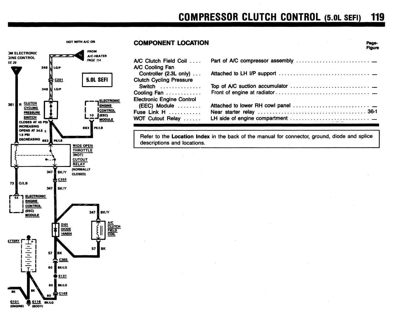

Noobz347 said:
Your [clutch cycling pressure switch] may be bad or intermittent (if it's shooting out of the relief valve):
Closes at 45 psi and reopens at 24.5 +/- 1.5 psi
V8 Foxes don't cycle the clutch. That is the low pressure cut off switch. It is there to protect the compressor from operating with not enough refrigerant in the system to move oil into the compressor. If your compressor is cycling, it's low on freon.
What if the compressor does not cycle at all ? Out of freon? Compressor cooked?
If you jump out the low pressure cutoff, and the clutch doesn't engage it's likely electrical. Either the circuit of the compressor clutch itself. You'd have to check the wiring.
A properly charged system shouldn't cycle under most ambient conditions. Ambient temp has a huge role in system pressures and most situations where you run your AC should keep the low side pressure up high enough to prevent any cycling.
The only time the system may potentially cycle is if being used in cooler temps. Defrost for example on a 45-50 degree day. In this situation system pressures will be lower and the low side may dip under the min pressure to set off the low-pressure cutoff switch. This is exacerbated by the fact that many folks don't adjust the low pressure cutoff when they convert to R-134a and leave it at 25psi.

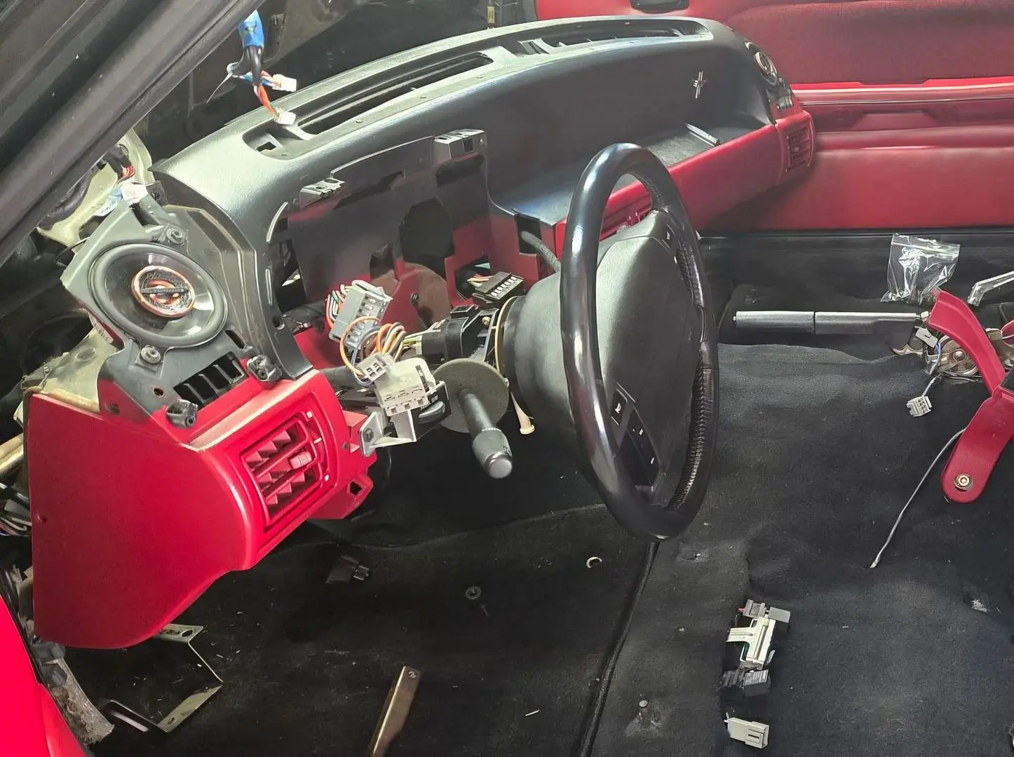

^ yup. Thats how you do it. I used the same tool to cut mine. It works great. A Dremel or small cut off wheel would work too. The vibratory saw is super handy for lots of stuff. I use it all the time. The dash will basically be ready to pull out of the car, but it doesn't have to be physically removed. Just like his video. As long as it's floppy and loose and you can easily pull it back far enough to get the plenum out you're good to go.
Most people try and skip steps like the guage cluster connectors and stuff and then break in the effort to save time lol.
Its like getting a boy scout merit badge!
Heres mine:
